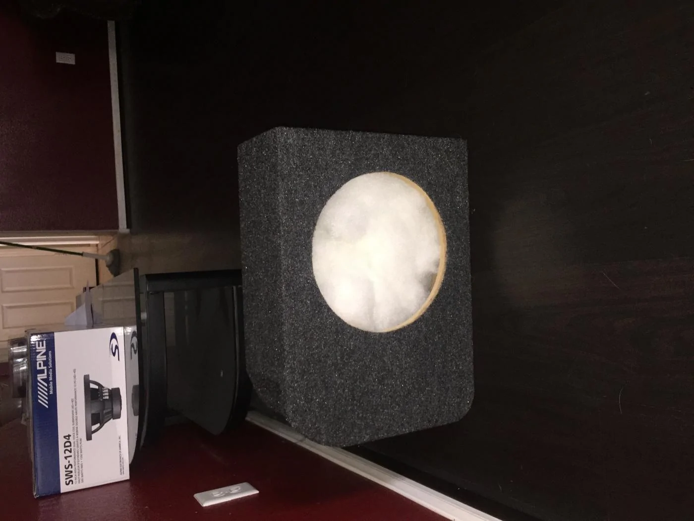

Box came in!! Very high quality and they shipped it so nicely! I'm not sure whether I want to put the polyfill in it or not though
