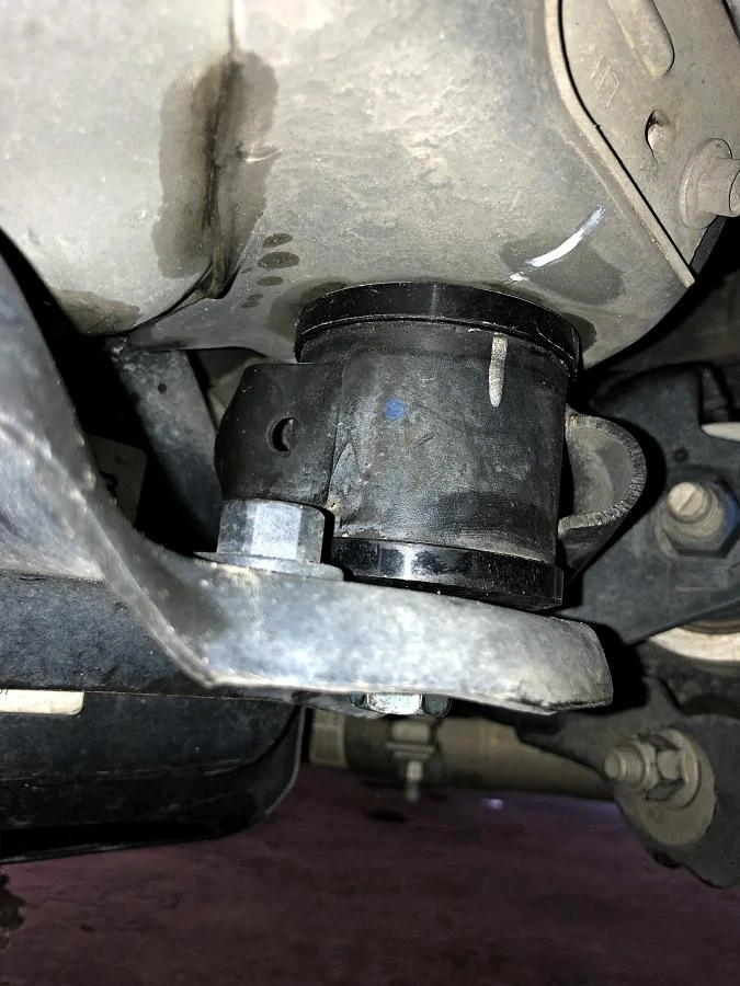

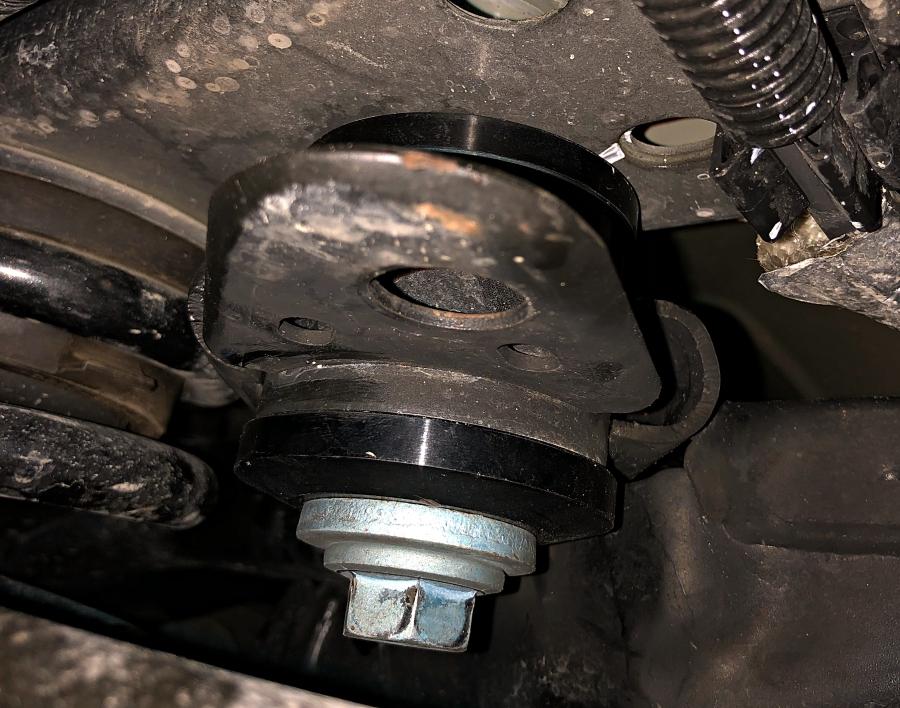

Today, I had the aluminium bushings installed. All I can say I am glad I did . I did some limited driving in the rainy town and there is no noise increase as it is often predicted on-line. Car is firm , but not obnoxiously bumpy. I love it so far. Once again I didn't touch the differential bushings and most likely will not ( in the foreseen future).
As of this moment no drama, no horror stories, just a joy and solid rear end. When the weather permits I will take it on the highway and local mountain roads to give you some more info.
Once again , thank you everyone for the input and sharing.
Cheers
Martin

Which kit did you go with?
Initially I wanted to install the set from Ford Motosport , but since they were discontinued and the prices are still relatively high for 4 pieces of aluminum, so I was able to find these , basically a Chinese copy of M-5872. Black ionized aluminium.
Interesting so the poly lip gets cut over time? Guessing it's the side between the frame and subframe.
In for more results on the aluminum bushing and your nvh perception. I planned to leave the diff alone and just do poly subframe bushings but seems there is good reason to go to the more solid bushing. Nvh is a concern for me though.
That is correct, Kelly said, that even the Delrin is cracking under heavy loads.
