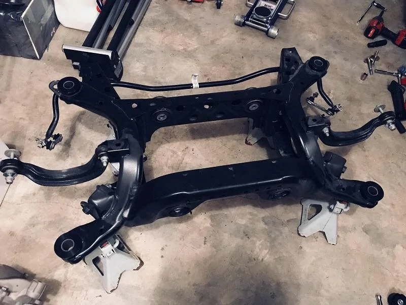

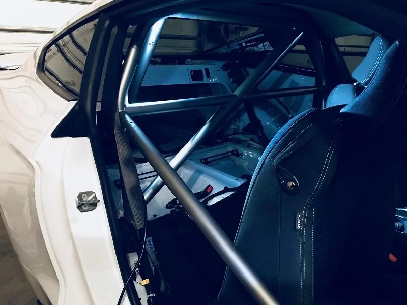

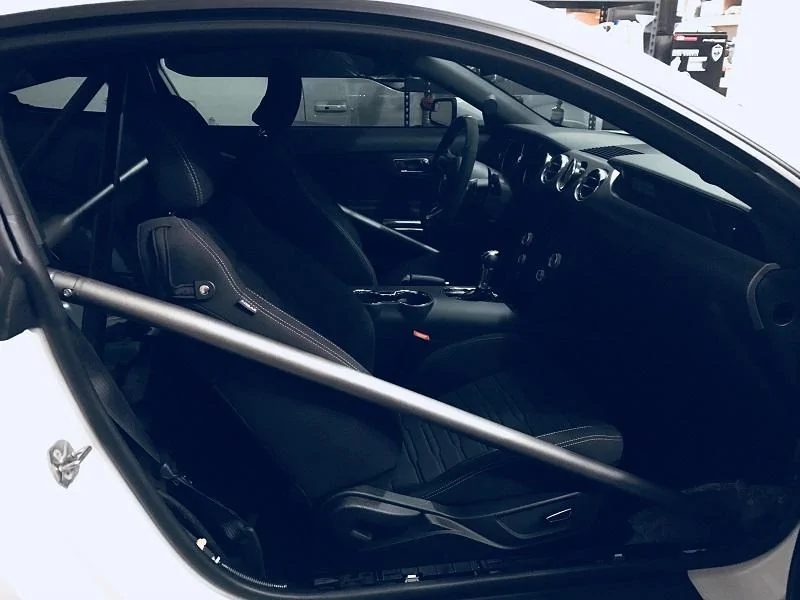

This is mostly about balancing current needs and future plans. I realize most of this is overkill at current power levels (still crazy we can talk like that about 800whp), but someday car will have built motor and who knows how much more boost. Once I get done with my current list, I think the cradle-to-body bushings will be the only rubber left in the IRS. If I didn't already have the CB005 it would be a no brainer to go solid, but as most have suggested I'll stick with the lockout kit for now.
The only reason I mentioned NVH at all is because this is still very much a street car. NVH not a "concern" as it is obviously a purpose built car and can be tolerated, but it's part of the conversation.
Couple of current status pics:
Stripped Cradle
Fitting Watson Roll Bar
