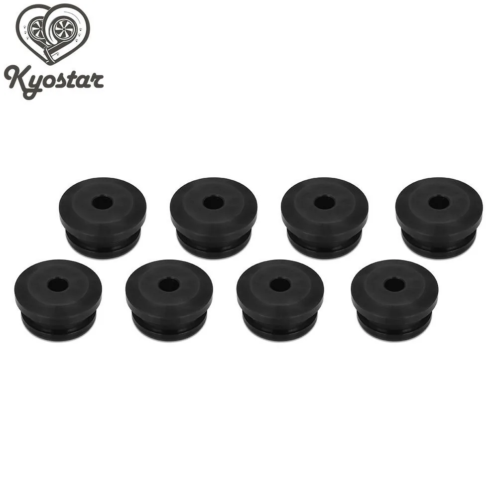

Initially I wanted to install the set from Ford Motosport , but since they were discontinued and the prices are still relatively high for 4 pieces of aluminum, so I was able to find these , basically a Chinese copy of M-5872. Black ionized aluminium.

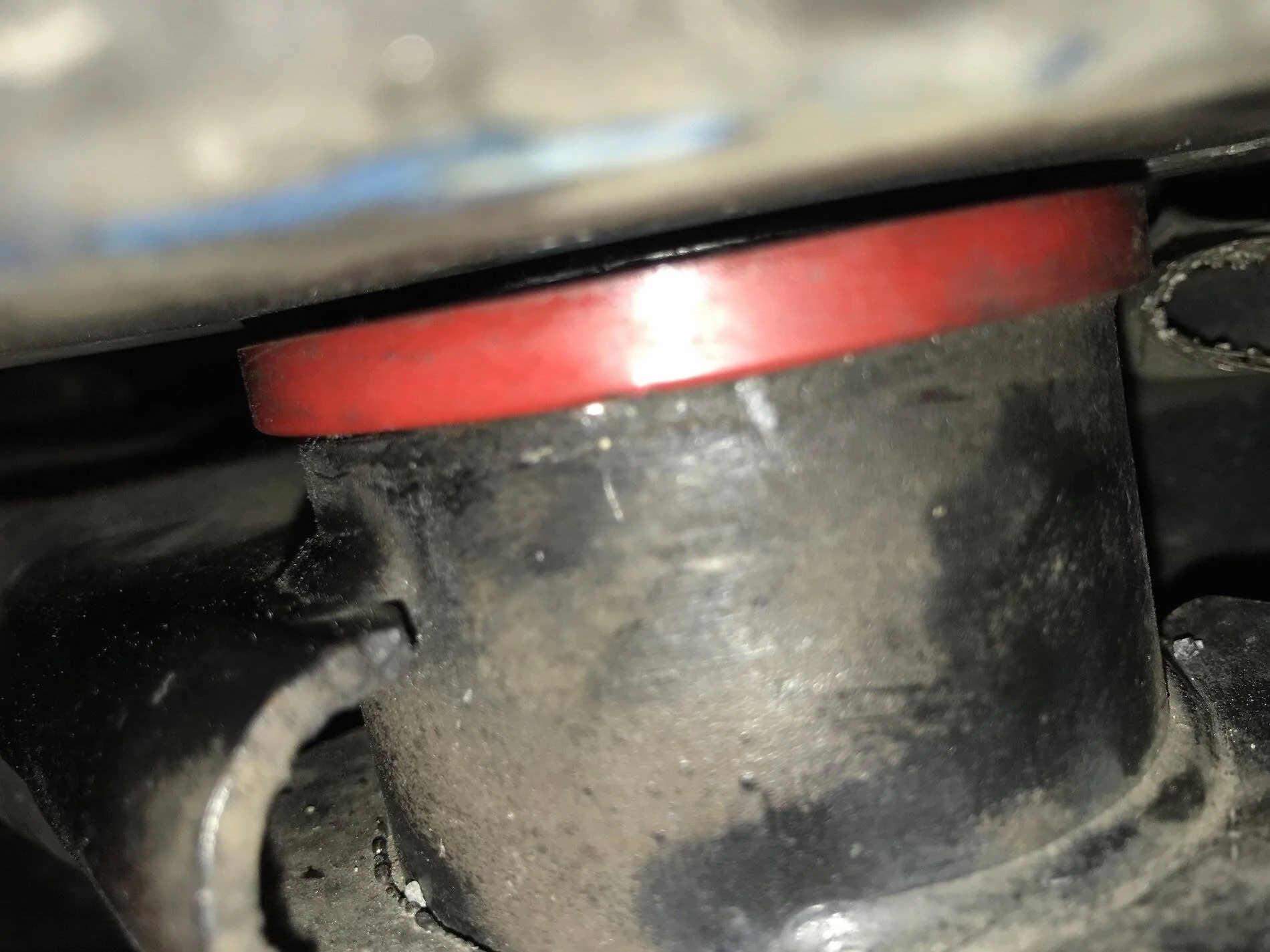

I’m in the car again and just noticed something interesting. It seems that the rear is slightly lifted, which makes sense due the thicker upper lip of the new bushings.

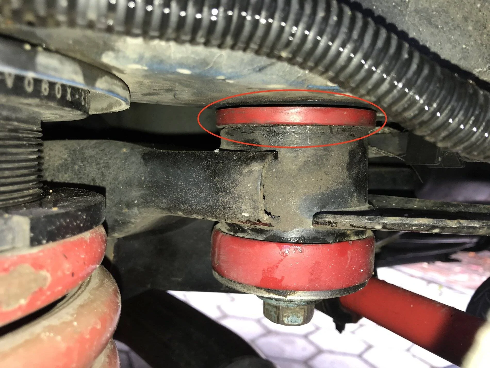

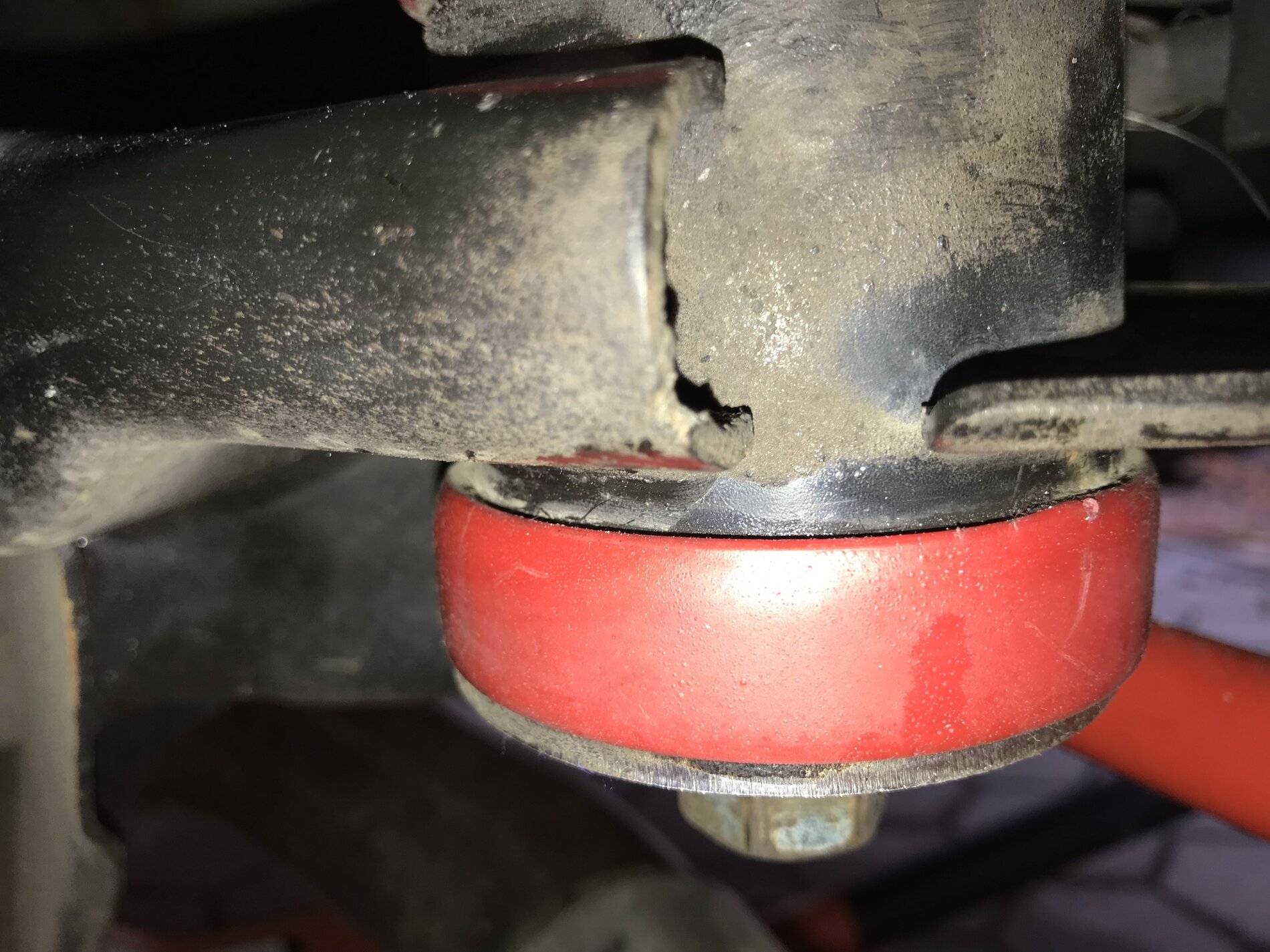

If anybody is curious how it looks when the subframe cuts into the bushing.....here you go

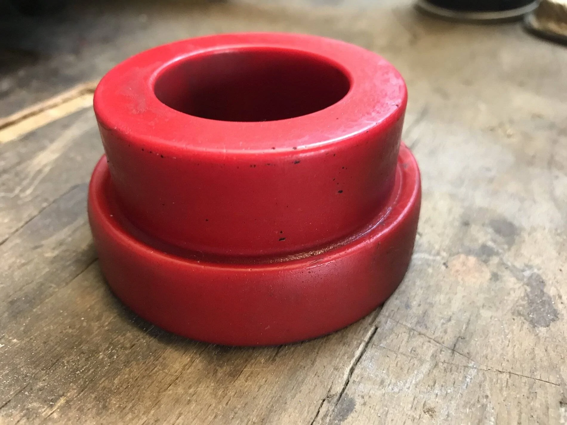

Bringing this up from the dead, all the pictures I see of the energy suspension cradle bushings do they have a metal lip around the flange as shown in the pitcures online can anyone confirm?
