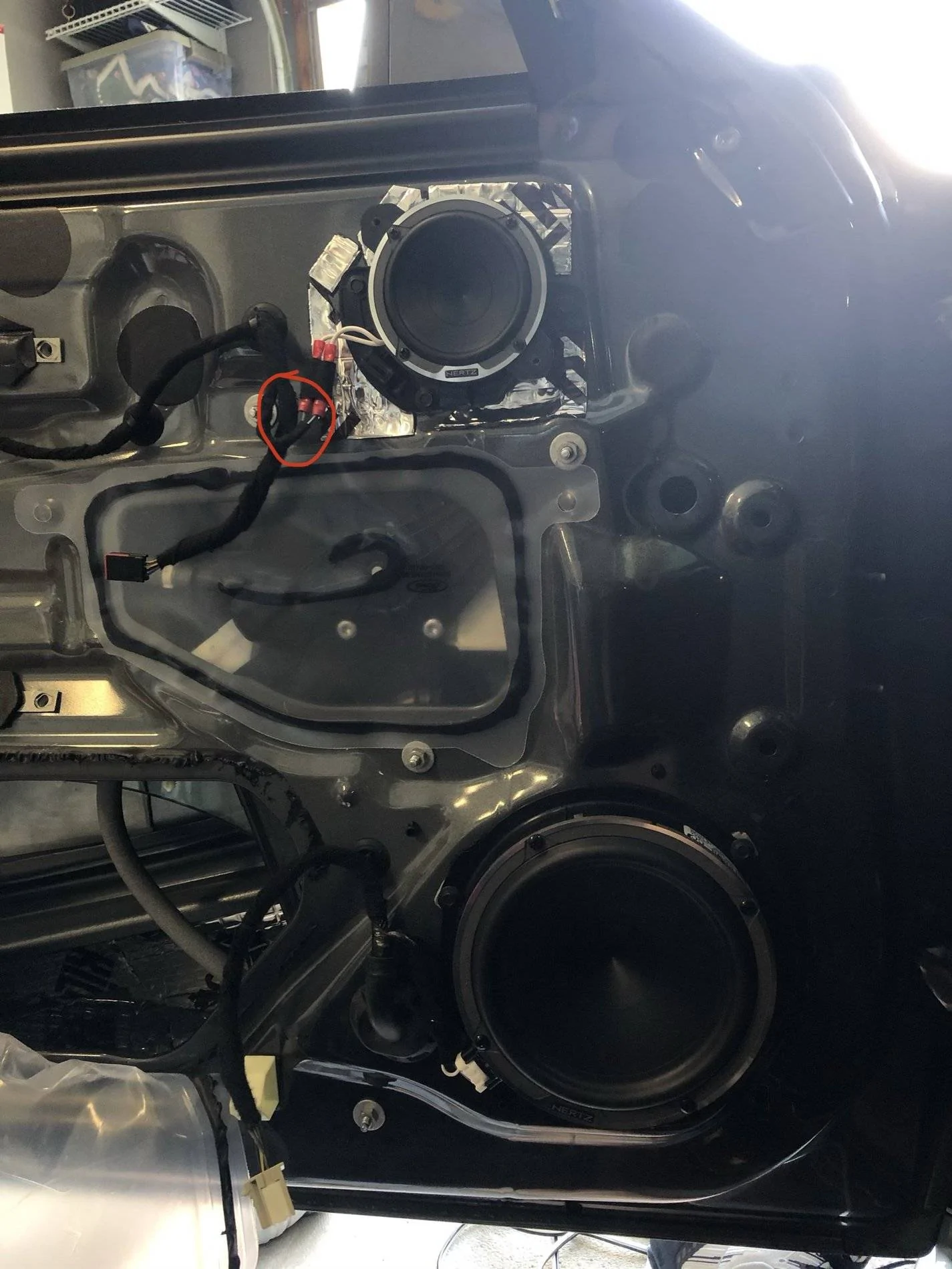

Hello, I have a 17 GT with the base audio. Tweeters in the a pillars, one set of speakers in the doors and speakers in the deck lid. I plan to purchases used door panels hat have he hole for he 3 inch speakers in the panel. I know the hole for the speaker is already in the door but i dont know if the wiring is there. If i is can how can i find it, if it is not what is it like pulling the wires into the door. I know there is a plug on the door and what i have had to do in the past is drill a hole through the plug in order to pull a wire through. When i have done that it is because i needed a 14 ga wire instead of the factory 18 or 20 ga. On this install i will just need an 18 ga to power the 3 inch second door speaker.

In the premium cars with Shaker systems, the 3” door speakers and the a-pillar tweeters are wired together. You should be able to tell if the wires for the 3” speakers are there when you pull the door panels off. There will be a wire harness right near the hole.

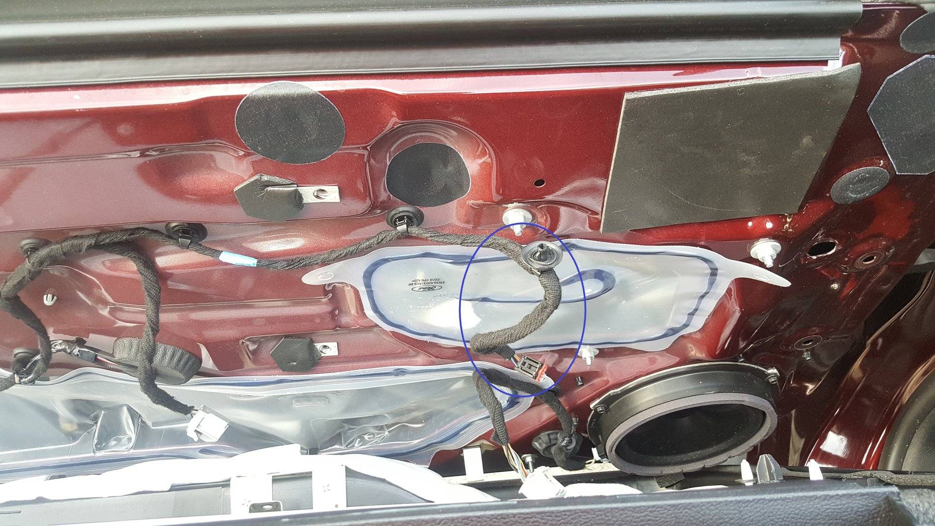

I was dissappointed, but not surprised today, to find that the mid range speaker pig tail does not exist on my base 2018 wiring harness. See the Blue Oval.
I followed the wire back and also pulled up the vapor barriers and a bunch of the thin black tape covering holes to see if there was a pigtail hanging somewhere but no such luck.

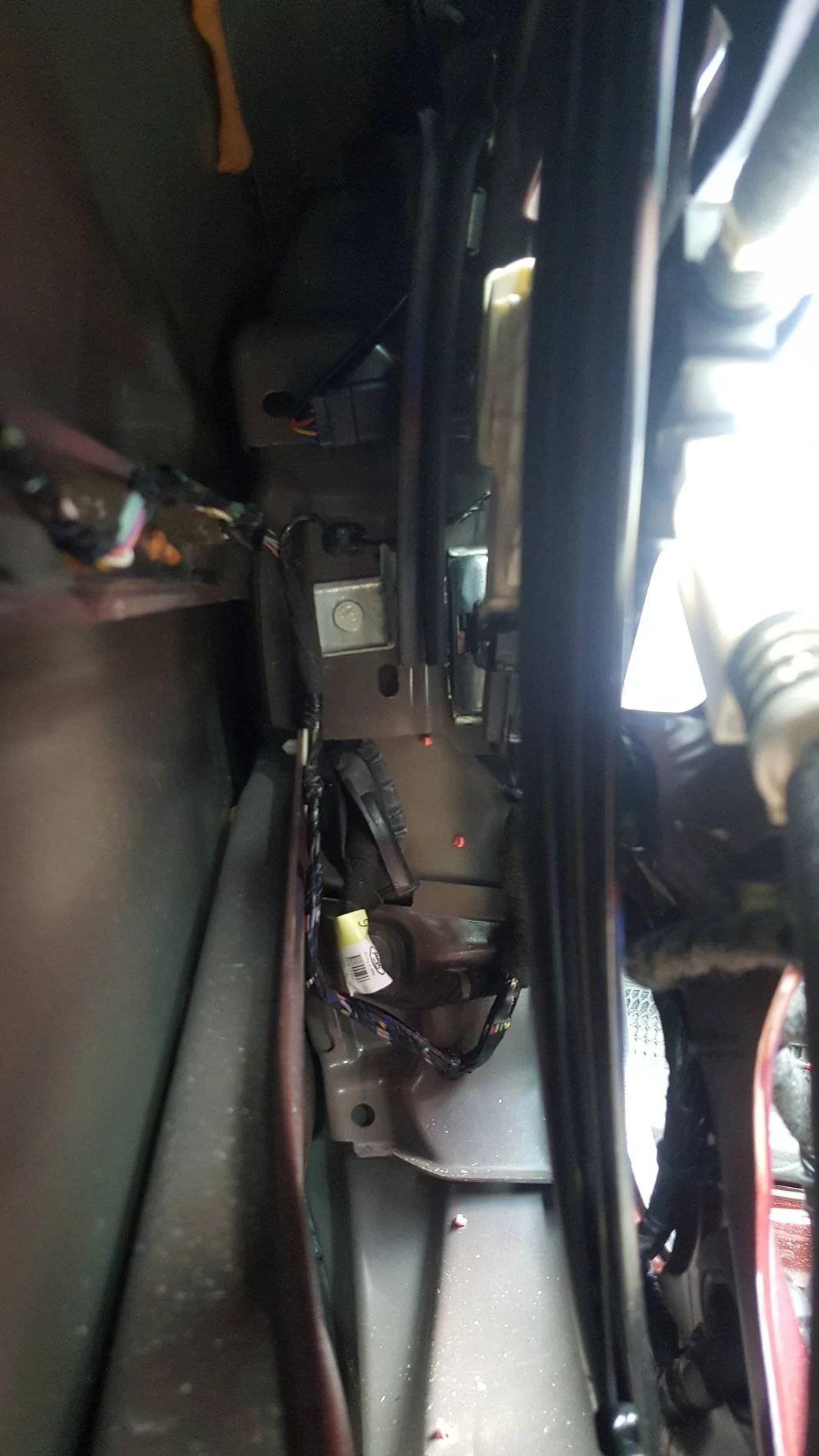

Now I need to decide if I want to go through the hastle of pulling a wire all the way through or since it doesn't exist, I may be able to use the open pins on the connector to land my own wire with the proper pins. I have the factory manual and already had all the wires identified, I just need to pull the boot and see how hard it is to remove the connector and if there's enough slack to pull it out and get behind it.
This picture makes me believe there isn't and I'm am a large guy and doubt I can get my arms far enough in.

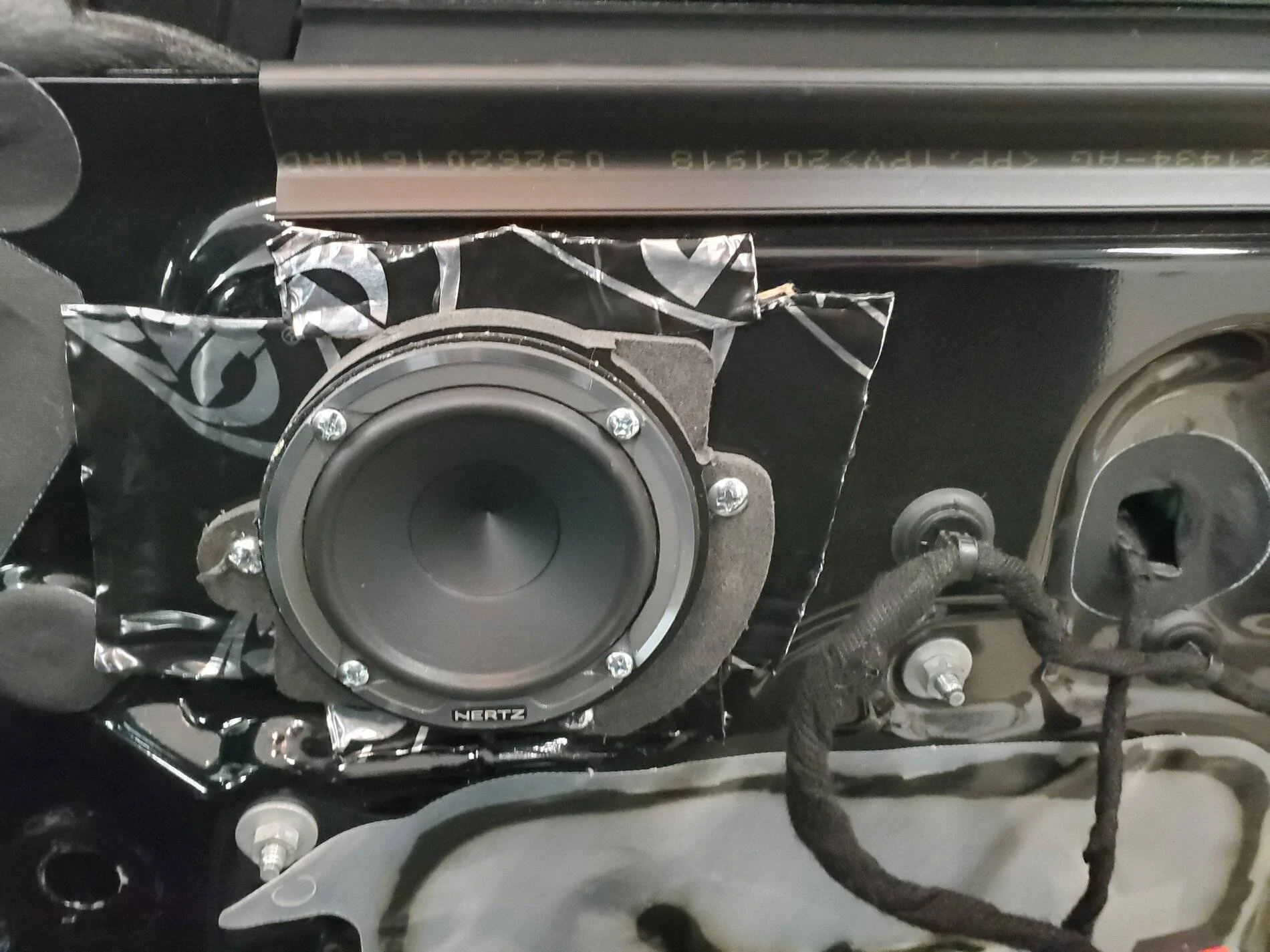

This is what I am doing and I am not done yet. Speakers are not here yet. I ordered a hertz three way component set.
The wire for the mid hi is not in the door. What I did is the same thing I have done in other cars but this one has a little less space. I drilled a hole through the plug. I was only able to get enough room to get 18 ga through the plug.
I am going to have to custom mount speaker brackets for the mid high too. I am just waiting for the speakers to get here before I do that.

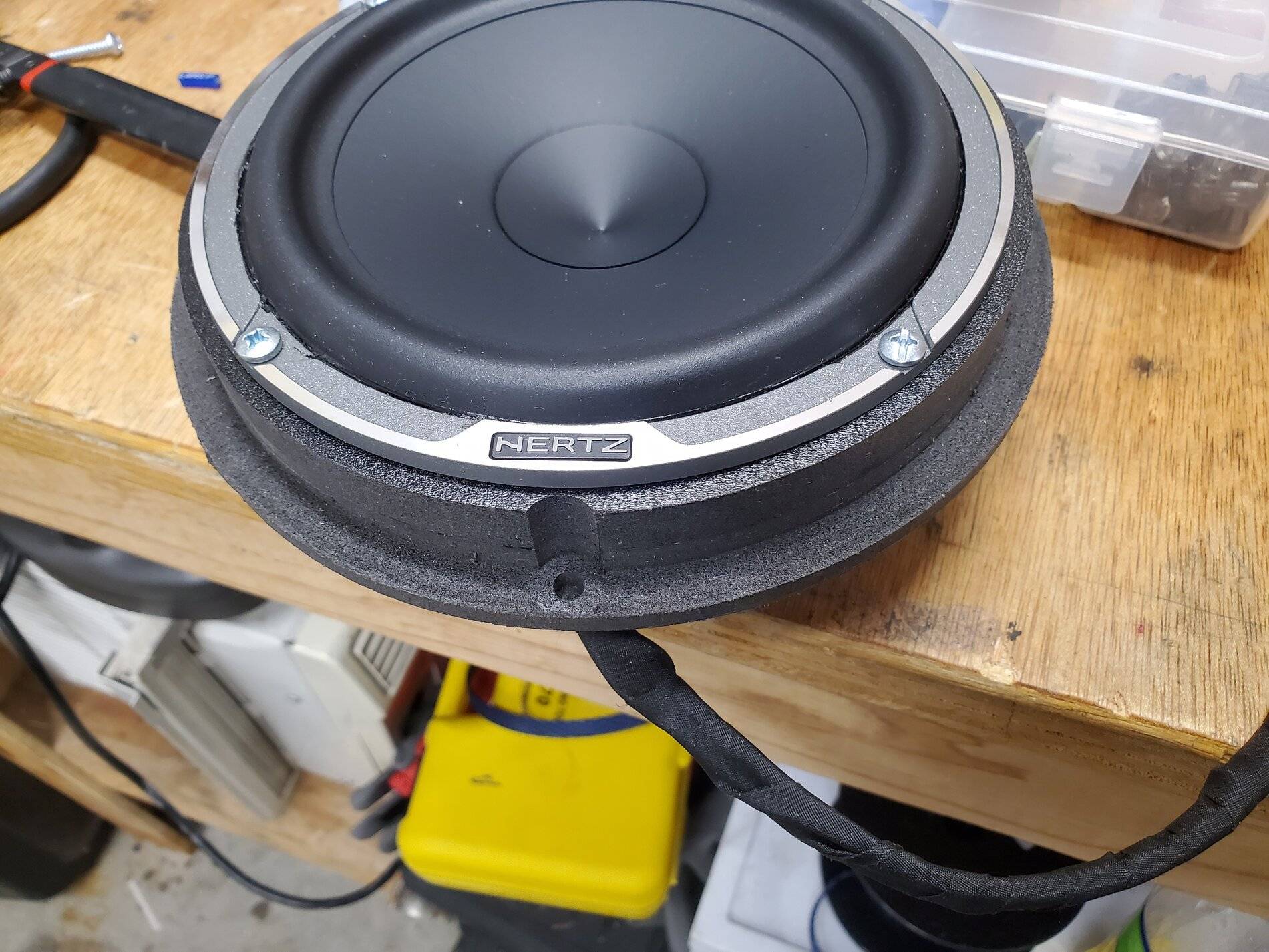

I have been waiting on a dash kit for the last few months. Door speakers installed and almost done wiring them in. I made speaker brackets out of blown pvc on my cnc. If anybody needs custom sizes cut i can do that.

I cant believe i forgot to post pictures. Thanks
The 6.5 inch ring is going to be about .7 think and the 3 inch ring is going to be about .47 thick. I can do custom hole sizes and If you know you need your ring thicker i can do that too. Ill have more pictures soon. I am going to make a set to list on ebay. I can also make something if you need it for the a pillar. If you want to keep the stock tweeter grill and need something to glue your tweeter in.

Wow, those are nice! That midrange ring is going to sell, guaranteed. It's relatively easy to make the midbass ring, but damn near impossible to make the mid ring by hand. I'd have bought some from you myself if you had these a couple of months ago. I just went through hell and high water on my install with those mid adapters.
