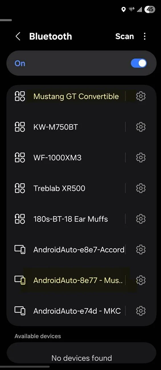

It is a two step process, first connect phone to radio via Bluetooth then you do the same to Motorola device. Once the radio sees the connection via Motorola for the first time it will prompt you to allow for Android Auto. Do so and then your pretty much done. I will say, it takes about a minute upon start up to connect wireless via AA but works well after. I use it primarily for Waze police alerts along with streaming xmradio from my main account. I also renamed all my Motorola device after setup to keep clear. If you only have one then really no big deal. See screen shot attached of my Bluetooth settings... GL

I appreciate that. I just wasn't sure why the item page and their instructions require you to have a BT 5 ghz wifi connection, as it doesn't make any sense as they are two different actual protocols. From what I read it needs to switch to BT to the car for hands free? I am absolutely fine with that as i don't use my phone in the car. I will definitely be ordering one tomorrow. Thanks for the info.

Because wireless AA uses wifi for the data transfer. It starts with BT for the initial connection, then once AA boots up it establishes a connection using wifi signal(you don't need wifi data) between the radio and the phone for the much faster data transfer than BT. It treats wifi like it's Bluetooth basically, not needing an external wifi signal. I had Sync4 in my last truck. If your phone is connected to your home wifi it will take breaking that signal before AA will take over. I found disconnecting from any other wifi source before starting AA and it'll connect a lot faster and more consistently.
