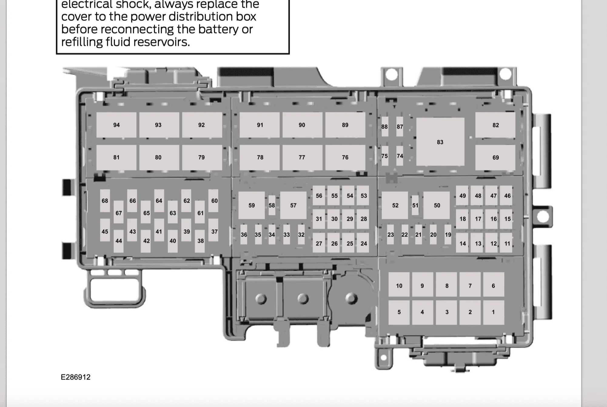

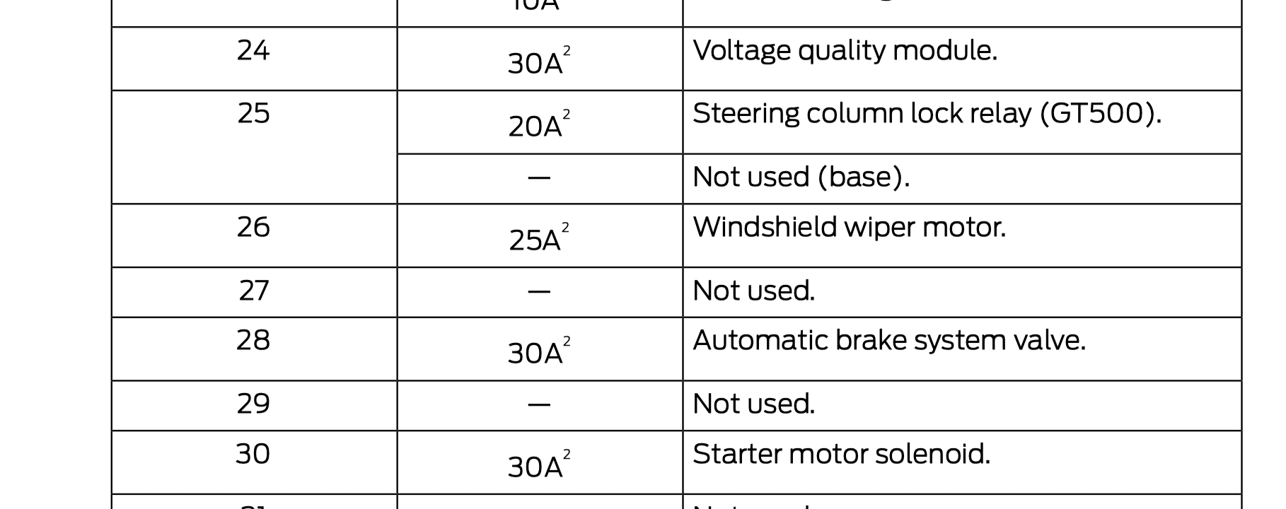

So this morning on the way to work, I had the wipers on in the rain. Rain quit, turned wipers off and they stayed on. Wtf? I guess this’ll be a trip to the dealer for warranty. But is there a fuse or relay I can pull so I’m not watching them for the hour drive home in the dry this afternoon? I don’t have my owners manual with me.
