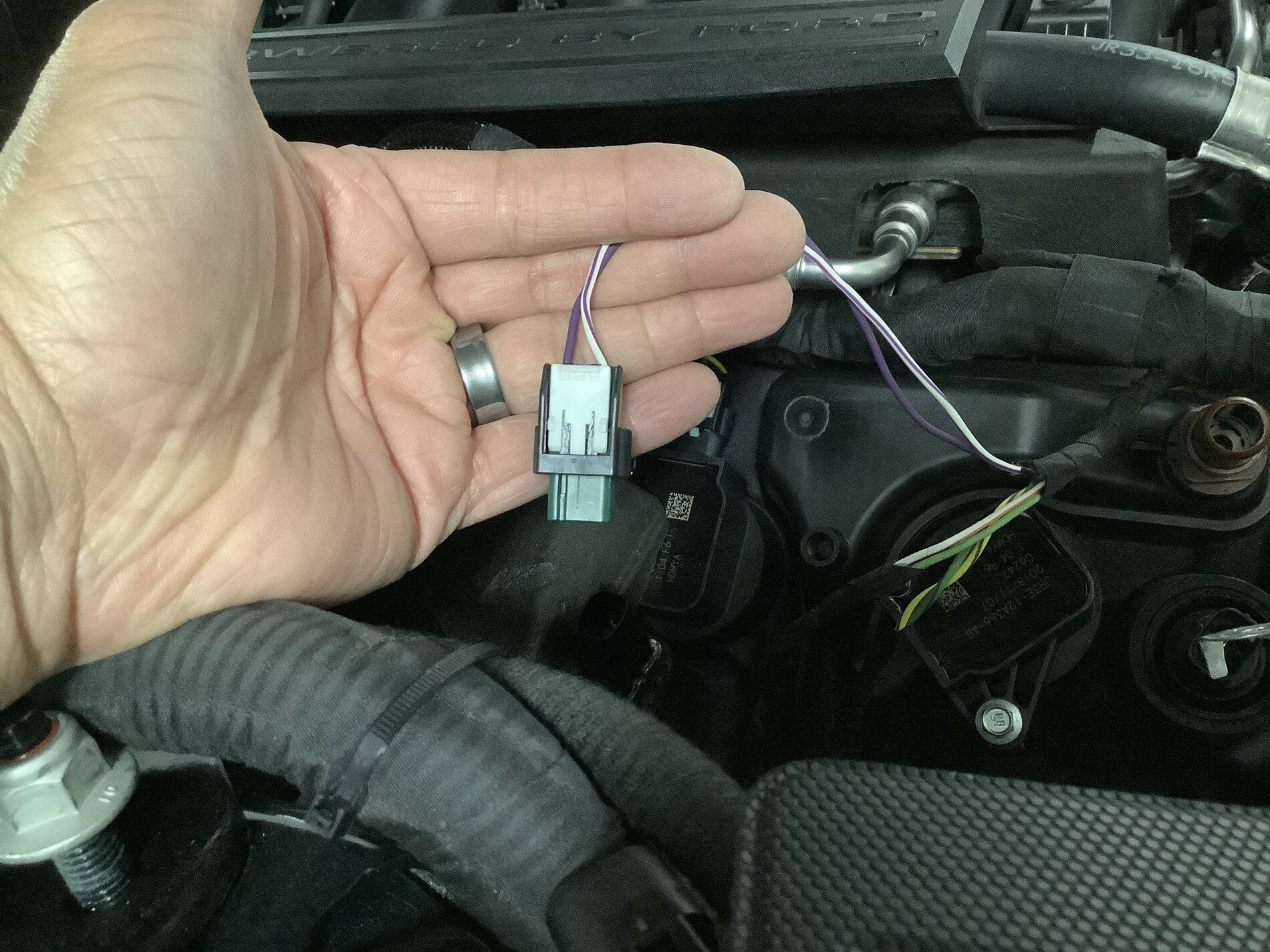

I pulled this info. from my nitrous install thread. For the rpm signal, I took mine from the #1 coil wire (white wire with purple tracer on it). See pic here.
