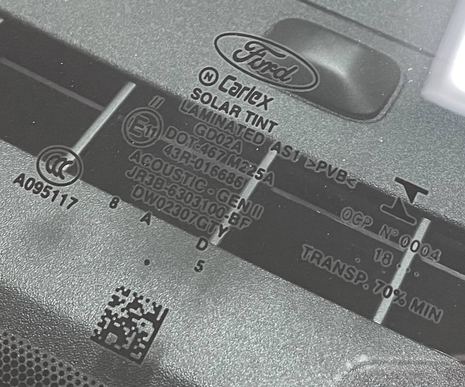

My info is at the bottom middle part of the windshield. Here's a pic.
I cannot find the SoundScreen logo anywhere.

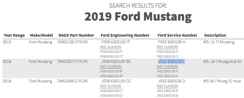

So I entered my information on the Carlex website and got this.
https://www.carlex.com/automotive-replacement-glass/part-results/
Here are the part #'s for SoundScreen windshields. So Part # JR3Z 6303100A, now C is SoundScreen even though it doesn't say it.
Stephen, check your part #. I'm betting your all good.
