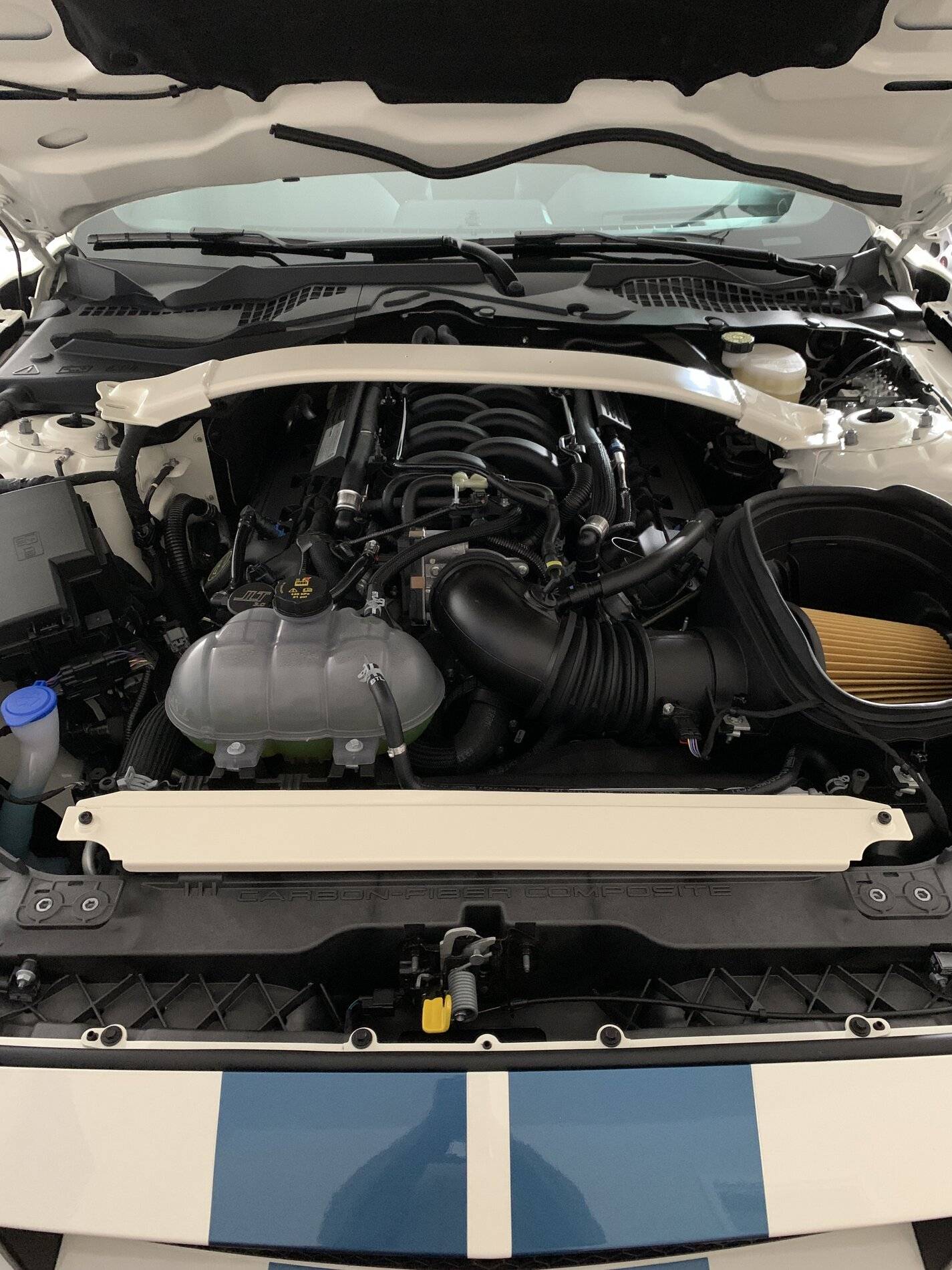

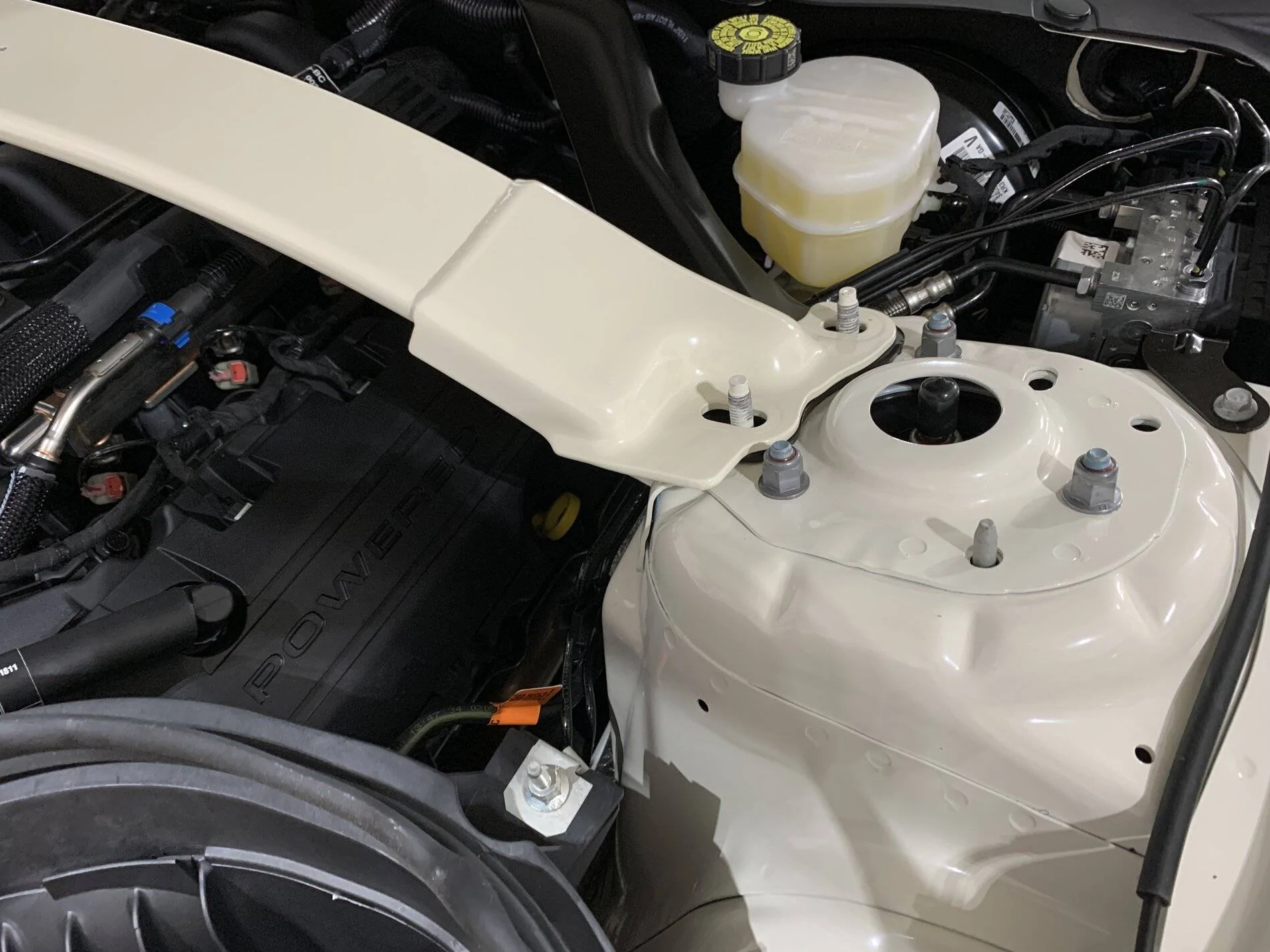

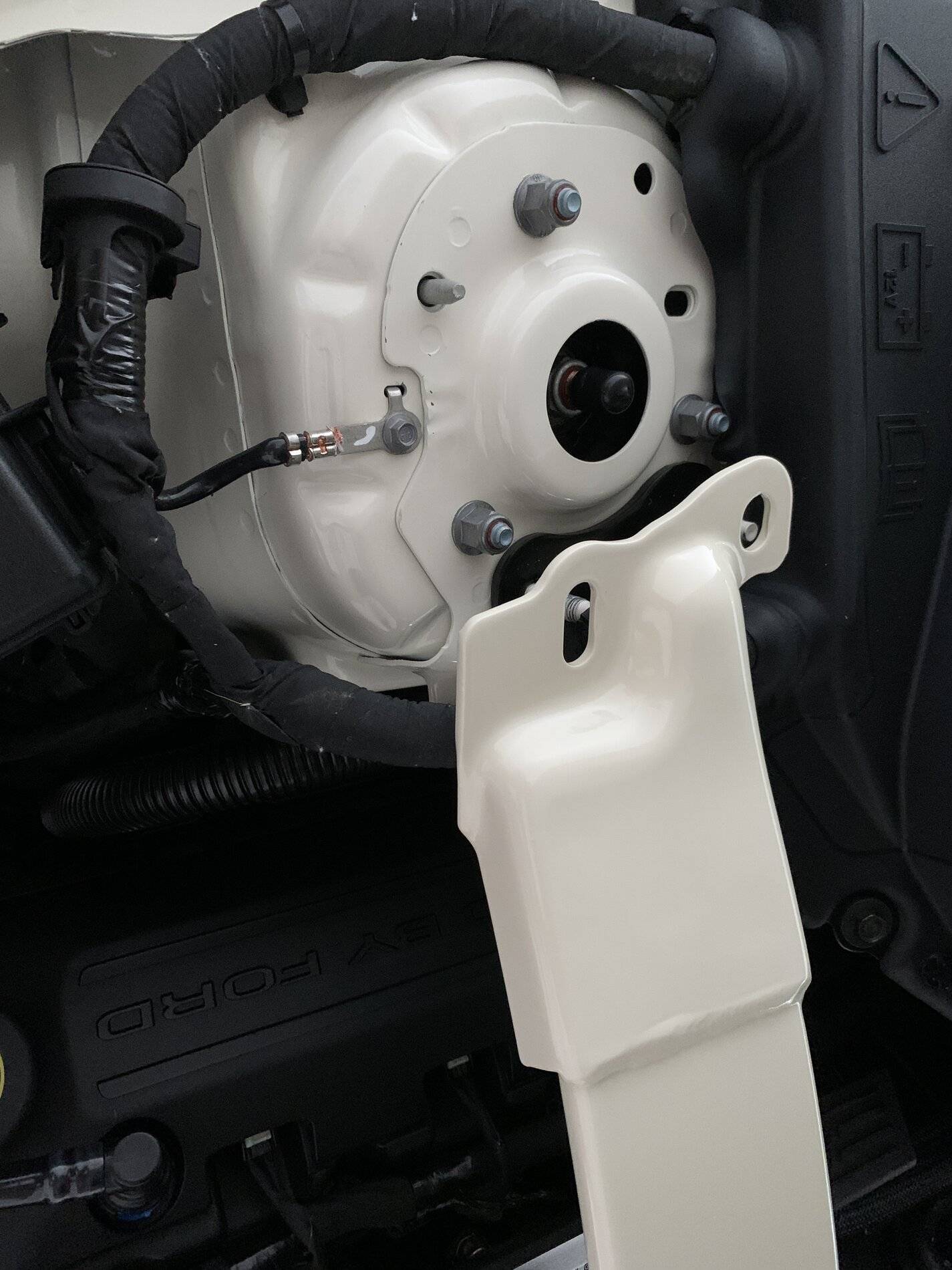

Picked up a couple pieces (strut tower and radiator support) from my local powdercoater that I had done in Wimbledon White. Since an exact powdercoat code could not be found for Wimbledon White we went through a series of sample color tags. We picked a color based on the tag and the color of the car was the closet match. After getting the pieces home yesterday I found the match is not quite as dead on as we initially thought. That being said if you look at it in a certain light it looks dead on, but in another light the pieces have more of a cream color to them. I want to install them, but my OCD is telling me to find a better match or just have them painted. This leads me to my next question.
Has anyone had any parts painted Wimbledon White and/or found a Wimbledon White match code for powdercoating? If you have had parts painted and/or powder coated Wimbledon White, where did you go and would you mind sharing your POC? Any help would be appreciated. Thanks.

I have a rollbar coming from Competition Motorsports that is done in Wimbledon white. I’m curious to see how close it is, it’s powder coated. What you’re probably noticing is the difference in the application. Powder tends to stand up on the surface where a sprayed application lays down much flatter. That’s where the difference in light really comes in to play. A previous profession for me was paint and body. I’m ocd in the same way with color.

Depends on "how much" off the color is. Pics?

Ya, OCD isn’t a good thing when it comes to this.
ITHD is absolutely right about matching powder where paint was originally used. When you start adding pearls and other special tints to paint, good luck “matching” with powder.

Are the engine bay’s paint still not clearcoated ? I remember years ago they were NOT.
That could explain the difference in shades.
