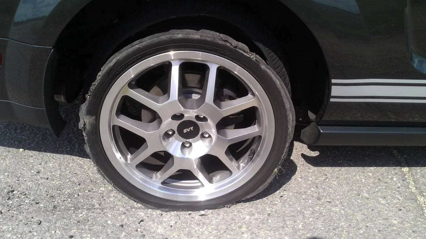

I've posted it elsewhere, but here's why I'll never run without a spare again....
Nothing sucks more than being stranded out in the middle of nowhere late on a hot Sunday afternoon for several hours because a car didn't have a f*cking spare. And no plug or can of fix-a-flat is going to do much here.
