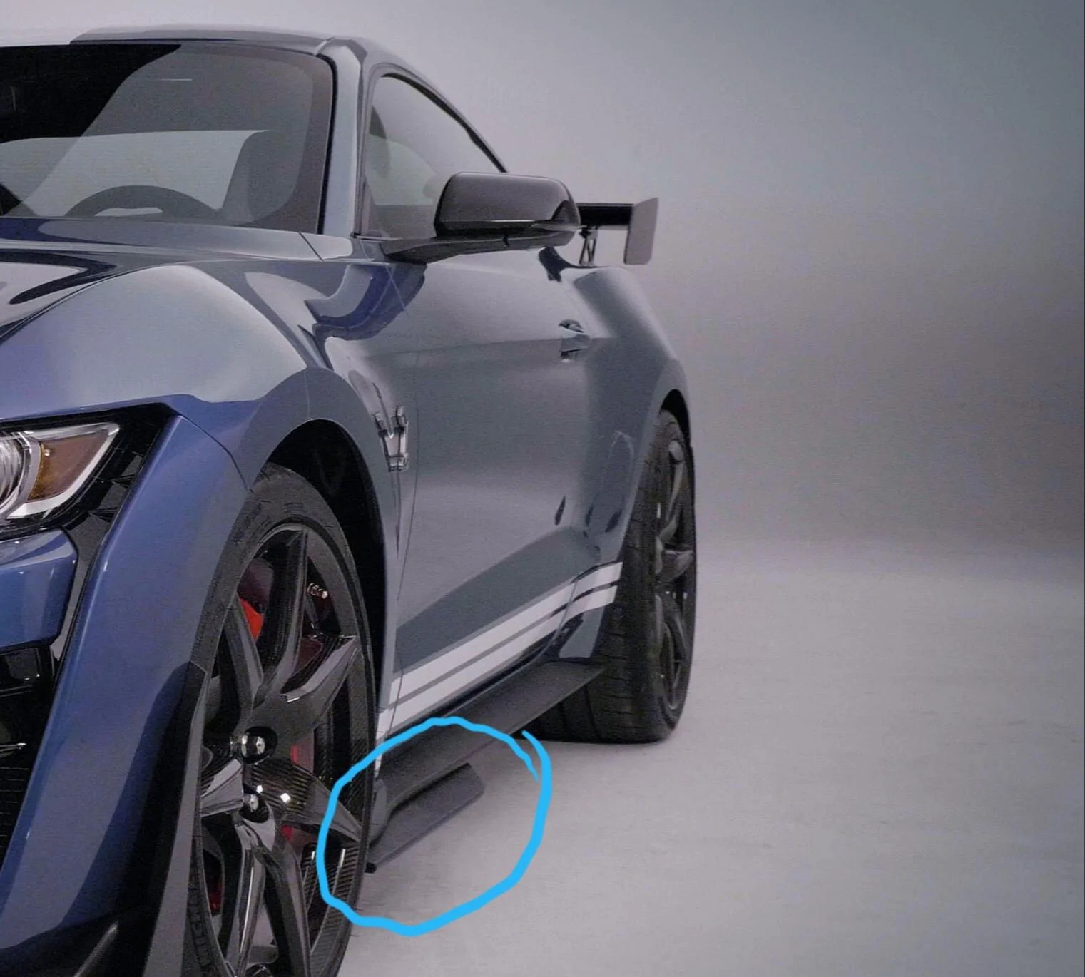

Good question. I see no reason they would nix the fender vents on the "halo" car. It definitely needs something to spice up that side profile a little. They really helped on the GT350. A bigger question I have is why they couldn't have done a little better on the side skirts. Like, what's up with that little piece at the front?

I initially thought they were intended to provide an aero benefit. I learned from someone in the program that was not the intent. Apparently Ford has a measure of control over the gravel spray or pack that can be directed at an exterior panel face, for example. Imagine that as a designer you have a choice in terms of how to mitigate the issue of silly wide tires (that some nutty vehicle dynamics engineer specified) that spew rocks with aplomb along the doors. You probably wouldn't choose a typical mudflap to take care of business. So stylists are more fond of the "surfboard" approach which is essentially a extending an area of or at the rocker panel outward to block and thus protect your fancy paint job. If you look at the most recent ZR1 you'll see something similar. In the case of the GT500, designers made the extended portions look separate when in fact they are produced with the rest of the rocker cover as one piece. These had to be evaluated by an ergonomics team to insure "proper" ingress and egress without them getting in the way. Apparently there was even consideration given at one point for these to have been adjustable - pull them outward to extend them for track events or push them back in for any other time or as you so pleased. As always, the man that controlled the money killed that idea.
