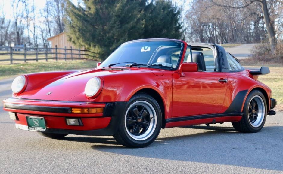

The only Porsche in the 80's with 150hp would've been a 944, a front-engine coupe. It will handle very differently than a 911, as it had nearly perfect front/rear balance.
A 911, particularly the 930 up through 1989, were named the "Widow Maker", as they required a skilled driver to reach their potential. Get ham-fisted with one, and you're backward into a wall, off a cliff, or into a ditch. A car like this needs those fat rear tires to keep the car going the right direction when you start having fun. They've tuned most of that behavior out of the current version, but in 1989, you could kill yourself in one easily.

I had a 1966 Porsche 911s. You never, ever took you foot off the gas mid-turn. If you did, it would change your line so fast it was impossible to control. That tendency is gone in the newer models. They are incredible handling and very predictable now. Which is very impressive, considering that Porsche flat 6 weighs more than a Chevy LS engine and it's hanging out past the rear wheels.
