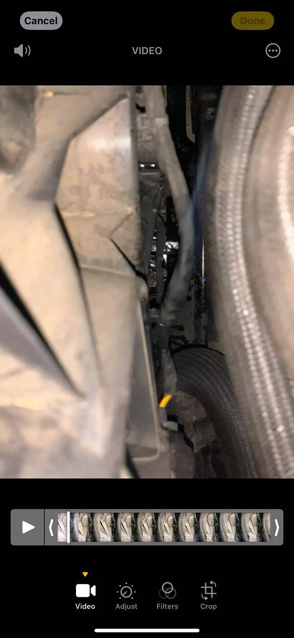

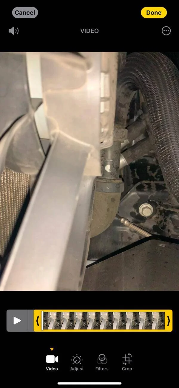

I topped off the coolant slightly above the minimum and drove home without issues; temperatures stayed consistent and I didn't notice any leaks. I inspected the water pump and found signs of dried liquid, but I'm unsure if it's from the weeping hole or splashing. I had a grinding noise at startup for a couple of months, but it has recently gone away(see video at 10sec mark). I suspect it might be a bad water pump or a coolant leak. I have an appointment with my mechanic this morning . My odometer is at 116k, and since I haven't had premature failure, I'm leaning towards an OEM water pump replacement. Also should I replace the thermostat whole it’s at it? I haven’t had any over heating issues. Any thoughts?
