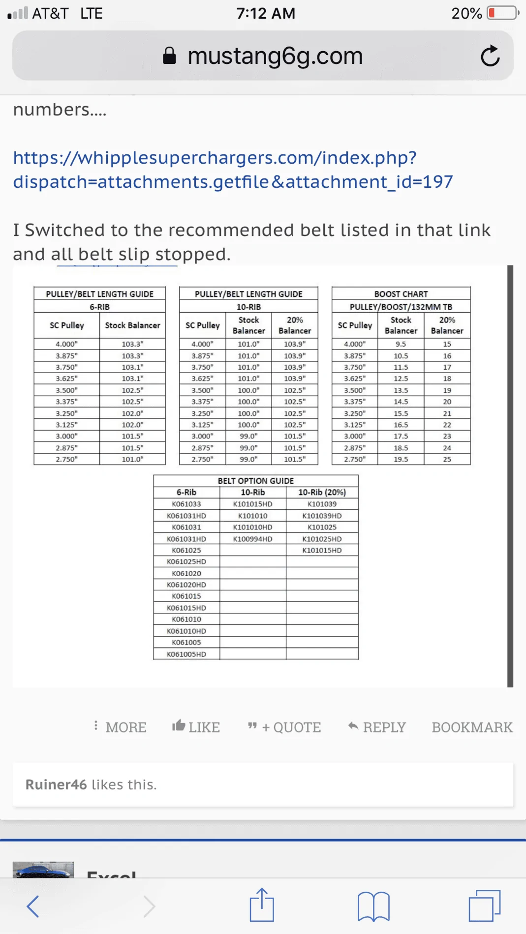

When going down from 3.625 to 3.375 is a new belt recommended or do you need to make an adjustment to the tensioner?
olaosunt
Jan 10, 2015
72
4,291
1,575
Indiana
Guard,base,M6,KB-2.DIB,auto,Hellion TT,2016 GT 350/Gen 3 Whipple ,2018 Mustang GT/Gen 5 Whipple
Yes
Whipple has a chart
