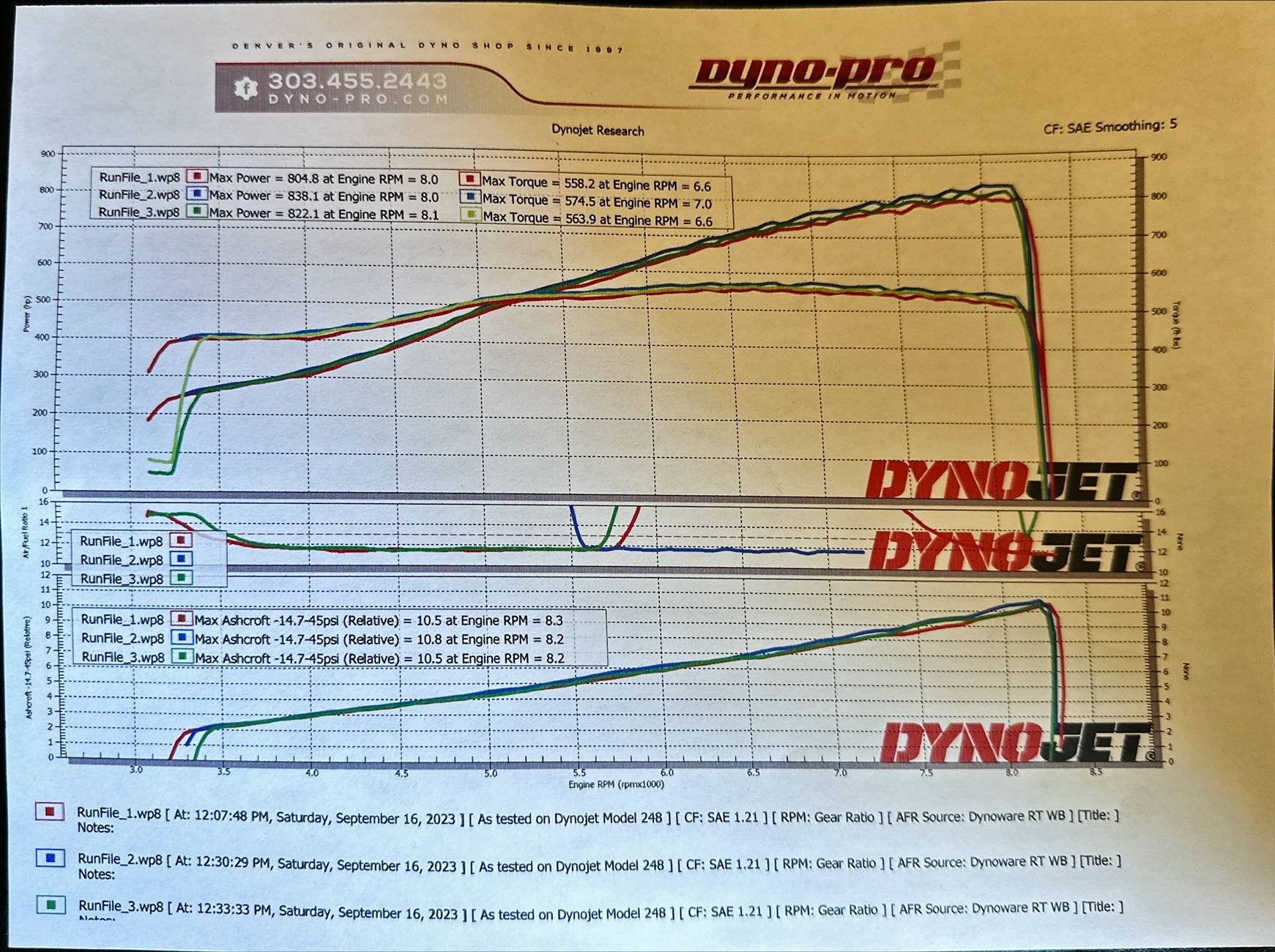

What’s the benefits (beyond strut tower brace) of centri? How’s power delivery? How’s pricing? What kind of power with how much boost? Talk to me Goose
The benefits are mostly in the cost, and ease of install, although I personally would argue that they are easier on the engine (important if your motor is stock) because of the way they build power. The power curve isn't really a curve at all, and instead a straight line to the moon. This makes torque mor manageable and doesn't load up the engine at Low RPM's like a PD does.
Now, everyone likes the feeling of torque- However torque is only as good, as can be managed at the tires. If you are running street tires, a PD blower will be harder to manage from a traction standpoint, and like they say- If you're spinnin', you aint winnin'. Of course, if you like doing smokey burnouts, and going sideways, maybe a PD is right for you.
You will see several instances of people on here claiming that they installed a Centri and aren't satisfied with the power, and having to really get the RPM's up before the rush or strong acceleration happens. This is generally a case of not pullying down enough. For a street car, you don't live at 7000 RPM, so I'm of the opinion that you should use a smaller pulley than what you actually think is needed, so that power comes on sooner, and provides more midrange torque.
Turbos are the best of both worlds. You get high end Horsepower, low end torque, and the ability to change boost on the fly with an electronic boost control solenoid. Also, turbos don't steal power to make power like belt driven power adders.
Power is subjective on any given day, on any given dyno. The attached graph was when I was on a 105mm pulley, and yes it has a correction factor of 21% to account for altitude and DA that day. Probably making right around 700 Wheel, actual at this altitude.
Any of these power adders have more than enough capability to blow up your motor. You just need to determine what the use will be ( Street car, drag racing, taking out crowds at cars n' coffee etc)
