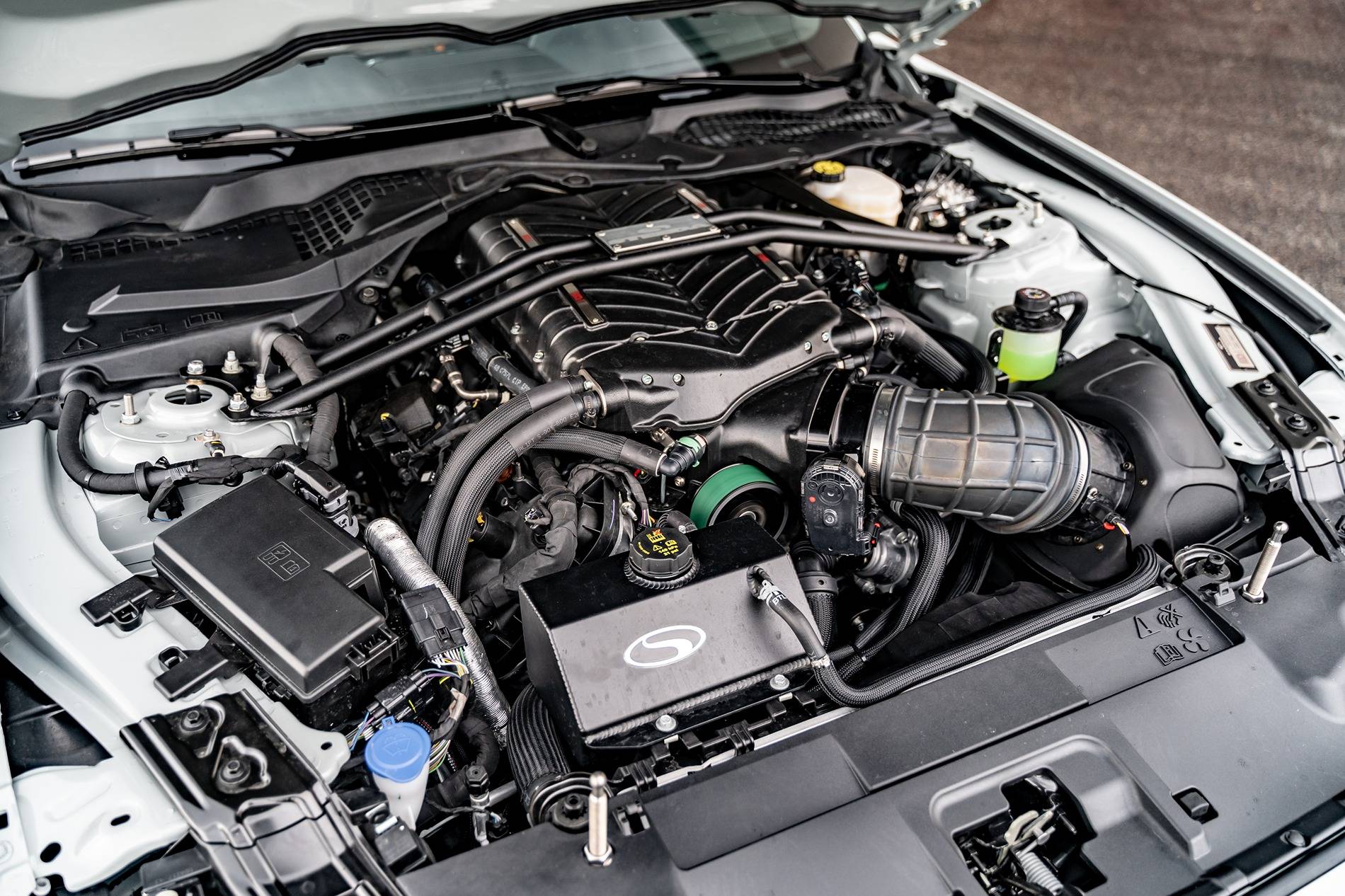

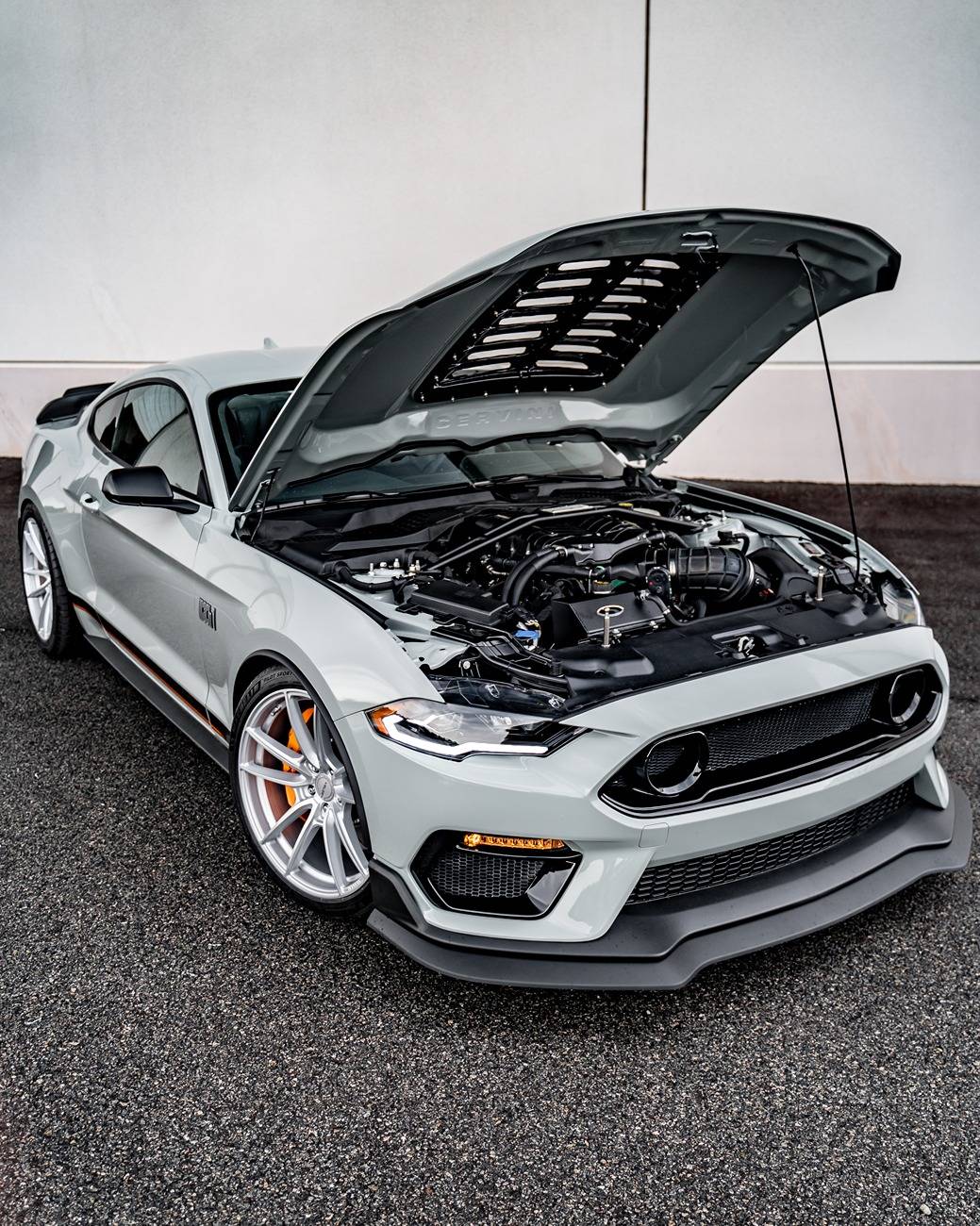

If you look at my vehicle, you will see that I have a strut tower brace, that Steeda manufactures, on my 2022 Mach 1 with a Whipple. I am not sure what hood you have, but you can check with Steeda if they make a strut tower brace for your setup.

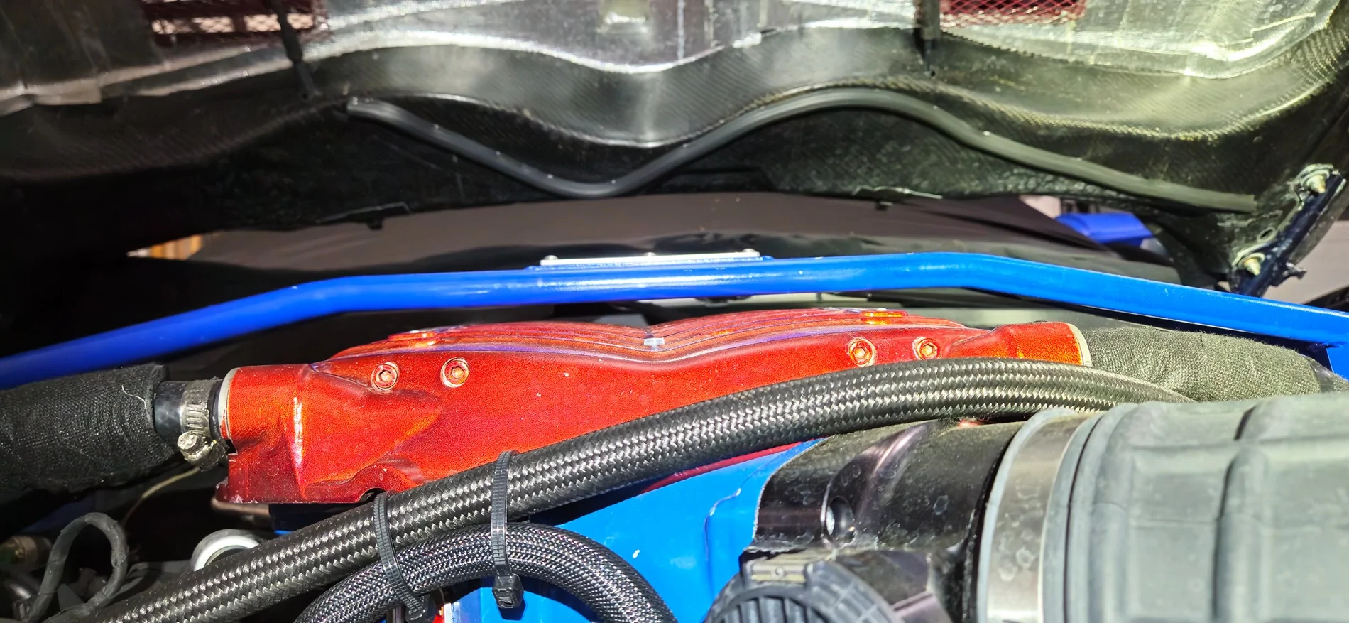

No lowering or raising was required. Because of the hood, there is enough clearance. Steeda manufacturers the strut tower brace in-house.

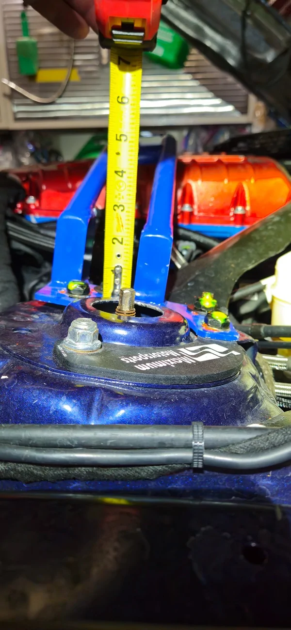

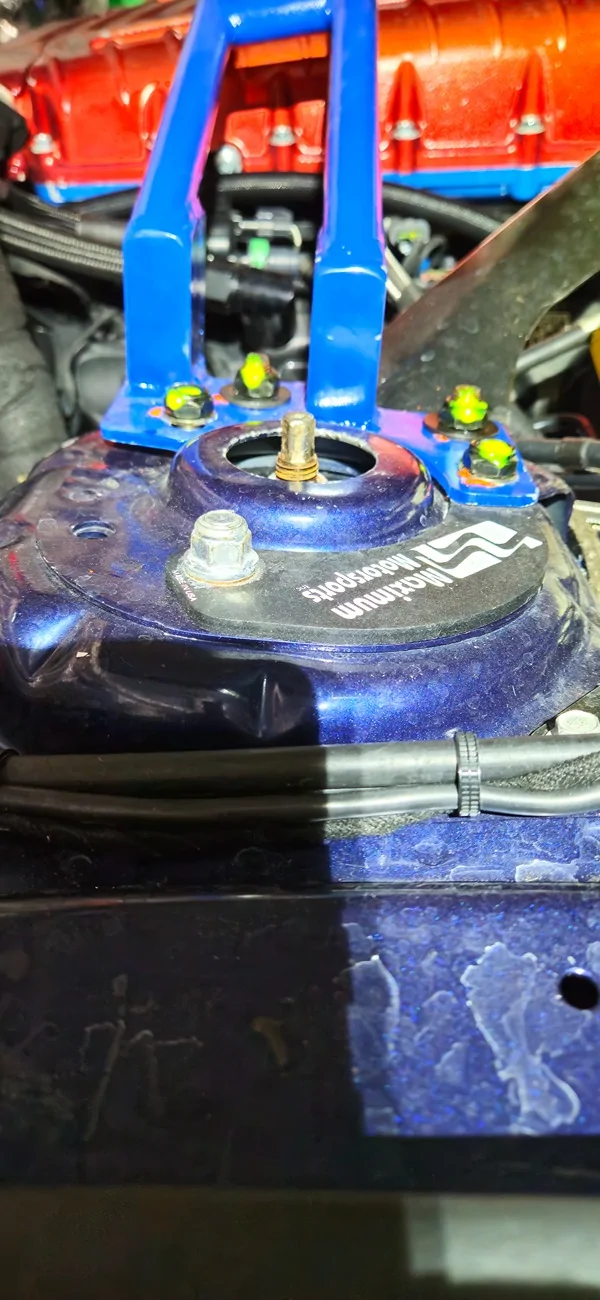

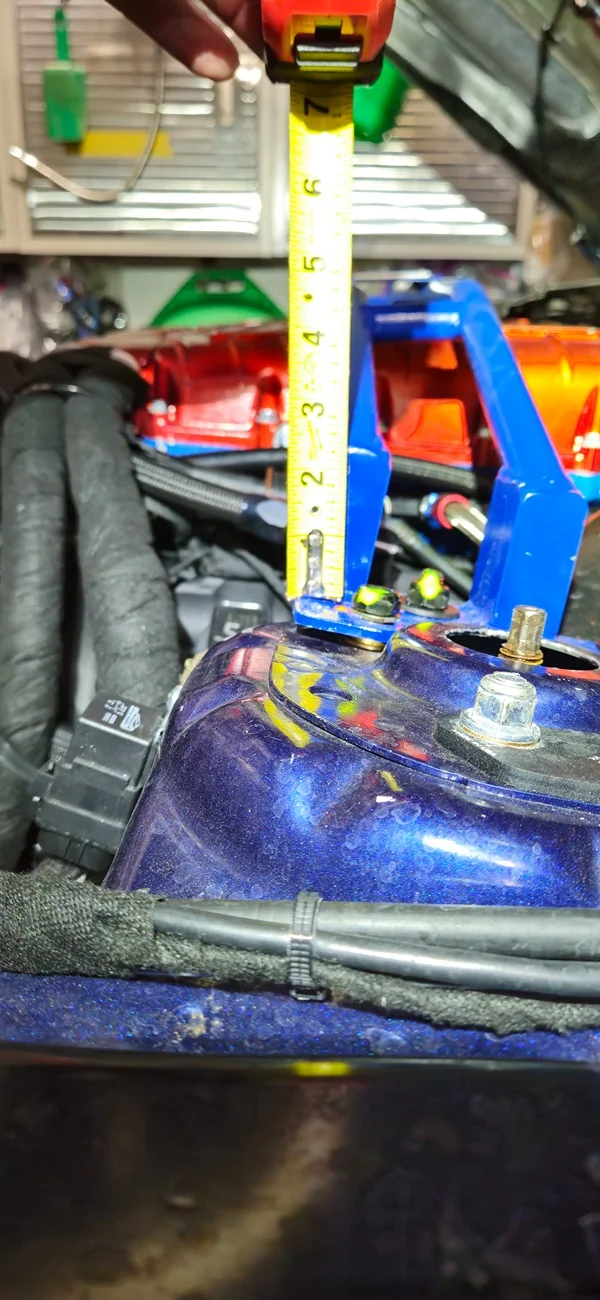

I bought steeda 4 point strut brace. I cut the brace tube ends at the base of the 1/4" base mount plate which bolts to the 4 each strut tower bolts. I ground/smoothed the base plate where the steeda .750 tubes were welded. I bolted the base plates LT and RT to the strut/brace mount studs. I then placed 3/8" plate on top of my blower to set the top plenum to brace gap. I placed the steeda tube brace on top of my blower lid, leveled the brace and then measure the gaps from the bottom of the tubes to the base plate. I cut 4 each legs from the 1"x2" hot rolled steel stock to the length of my measurements. My welder then put a small tac weld on each tube to each leg. Then I moved the brace, made adjustments until the brace was where I wanted it to be. My welder then put numerous tac weld on each leg. Removed brace and welded all legs/tubes. Fits perfect and I feel due to a larger weld contact of the legs to the base plate, the stability/strength is equal my OEM strrut brace.
