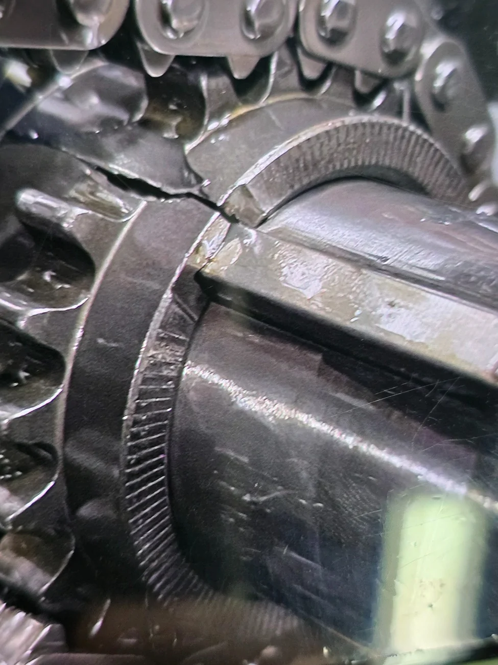

I guess i should have said the opg and crank sprocket is more of a preventive messure that some people still choose to do when I responded I didnt mean it was something that must be done. I've never personally broke an opg or even know anyone that has but I did break a tooth off a crank sprocket n/a, and no i dont bang off rev limiter or slide my car like a clown
