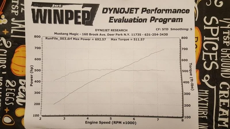

Scheduled time to have three dyno pulls on my Stage 2 Whipple car tonight. I was VERY happy with the results. Before I get into them, let me tell you a bit about the car.
The engine is stock except for OPG and TG. The exhaust is stock except for an X-pipe. The Whipple setup is as it came except for a 3.625" pulley.
First I topped the tank off with 100 octane gas.
On the first pull, the tires started slipping and we only ran it to 7000 RPM. Result: 659 hp, 487 tq. Thinking the heated tires would grip better, we did a back to back run with no cool down. Result: 656 hp/510 tq.
Then we let the car cool for about 20 minutes with the monster fan running. I told the operator to run it all the way to 7500 RPM and roll into it so the tires wouldn't break. Result: a whopping 693 hp/512 tq. Needless to say, I'm VERY pleased with those numbers, especially considering I have no other significant mods. This was also using the stock Whipple tune.

Great to hear man! Cool down always helps.

OP nice numbers. Its crazy how close all these whipple cars dyno. Mine made 687/525

I'd say those are great numbers for a car with a stock cat back!
How did you like Mustang Magic? I had work done there 15-20 years ago. Back then it was a good value and they did quality work.

Good power! My Centri setup does not make over 500ftlbs until 4800+ RPM... You got it at 3600 lol

Those numbers seem dead on for his setup. Welcome to the club!
