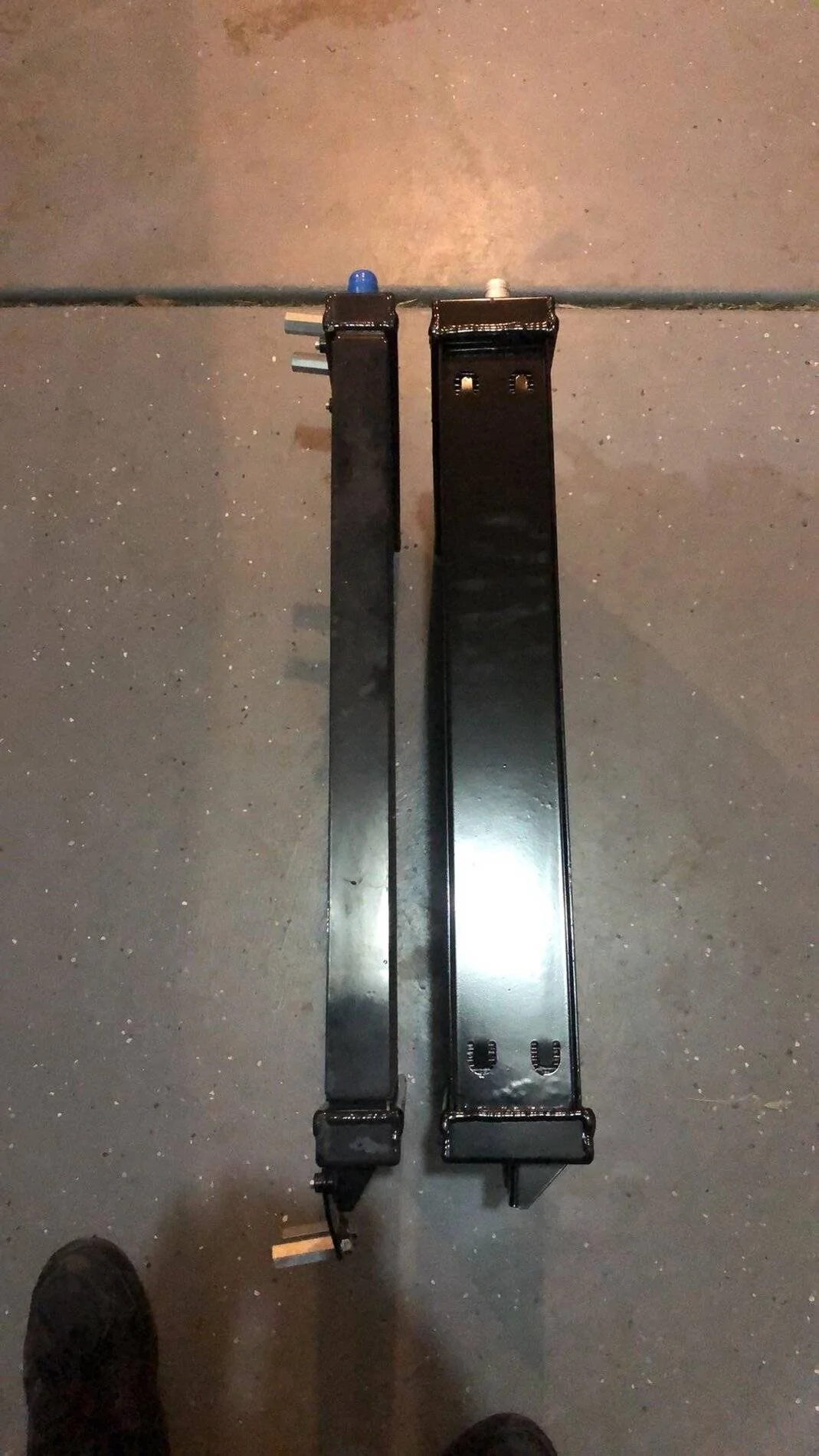

The size difference between the two is very apparent. Here in Utah it dropped my temps and allowed for better cooling while daily driving and “spirited” driving. Worth it IMO from personal use on my 17 with s stage 2 Whipple making 820hp. ☠
