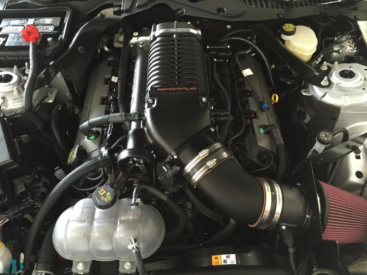

Looking good!
beautiful! It sits so perfectly like it was meant to be there
