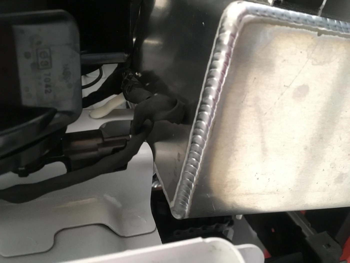

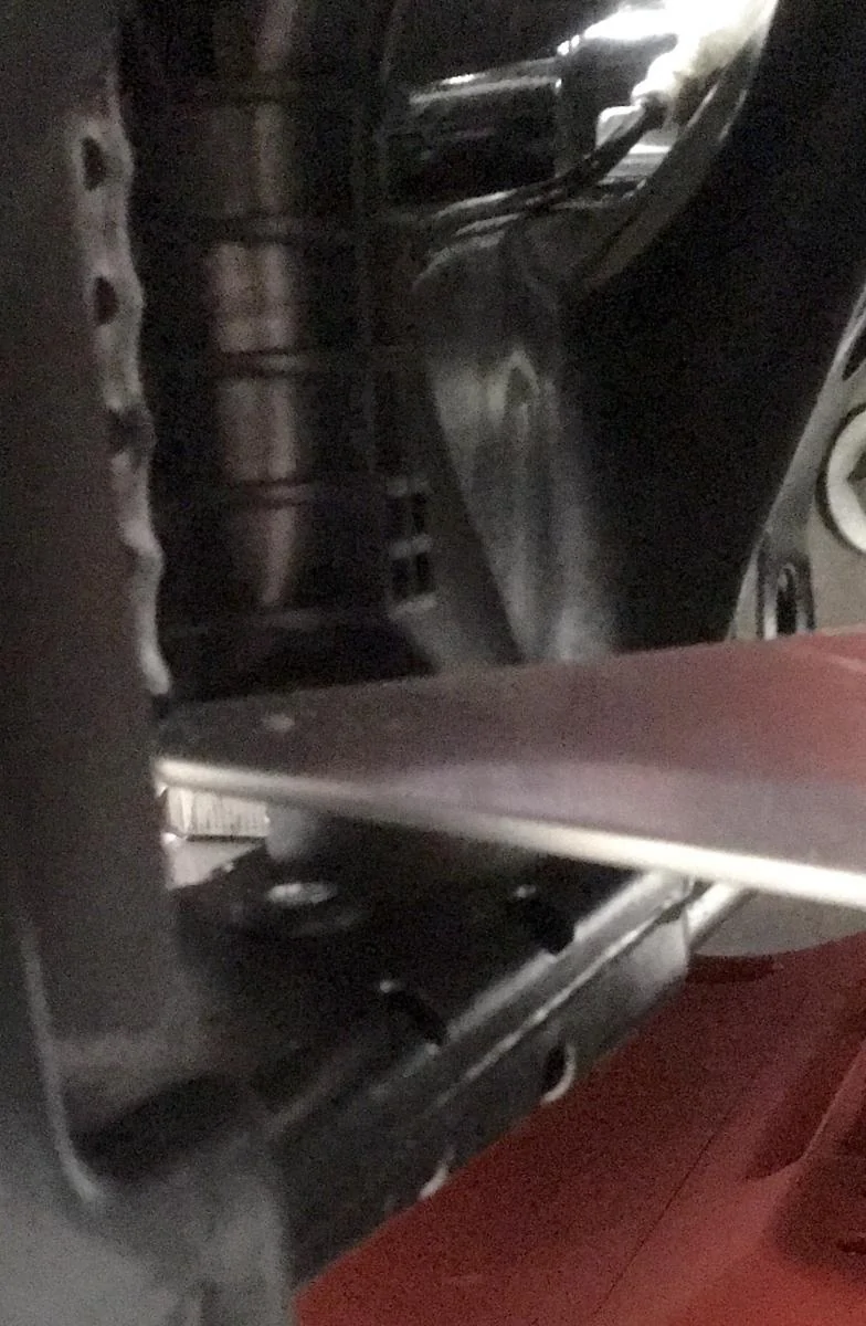

So I'm installed nag my stage 2 and the inter cooler reservoir holes are not lining up, the connection at the radiator support bracket is 3/4 inch too high and the tank itself is hitting the body. Did I get a bad tank?

Do you have the Top Mounting Bracket of the Tank on the Inside or outside of the Factory holes in the body ?

Please email me your Information the SC serial number and who you purchased it from and I will get a call tag to get that one back and send another one your way. Possible the mounting location's got bent somehow.

It's nots bent, the mounting tab is welded in the wrong place. I will email my info. Thxs.
