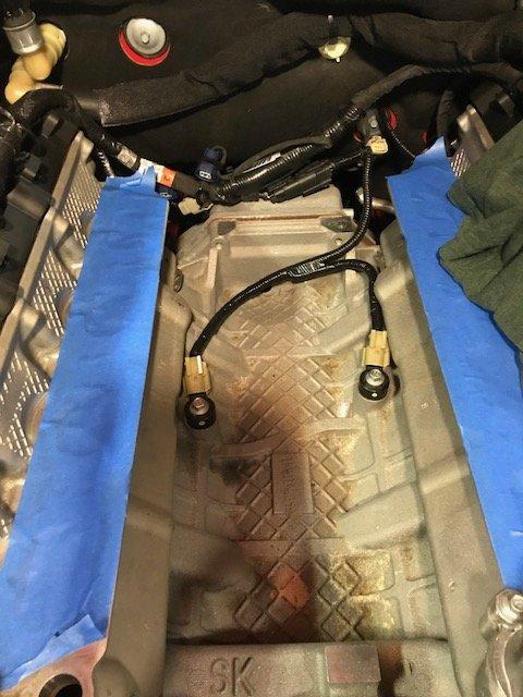

When you say the ā€˜mid rear area’ are you talking about the wire loom itself? Referring to that, you should be able to reach behind the intercooler and feel that wire loom move freely in the open notch closest to the drivers side. Obviously no other wire loom should be pinched in there either. I did not remove my plastic L support pieces near my knock sensors either and my distance is probably has the same clearance as yours. I’ve done four Whipple installs this same way and none have been a problem or caused false knock.
We can definitely mind f**k ourselves on these projects especially when we choose to do these types of projects because we want the satisfaction of knowing it’s done right. Ultimately you have to satisfy your own demons.
Here is a pic of mine for reference.
