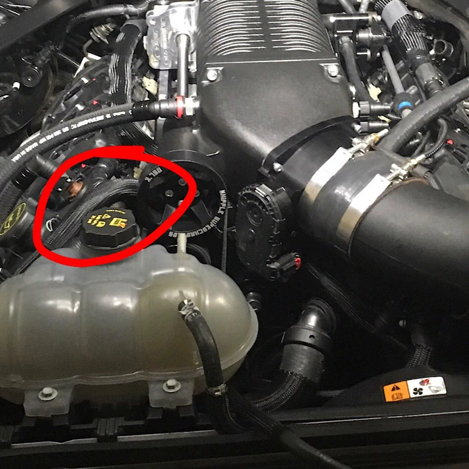

Mine usually peak around 20*C over ambient. Eg. 20*C day (68*F) I’ll see 40*C (104*F).
That’s with the oversized HE.
I’ve often wondered if the crushed shape the hose takes (shown in the pic) might be restricting the flow of coolant.
I've got the oversized H.E. as well. I am thinking i might have an air bubble and the H.E. isn't circulating properly.

I run the VMP dual fan heat exchanger and I put in a 170 Tstat. Its about 75 out here in vegas right now, last night cruising my IAT2 was about 98 and after I did a pull it got to about 108. I know I have a diff blower but 155 seems super hot, only time my car has seen 150 iat2 is sitting in traffic when its 110 outside.
gqneon
Jun 25, 2015
91
867
144
Westfield, IN
18 GT PP / Manual
Yeah that's high. Check for a kink where your filler neck tees off to return to the coolant tank. That line was almost shut on my 15-17 setup so ireplaced it with a 270* bend silicone piece and temps dropped immediately. Good luck!
