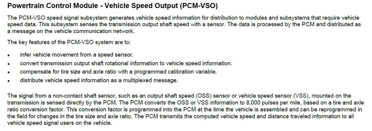

That is incorrect. It is from rear wheel speed sensors.
So what's this in the service manual going on about? (OSS) output shaft speed sensor located at the rear of the transmission sends speed data onto the CAN bus.
The wheel speed sensors (four of them) are for the ABS system.
The PCM may use that, particularly for the A6/A10 cars for shift schedules, but the indicated speed in the cluster is coming from the rear wheel speed sensors.
Want some practical evidence? Swap to a different rear axle ratio without changing anything else. If it relied on the OSS, the speed would be off. In reality, it matches GPS speed because it's from the rear wheel speed sensor.

Changing the tire diameter changes the revs per mile actual but the wheels speed sensor just sees revs. If the OSS was used, changing the rear axle ratio without changing the programmable parameter for the rear axle would result in the speedo being off. The reality is that you can do a gear swap, change nothing and your speedometer indicated speed accuracy will remain for a given gear+rpm.
