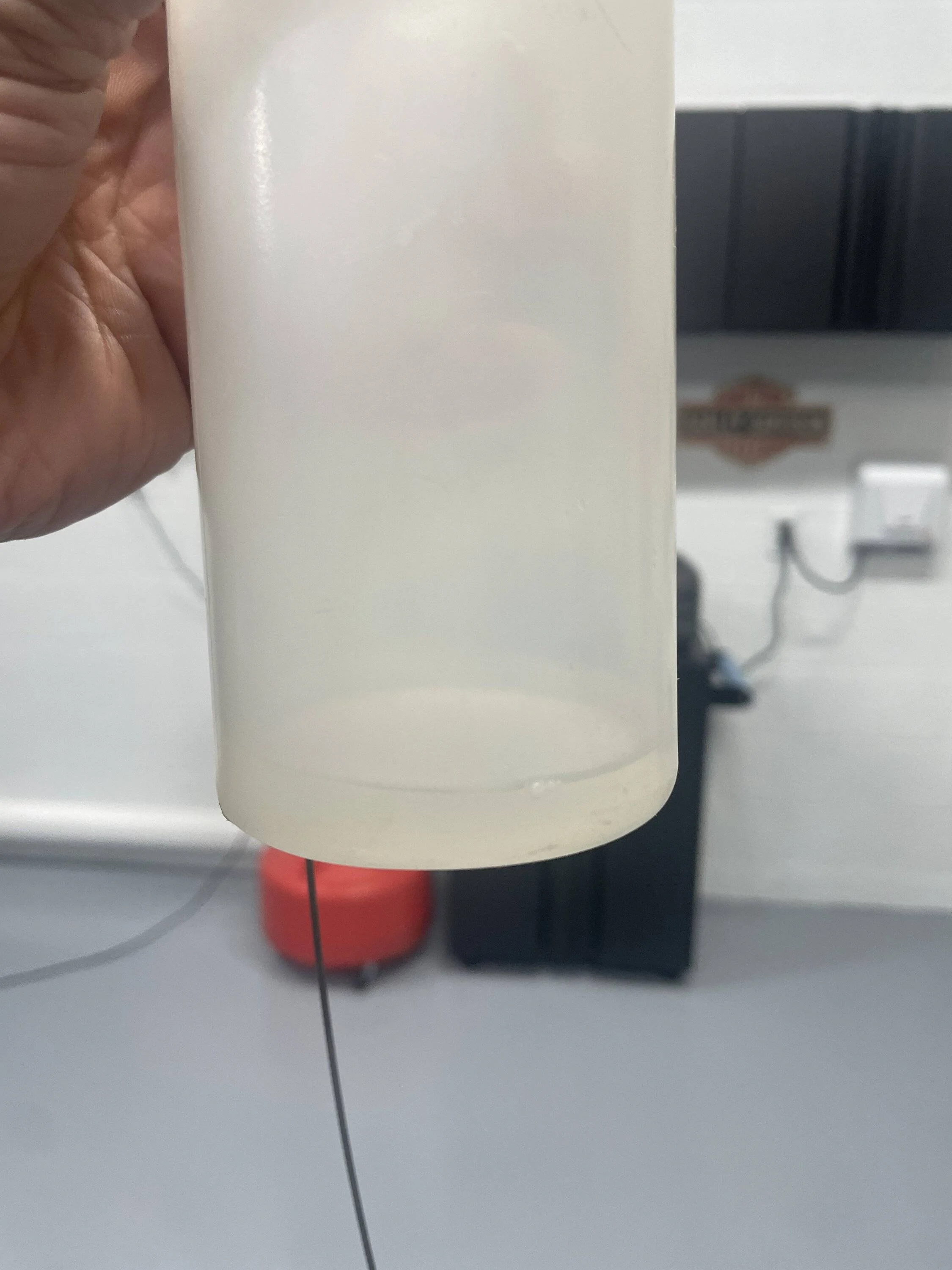

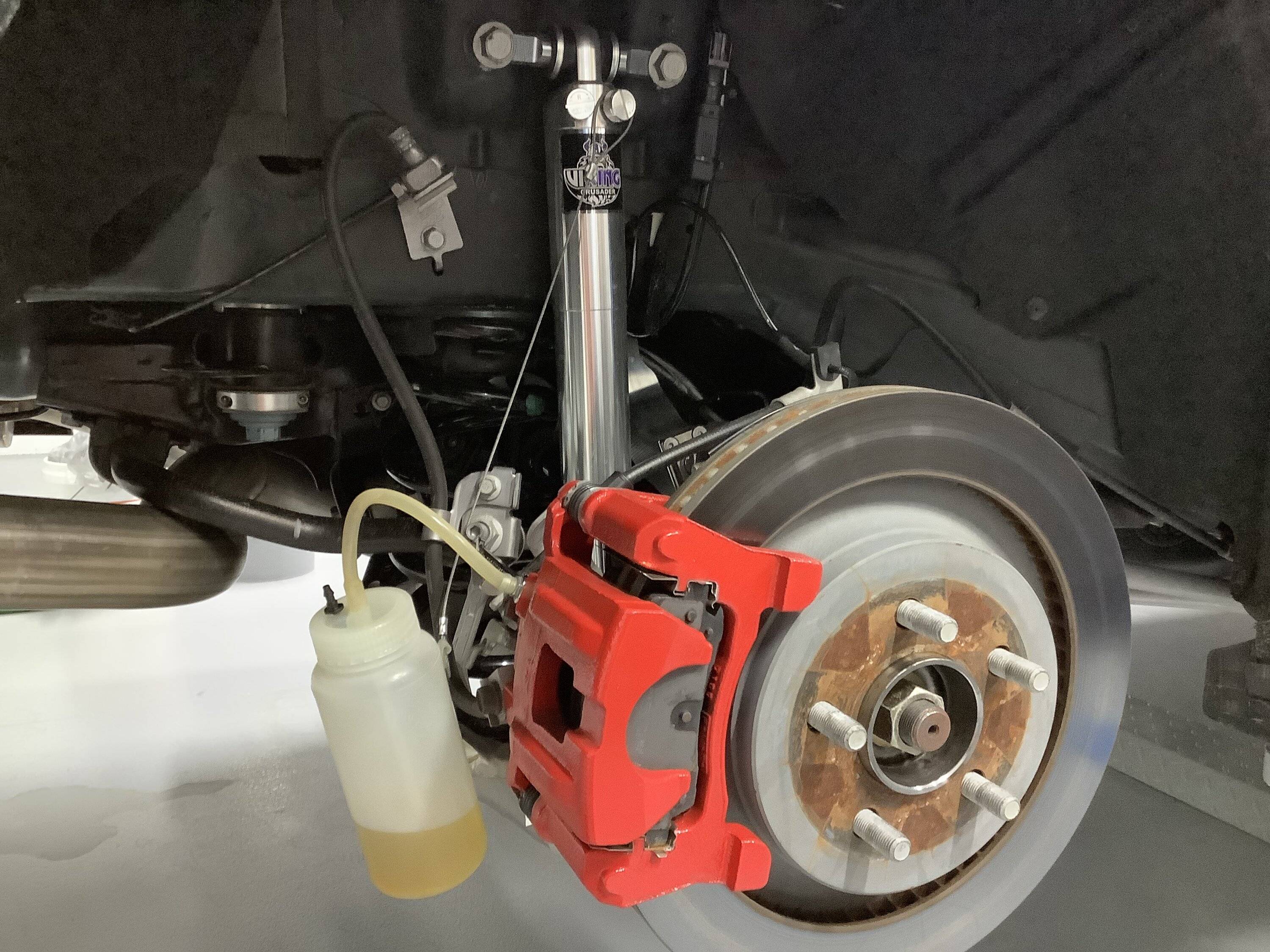

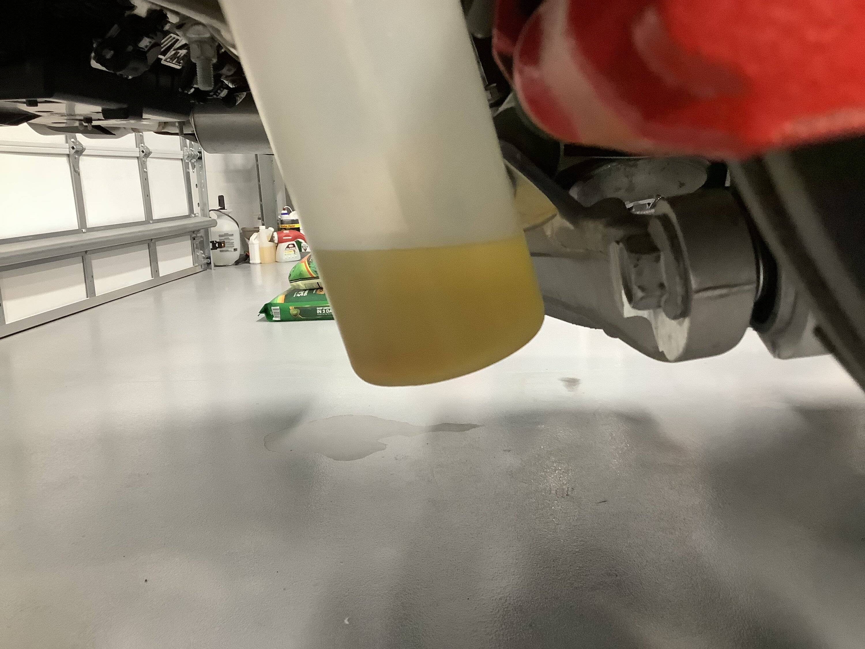

Time for another brake/clutch fluid flush in just 1300 miles. It’s fair to say that during that time, I’ve put lots of heat into the system by launching at the drag strip several times and then scrubbing off speed at the end of the track. Look at the difference in the color of the fluid.
Old fluid
Fresh fluid
