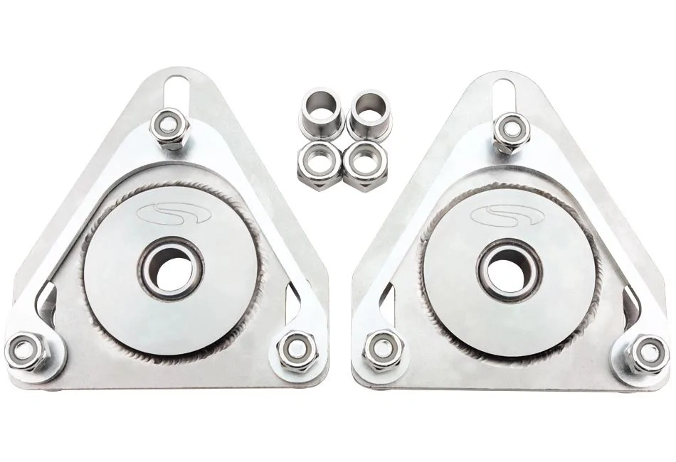

SteedaTech
Aug 8, 2016
71
2,079
1,624
Pompano Beach, FL
2016 Mustang Q750
Steeda Camber Plates
Steeda has been manufacturing camber plates for over two decades , with a lifetime warranty.
Our camber plates are the easiest to adjust with the best most comprehensive production bearing support on the market.
Product Benefits
  • Ideal for any lowered street or track Mustang
  • Reduce excessive uneven tire wear which can result from lowering your car
  • Most adjustment range on the market: adjust camber angle from -0.3 degrees to -2.8 degrees
  • Highest quality, stainless steel, Teflon-lined bearings included
  • Nickel-plated bearing housing, Tig-welded and CNC machined to exact tolerances
  • Grade 10.9 hardware and nylock nuts included
  • Increased front grip, turn-in response and cornering performance
  • Reduced understeer
  • Increase overall cornering capability by .11 G's
  • No increase in NVH
  • Specifically designed for the S550 chassis and front suspension system
  • No permanent modifications required
  • Steeda American-made quality, backed by a lifetime warranty
  • Compatible with KW Suspension V3 Coliover Kits and Performance Pack shocks

Just installed the Steeda plates this past weekend. I am a machinist and have been in metal working for 18 years now. I will say I am impressed by the level of quality of these camber plates. I will note I don't have experience with other offerings so nothing against anyone else's plates, but can say the Steeda's are nice and I would recommend them.
