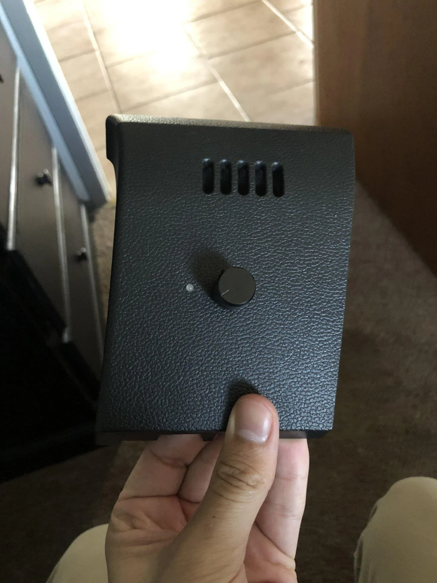

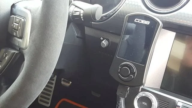

Not a rocker switch, but installed this bass knob and led indicator light yesterday on the “fresh air vent” trim piece to the right of the steering wheel. Space is kind of limited but the trim piece itself is SUPER easy to take off

I used the same trim piece on mine. I have two like that. One I use to switch between my two sequential turnlights up front, and one I use for my light-up badge out back.
The place is 'well hidden' behind the steeringwheel and out of sight. Also cheap to replace.

I am totally stealing this idea for the control knob of my TWK-88. It's the perfect place for it. Way better than the change tray under the rocker switches. Thanks! :D

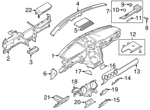

Can anybody supply the part number for this panel? I want to put my bass knob here but would like to buy a replacement in case I want to go back to totally stock.
From this page, it looks like it’s <046A76. I can’t find it online anywhere, though.
https://parts.ford.com/shop/en/us/body/instrument-panels/panel-instrument-6497669-1
StangTime
Apr 16, 2019
81
3,594
4,094
Ontario 🇨🇦
Todd
19' GT PP1 Manual
Looks like part #19
That's part# HR3Z-63046A76-AA / Instrument Panel Trim Panel
You get it from Tasca parts.

It's not just a blank panel, there are some mechanical bits on the back, looks like a tiny fan and a sensor.
Mine is in the same spot but above the "stuff" on the back:
Thanks for this pic, as well. I took it off yesterday and noticed what's behind it. I considered putting it above the "louvers" as well. I took the circuit board out of its metal housing to cut down on the space required. Mine is an Alpine RUX-Knob. Not sure where the best option is, but the innards of my bass knob are long enough that I have to worry about the angle of the mount so the back end of the knob where the RJ11 plugs in doesn't interfere with the back side of the sensor that's in that panel.
