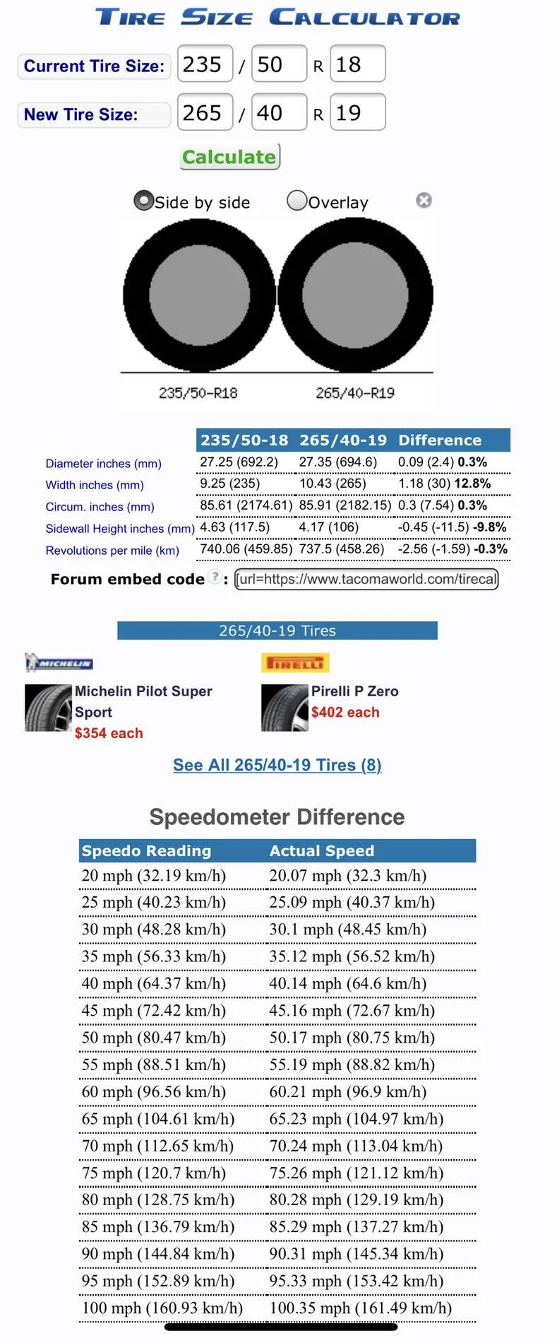

I have a 2021 Mustang GT Premium (non PP) on order and it will come with the stock 235/50r18 square setup. I am looking at going to a 265/40r19 square setup. Already talked to my dealer’s service department and they said they would not be able to reprogram the car’s computer on this setup because it is not one of the stated options on the GT. So I would only be able to go to the 255-275 PP1 setup as a change they could reprogram. I don’t want that. I mentioned the EcoBoost has a 265 square option but he said they weren’t allowed to use that program on a GT. Anyway, I know that 265/40r19 square on 19x9.5 is very close to the stock 235/50r18 on 18x8 for speedometer accuracy but is it close enough not to affect my ABS or traction control? Here is a snapshot of the differences:

If you keep your wheels approximately the same diameter as stock (most stock wheel/tire configurations use a narrow band of wheel diameters) then the ABS and traction control will be just fine.
We don't get any reports here (in 6 years haven't seen one) of ABS or traction control being problematic with a specific wheel setup. I've personally run 255/40R19 & 275/40R19, 285/35R19 square, 305/30R19, 295/35R19, and never had any issues.
ABS and traction control are basically looking at relative wheel speeds. Neither is particularly sensitive to a few percent of wheel diameter.
So ya 265/40R19 is basically exactly the same diameter as 235/50R18, so you're good to go. No recalibration needed, just bolt them on and drive away.
