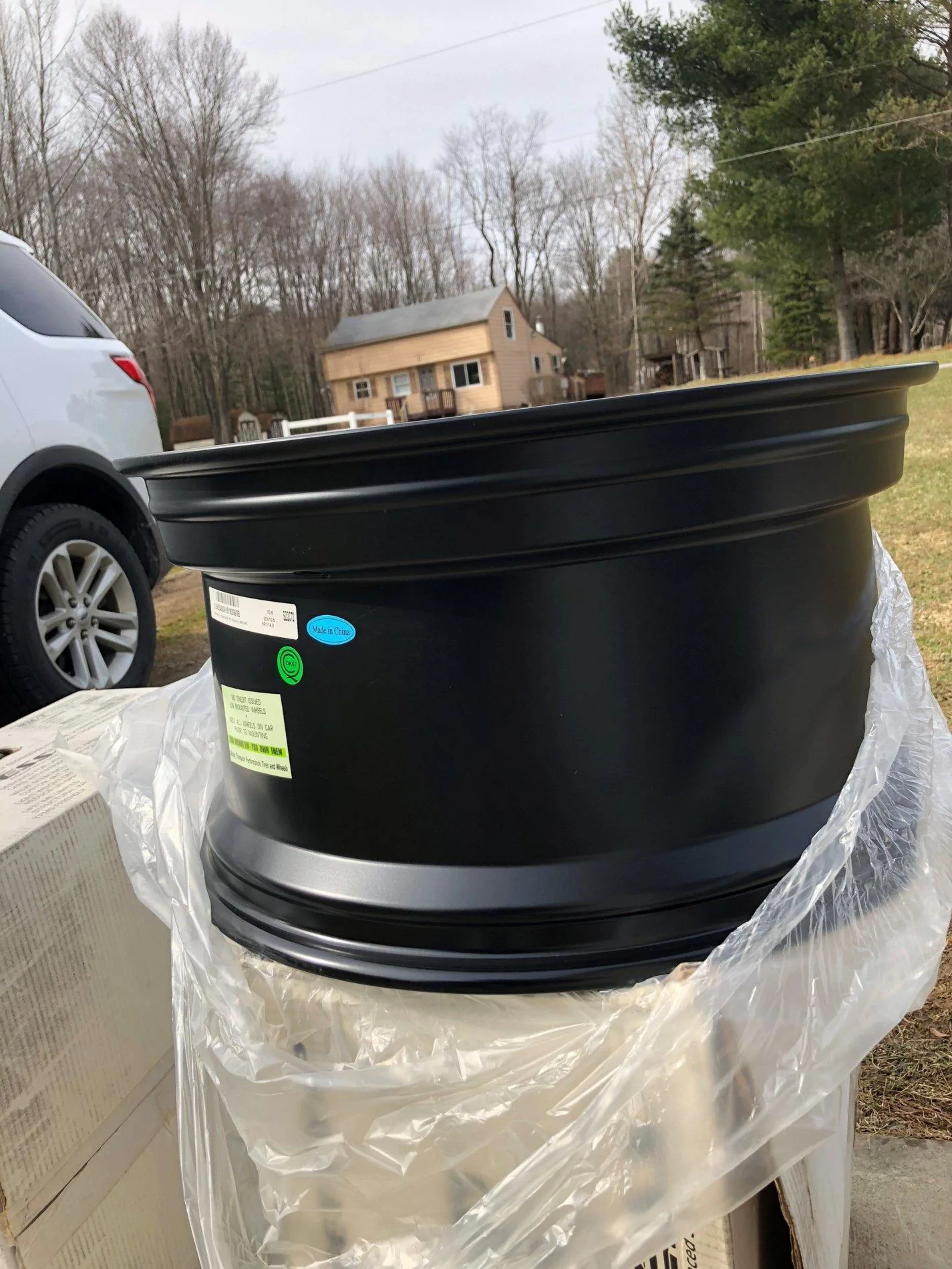

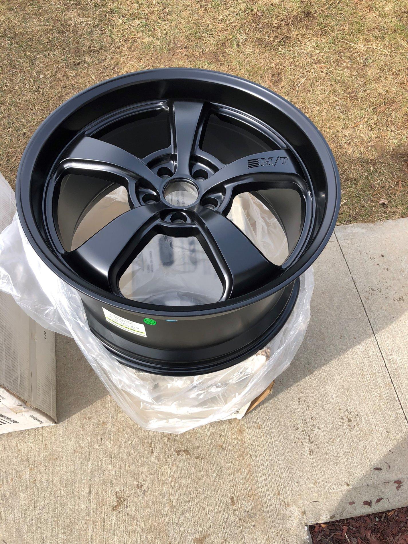

ive been reading these comments and am confused. American muscle wheel chart says that a 10.5" wheel can fit a 275-315 tire. I see people stating you need an 11" rim for even 305's.
I purchased 9" for front and 10.5" for rear to put on either 305 or 315's in rear but now im confused.

You’d *like* to have a 11” (or wider, even a 12”) wheel for a 305 tire, but yes you can squeeze most 305 tires onto a 10.5” wheel. Maybe even a 10” wheel, but you arent getting the most out of the tire contact pach when doing so.
