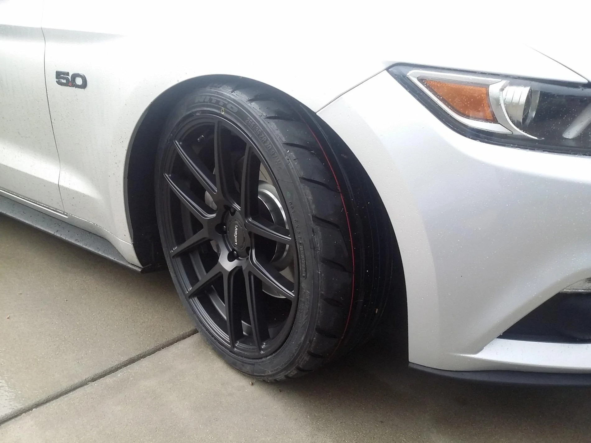

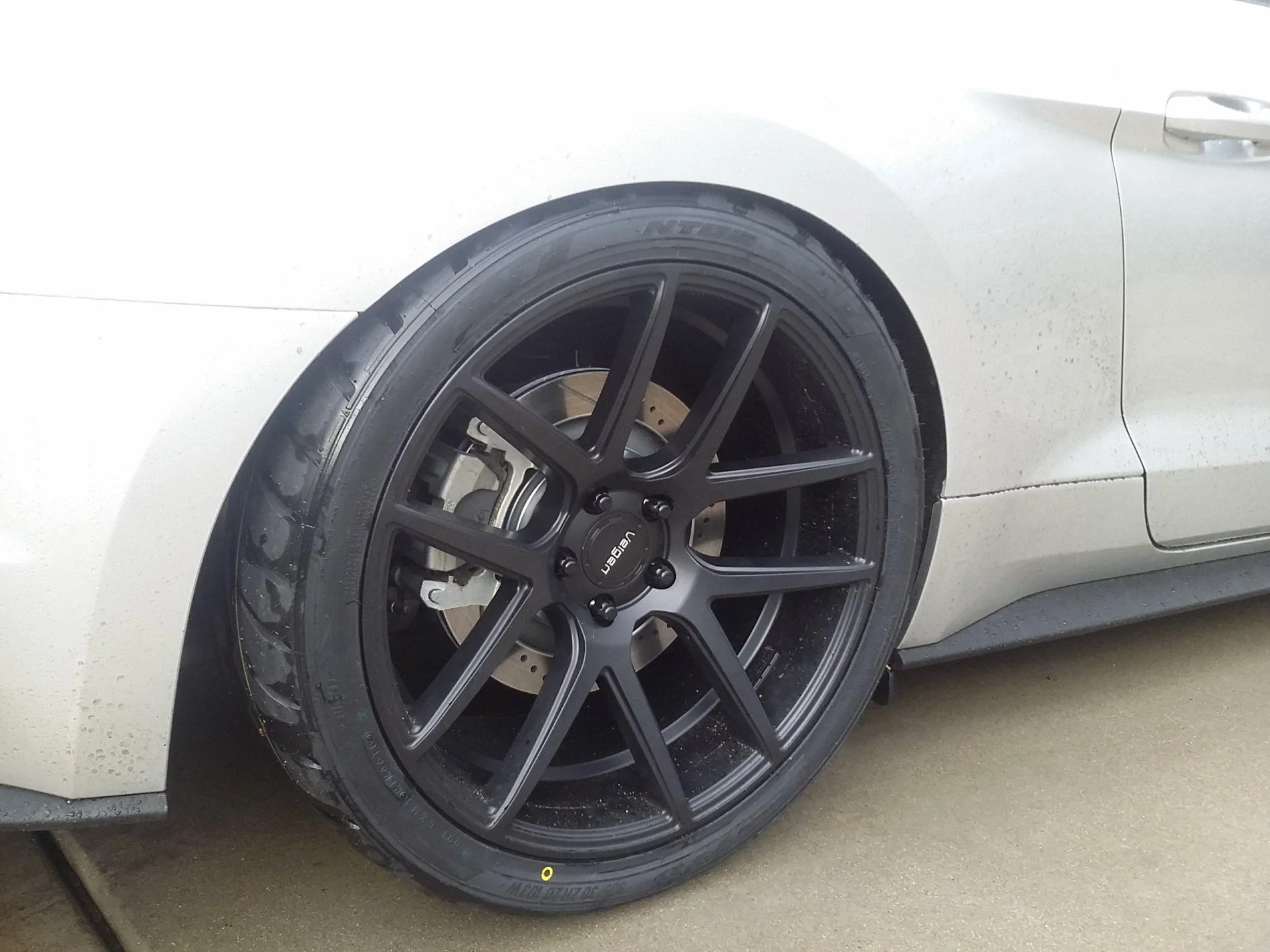

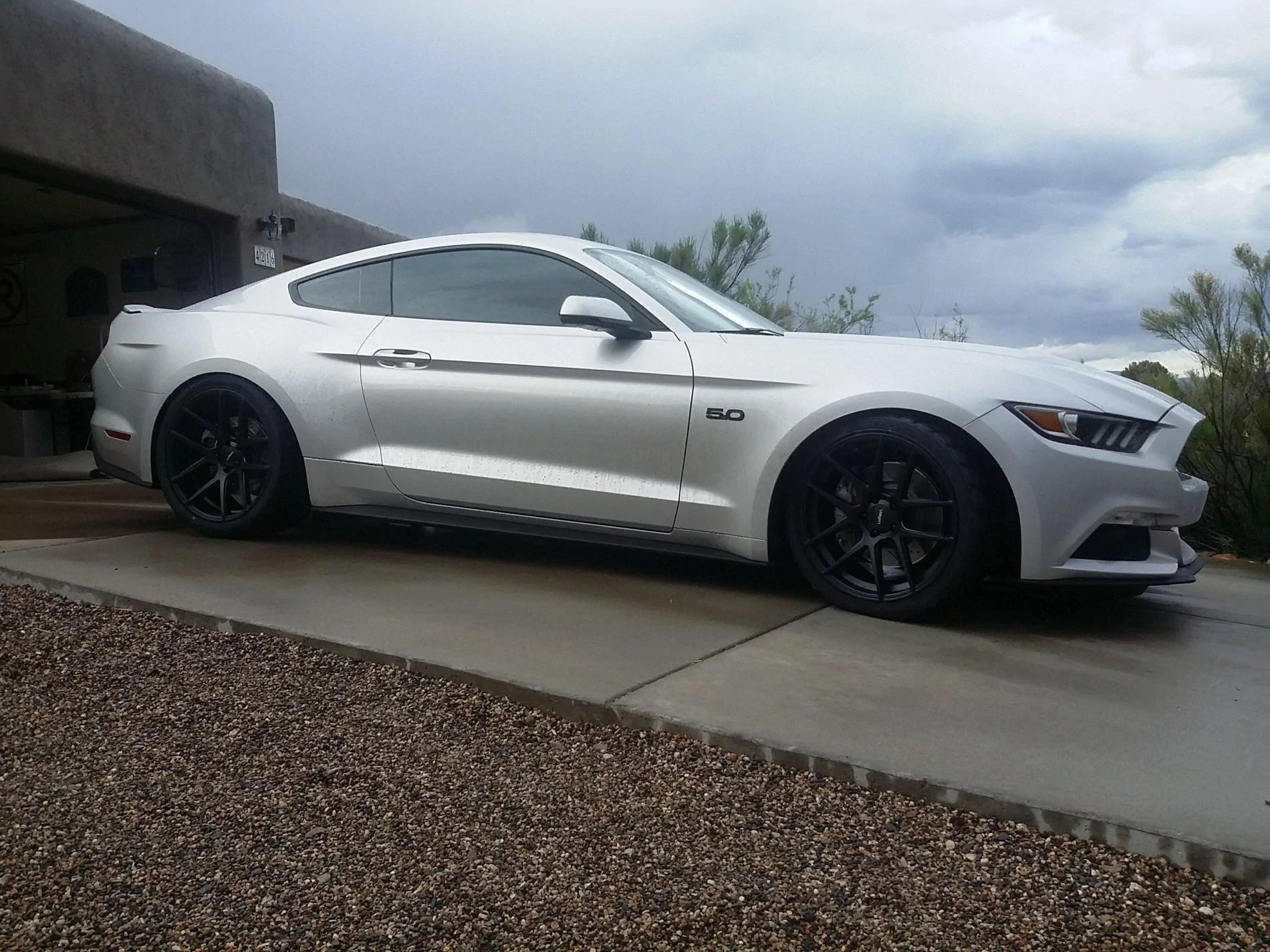

Just trying to use stock face as a reference point. Stock rims are 1inch in and tires about 3/4in. However i don't want tires to stick out past fendet either. Thanks for PM.
fmc_smt
Jun 4, 2018
39
1,295
2,634
Cottonwood , Arizona
2015 gt , 2015 Escape , 2015 F250
20x9.5 +35 255/35 front 20x10.5 +45 305/30 rear about 1.5 drop no rubs and everything is flush
