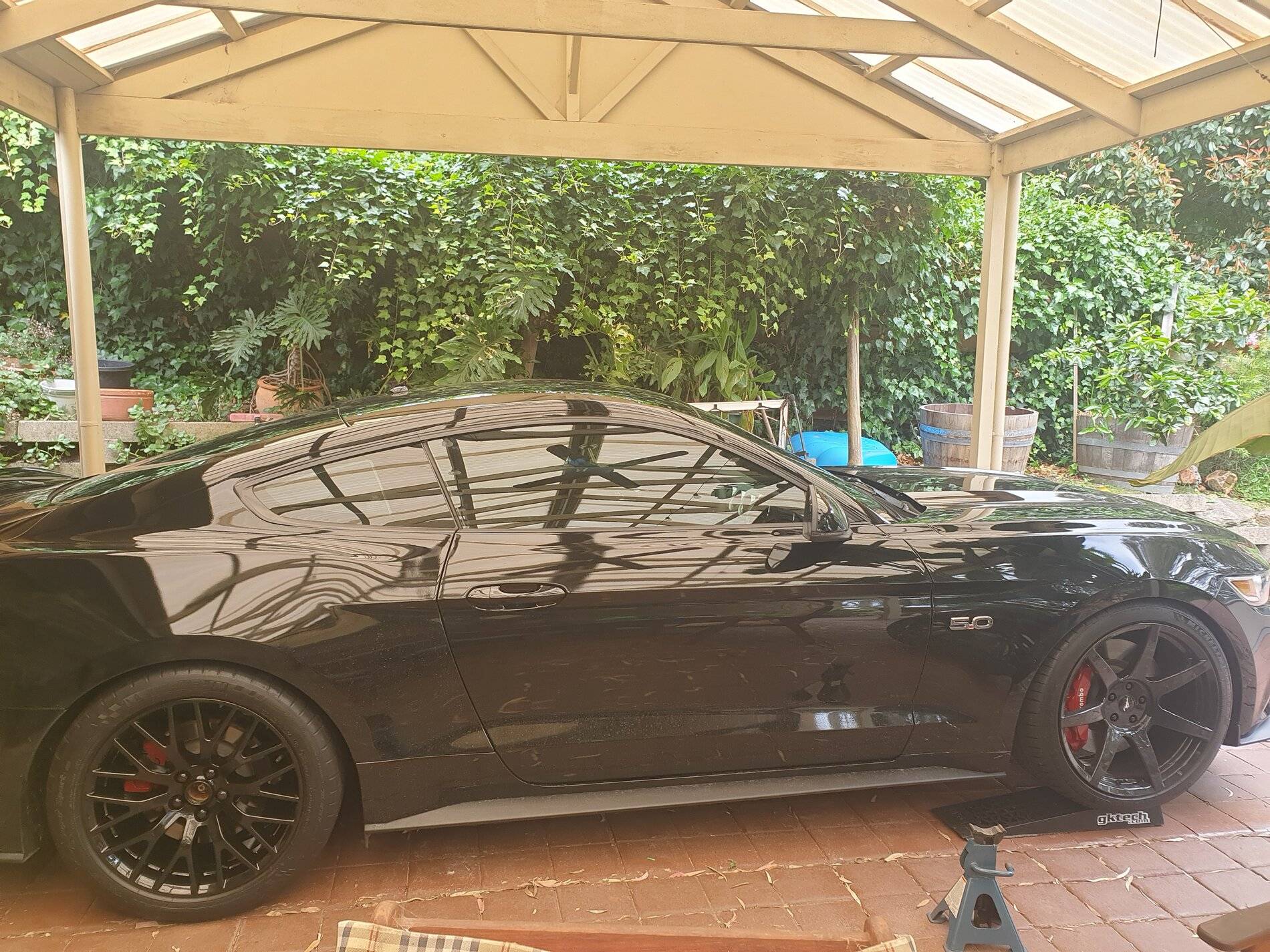

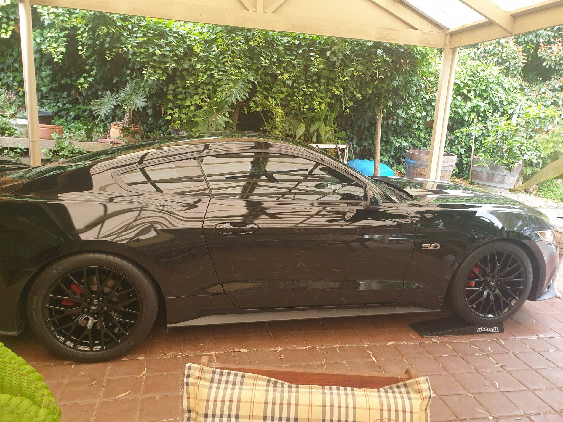

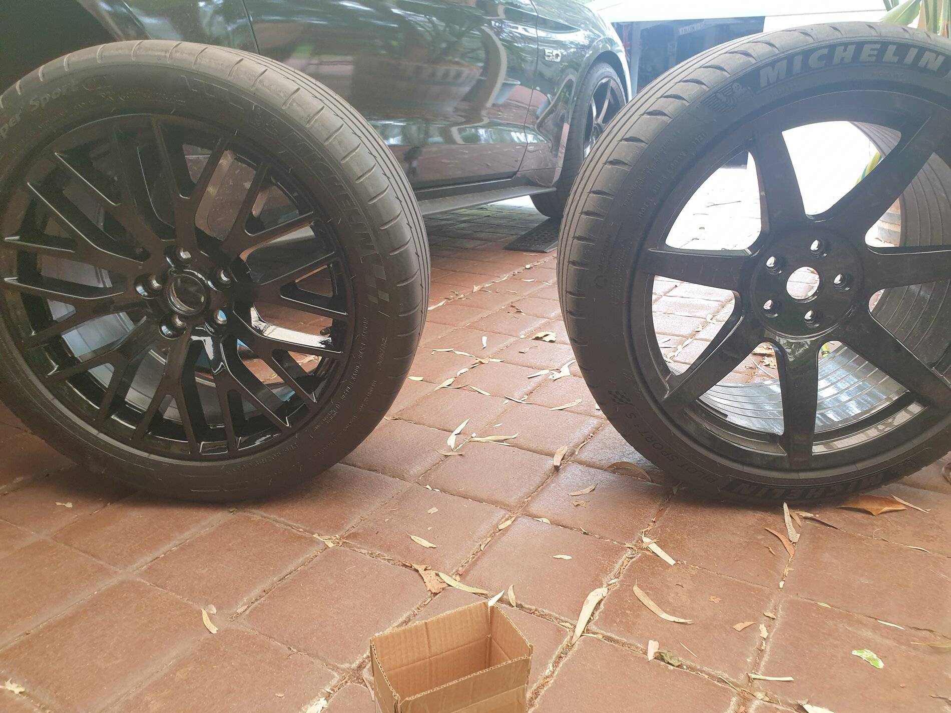

Did some more investigation today and its definitely a LHR bearing. I jacked the car up and while on stands I ran the car in drive and I could clearly hear grinding from the bearing area. While there is currently no wobble, when I took the wheel off and tried to shake it from the wheel shaft area the good old clunk from the bearing area was there for all to see. Just to make sure I did the exact thing to the drivers side rear it its solid as a rock. So I will be ringing the dealership tomorrow to book it in. ☹☹☹☹☹. I know this probably sounds crazy but I also put the old mags back on because I don't trust the dealership to totally look after my new ones. I miss the new ones already 😥😥😥😥

As a side note, having put the heavy original mags back on i definitely notice the difference in front end steering feel. Its much better and more responsive on the project 6gr wheels.
