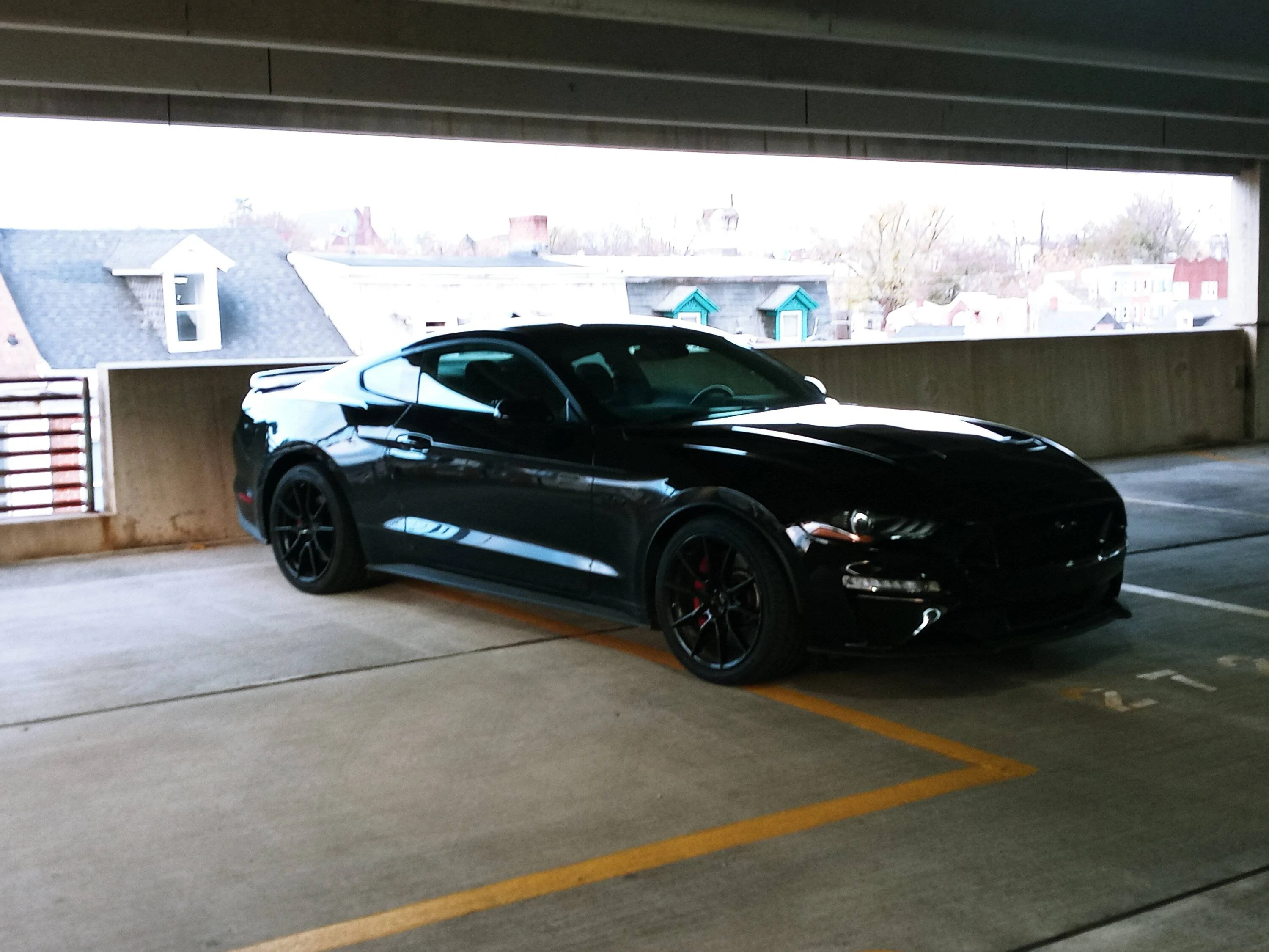

pau
2021 GT mustang
GT 350 wheels on a stock '21 GT. 305 30/19 front and back

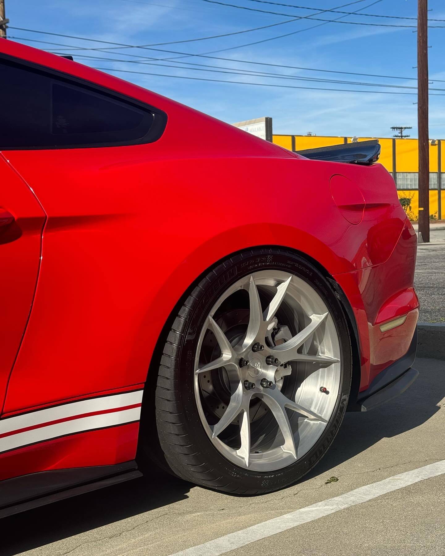

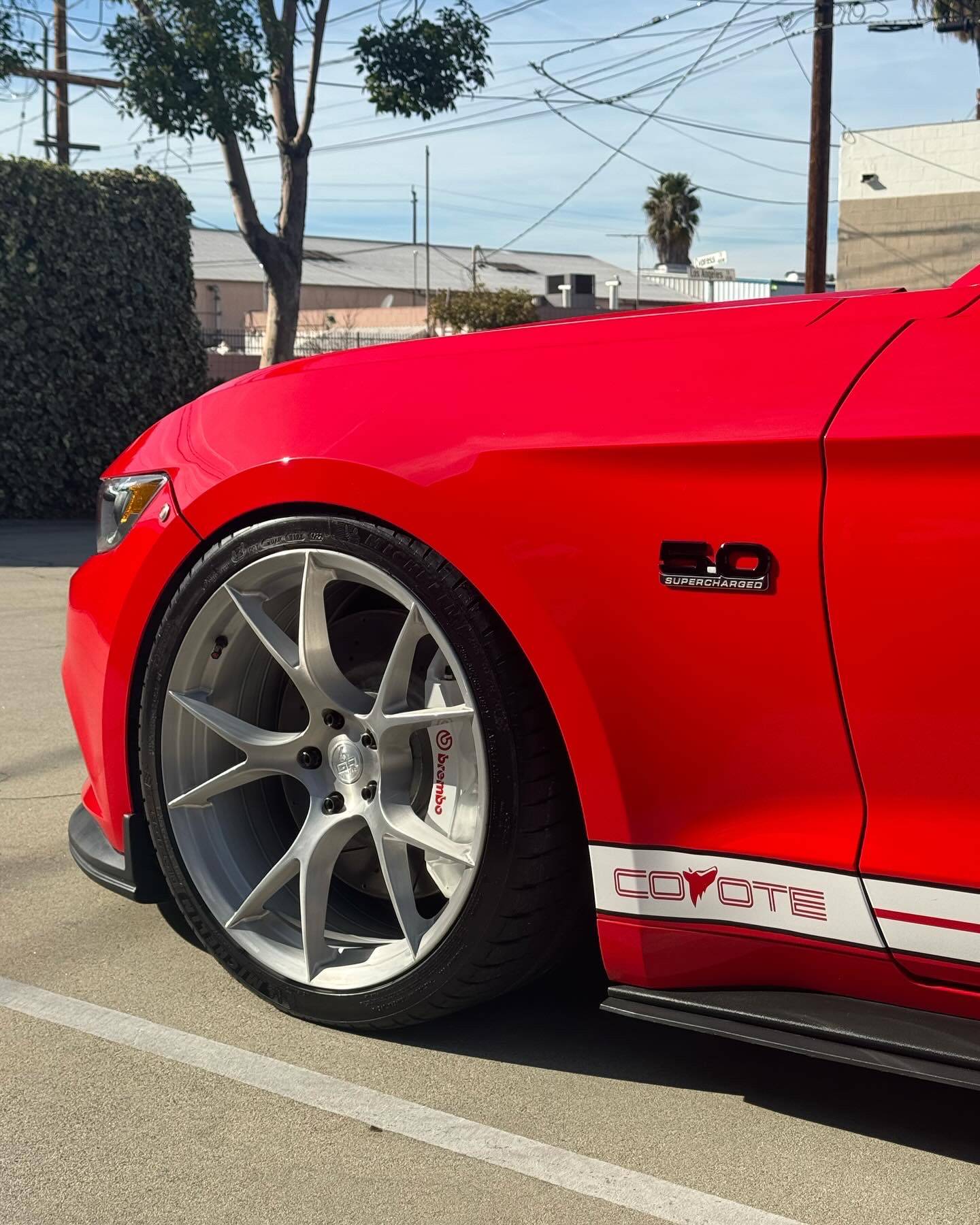

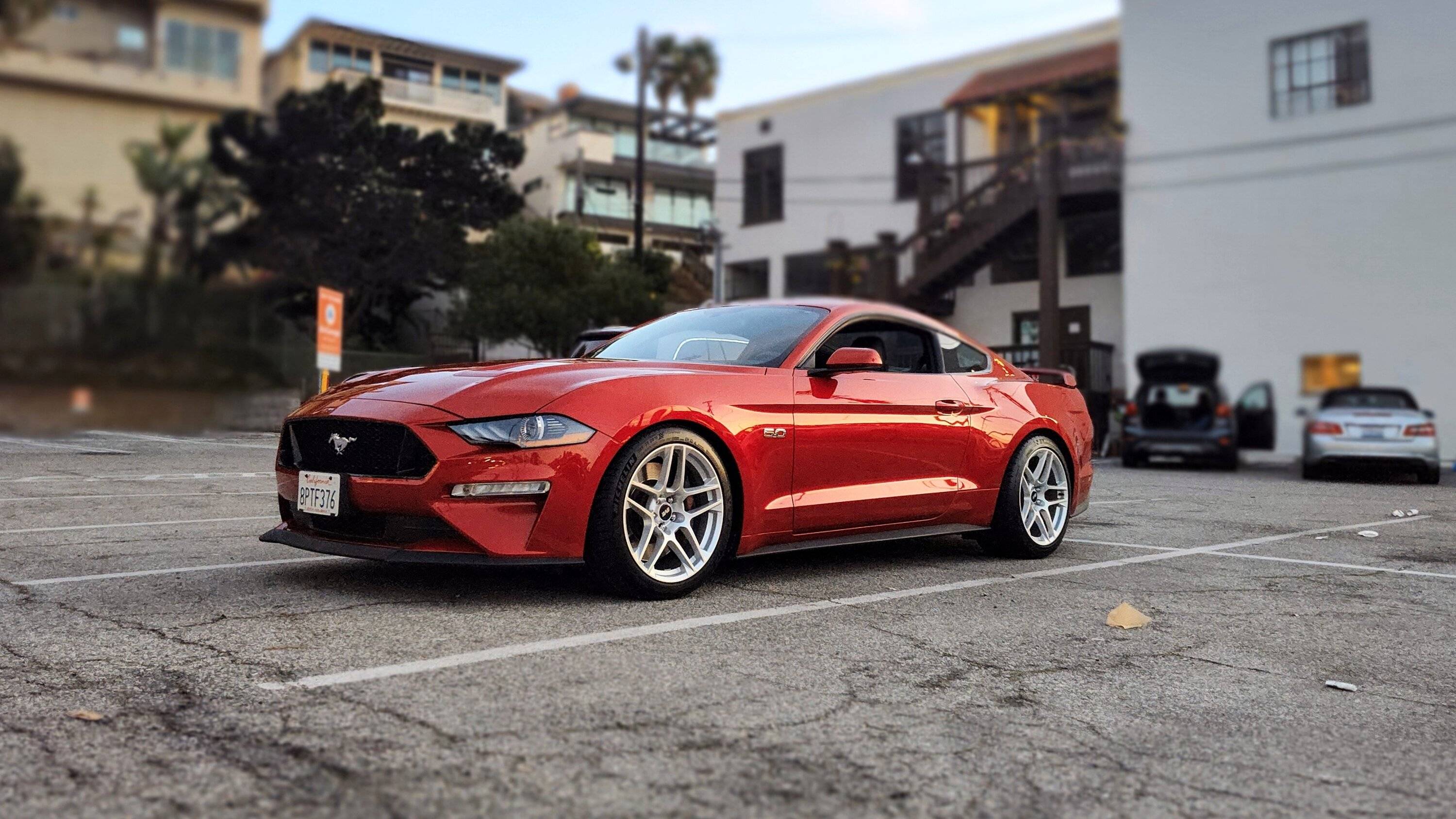

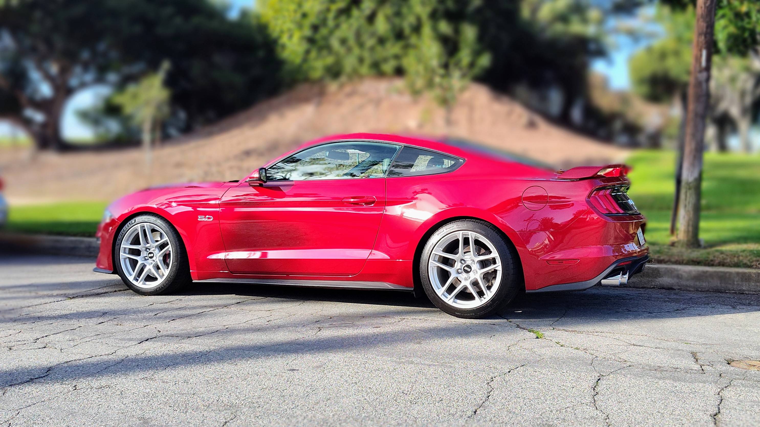

Some side shots..
1st pic front 19x10 et35 -1.6 neg camber
2nd pic rear 19x11 et50 -1.9neg camber

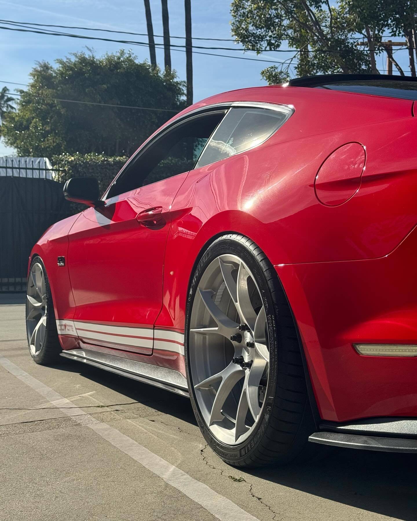

Hey this is Junior from Project 6GR, here is a example of my personal car.
6GR Ten Spoke brushed aluminum, 20x10 +35 285/30/20, 20x11 +50 315/30/20 Michelin Pilot Sport 4s tires. A good alignment has a lot to do with how the wheels are going to sit with the fender/ quarter panel. Feel free to give is a call if you have anymore fitment or wheel spec questions, we would be glad to help.
