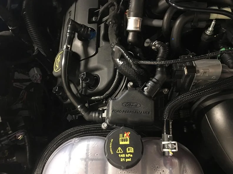

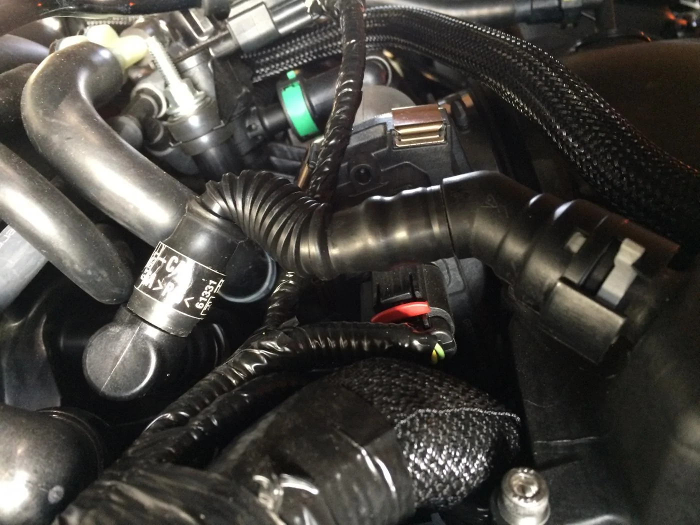

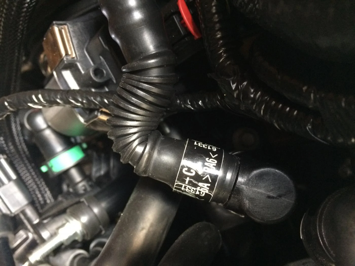

That looks great. Can you get the part number off the small hose; I'd like to start there.
It is the same hose the air/oil separator comes with. Simply take the corrugated hose and reverse it; if you install it as per the instructions, you have that ugly bend in the hose. Simply switch the hose around opposite of the instructions and it fits much better IMO, identical to the picture above. No need to buy any other parts :thumbsup:

Thanks so much! I just went out and reversed the hose. Perfect - no kink/crimp in the hose. If you make you way to Maine, look me up. I've got a beer/soda/coffee for ya.
