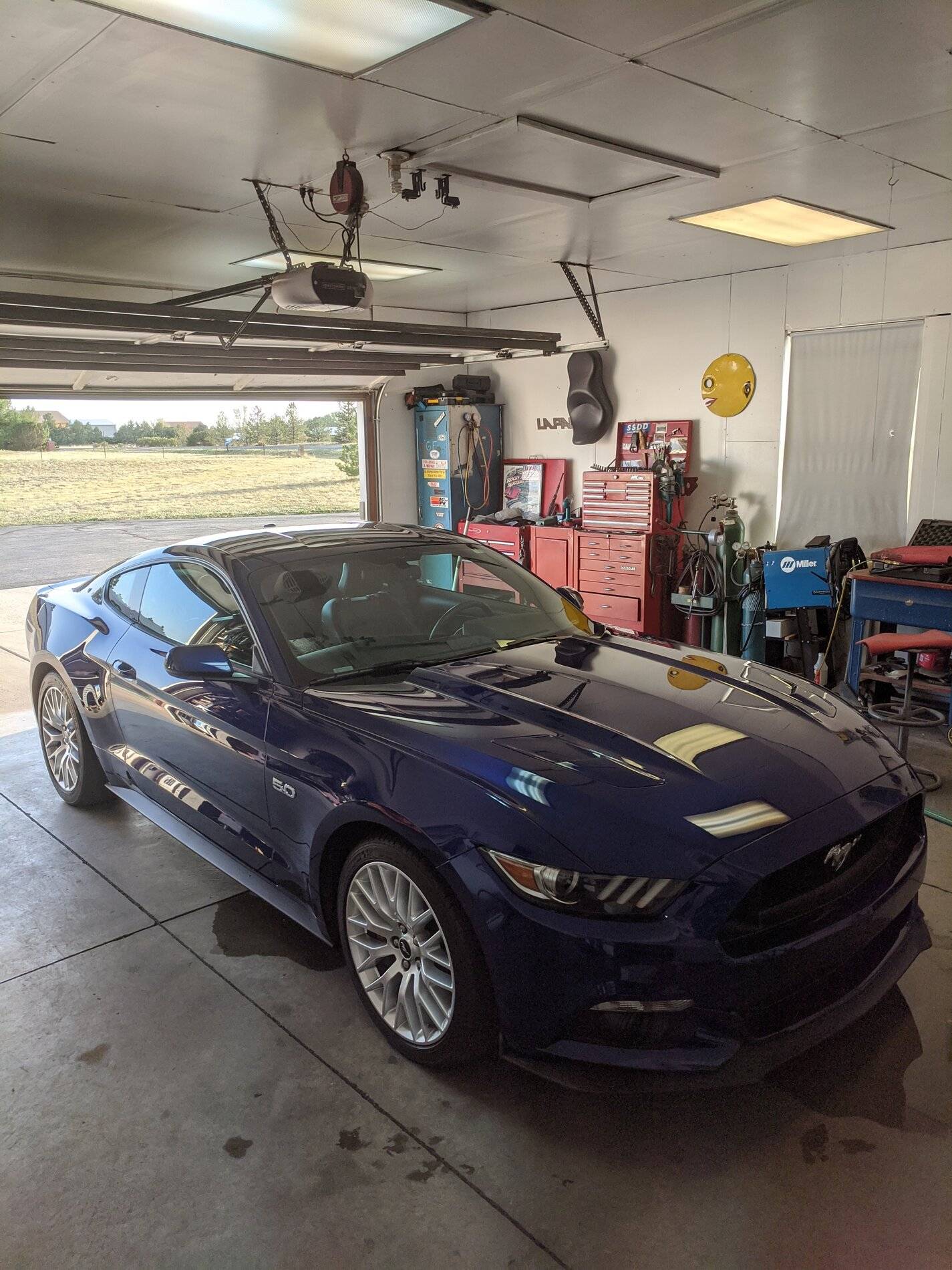

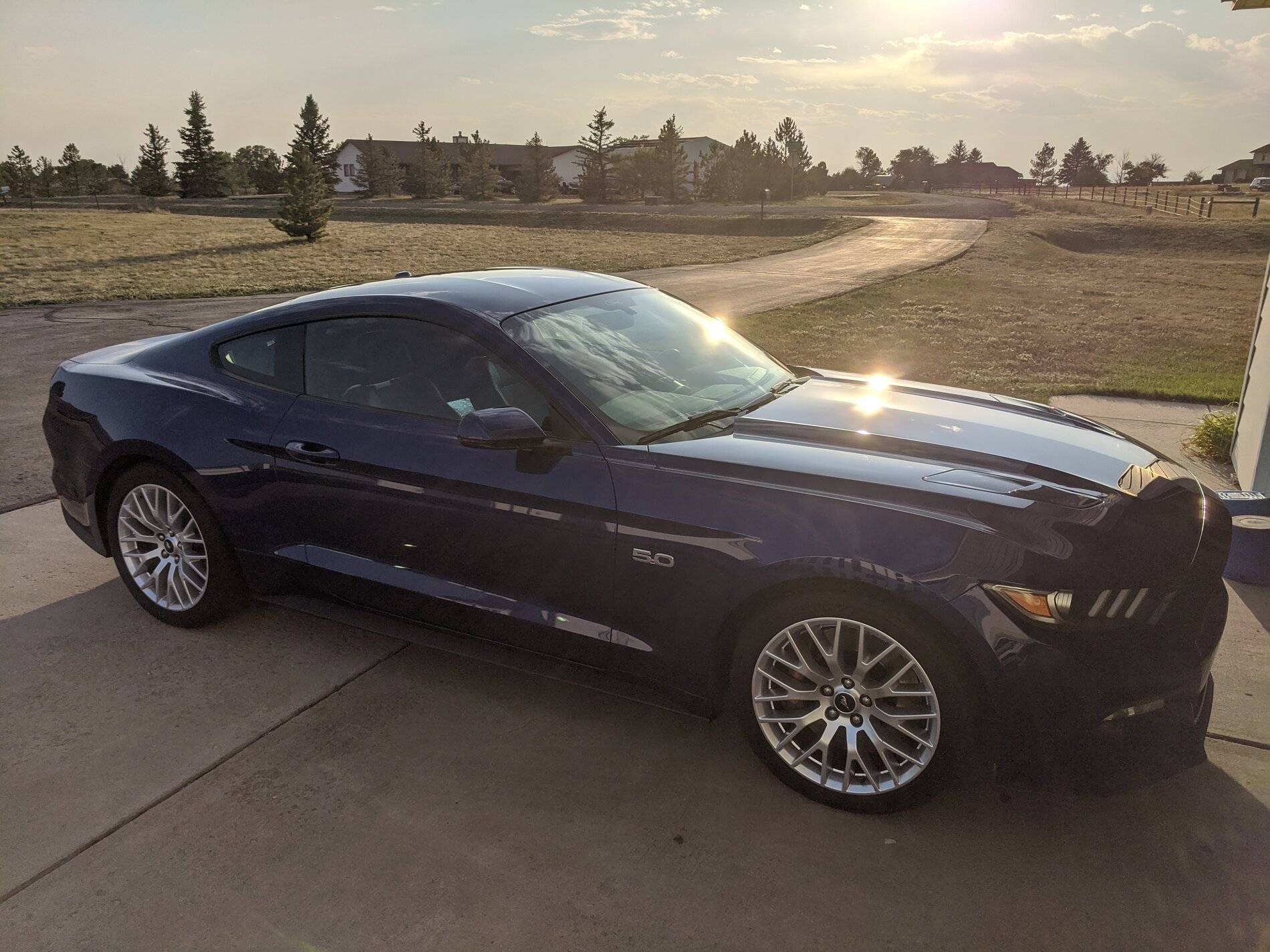

I've tried so many it's kinda embarrassing. Most are not much different from each other to be frank. I've also seen reviews from Apex, Forensic Detailing, and Chicago Auto Pros, Pan The Organizer, amongst others, and usually my results are closest to Forensic Detailing. I'm always on opposite ends of the spectrum from Apex so I don't watch him anymore. Not saying it's a bad channel, just saying I disagree with him a bit.
All that said, my top two compounds right now are good ol' Megs M105, and Rupes DA Coarse Compound. M105 dusts like crazy where Rupes doesn't, but nothing I've found deminishes (breaks down) like M105 either. It's old school, but it works. The Rupes is much easier to work with but doesn't break down as good as M105, so you may need to polish twice.
My top two polishes right now are Meg's Ultimate Polish (not M205, rather the consumer grade polish). And Rupes DA Fine Polishing Compound. Meg's Ultimate Polish is nearly the same formula as M205 but with more oils to cut down on dusting - which makes it more consumer friendly. The Rupes polish is a bitch to work with, but it jewels the paint like crazy. The pictures are of my car using M105 to correct and Rupes Fine to polish.

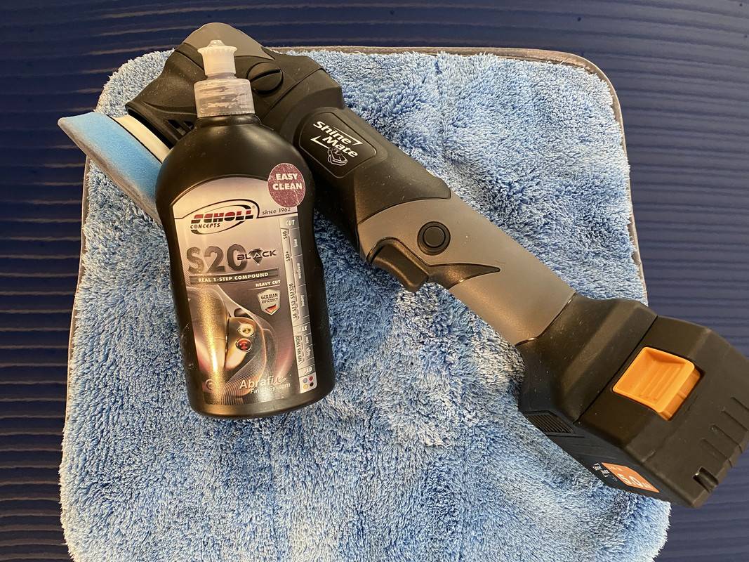

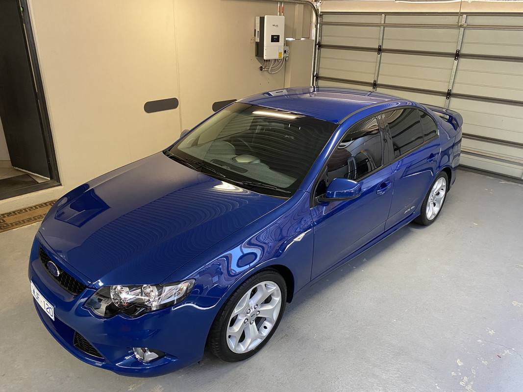

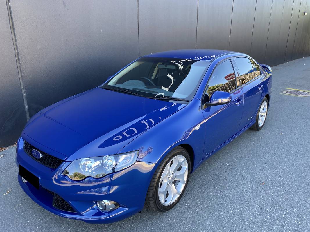

I have used Menzerna, Meguiar's, CarPro, Auto Glym and Zaino polishes over the years.
I have just finished using Scholl S20 Black on my blue Falcon earlier this week.
https://www.schollconcepts.com/en/shop/premium-rubbing-compounds/s20black-compound
Scholl S20 is a one step compound that produces minimal dust and wipes off easily. I keep coming back to this product because it is super forgiving to use and gives excellent results.
I would love to try Sonax Perfect Finish but it is extremely expensive here in Australia.
