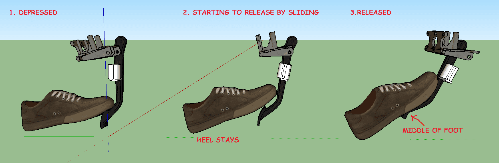

I think what happens is I keep my heel on the ground as I release the clutch, it slides along my foot, then when the clutch is up, it is under the middle of my foot. Then I take my foot off it by lifting it by 1-2 inches that causes by foot to touch the metal bar with the grease on it. This movement was my habit for many years and it always worked.

Thats how I use the clutch also. Heel is always on contact with the floor.
Gets kinda annoying when its wet though, makes squeaky sounds when im sliding the clutch off my shoes.
Also, excellent diagram. 10/10 would recommend.

I move it to the foot rest, by lifting it up a little bit. Otherwise I would have to slide my heel on the floor towards me. Keeping foot on clutch is probably not desirable for wear of the clutch mechanism inside.
That spring just reduces clearance and demands unnecessary precision. Other brands put the spring out of the way.
As I mentioned some people press the clutch with almost straight leg, that is unnecessarily more torque and struggle for the legs. Some other people press the clutch with the heel in the air, that reduces foot positioning accuracy.

If you use your whole leg, then its a 3 axis motion control, that is less accurate by about x^3, compared to a 1 axis motion control when only moving my foot around my heel's axis. Clutch bite requires precision. Its harder to control it with 3 axis. Especially if the road is bumpy, the weight of your whole leg is propelled out of the intended trajectory. Heel on the floor during the clutch bite engage is more solid. Thats why i do it this way.

I disagree. The clutch probably requires the least amount of accuracy of the 3 (especially once you've started moving). Throttle requires accuracy and your heel on the floor. Notice the throttle pedal has very little travel and a surface more conducive to a slip plane between your foot.
Anyway it's a "different strokes" thing. I just don't think it's a method the designers anticipated and I don't think you can fault them for designing to the way 95% of users will use the feature.
That said, I do like your solution. The installation is pretty clean and should solve your issue.

Just tried the heel on the floor method in my focus today (mustang is parked until this snow is gone). I could only slip my foot on the pedal releasing the clutch. The rubber makes it difficult to do this when when pressing the clutch.

I also only slide it for releasing it. For pressing it down better to do it will full leg, as it is faster and does not need accuracy.
