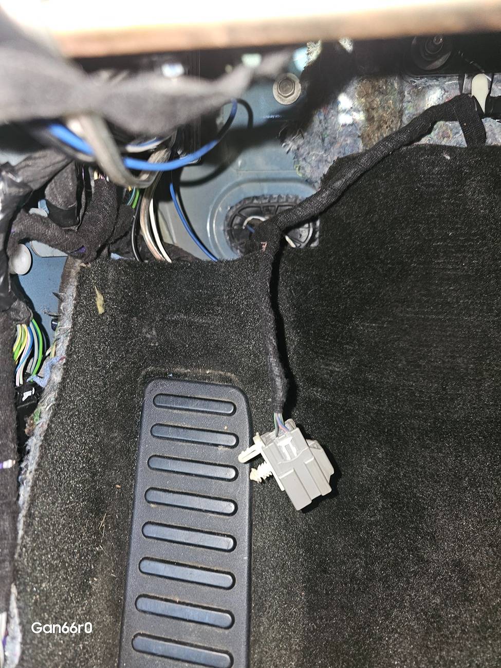

Please someone help me haha. This is coming in from the firewall on the drivers side with a bunch of other wires and then it branches off. 2017 mustabg GT premuim. Not sure what this wire goes to. I had to take my enire dash out to do some welding on the vehicle and I got everything back together and in good but just this one plug I cannot find a connector for it idk where it could possibly go. Any suggestions? Any wiring diagrams? Hell can someone look on there stang and see where it's going?
Thats550
Jul 17, 2023
98
US
2017 mustang GT
This is what it looks like

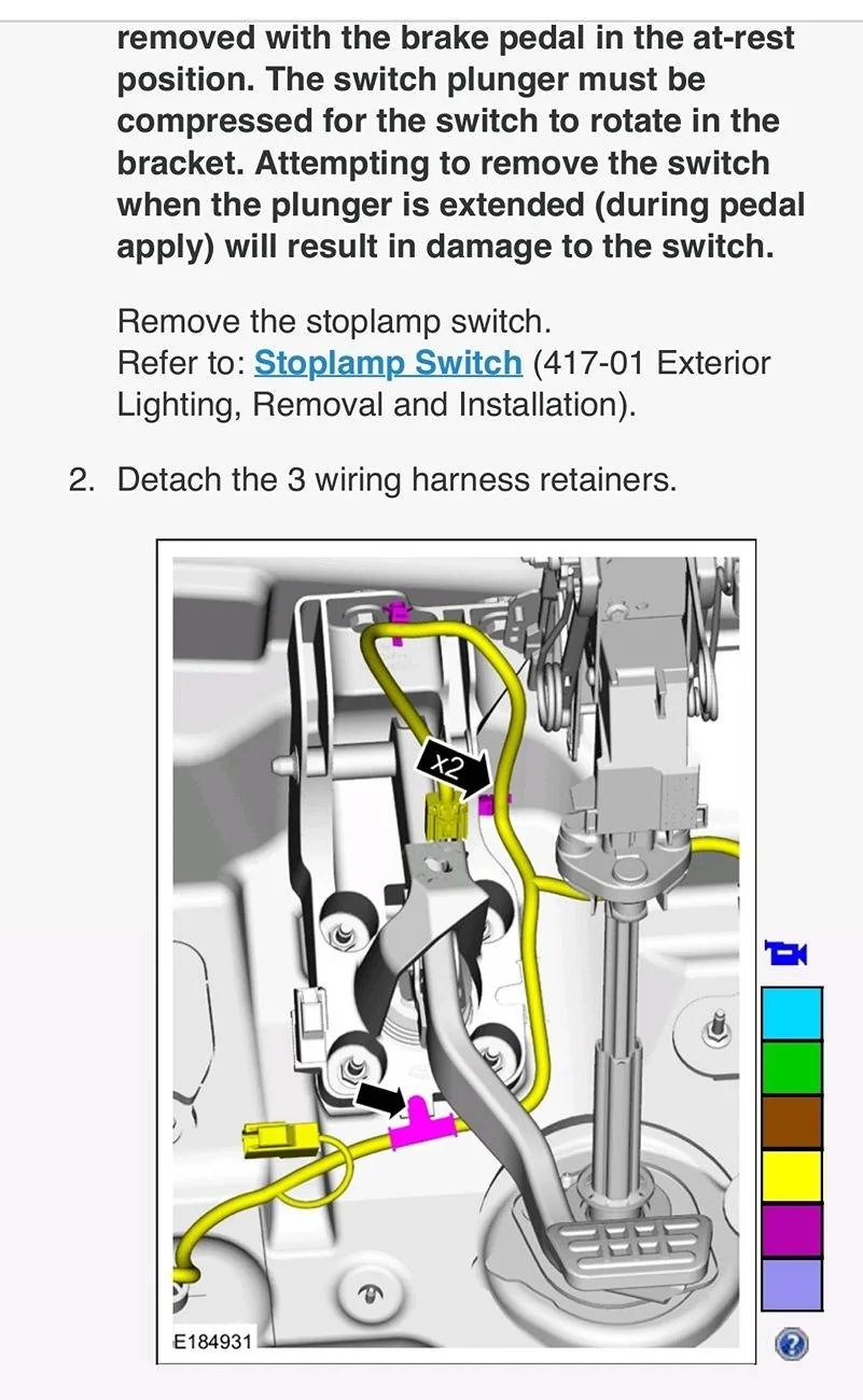

That is part of the pedal assembly. Connects to clutch or brake pedal lead. It attaches to the bottom of the pedal assembly.
Pete96
Apr 11, 2025
Augusta, GA
Greg
2017 Mustang GT Premium
It's the connector at the bottom with the black arrow.
Thats550
Jul 17, 2023
98
US
2017 mustang GT
So I do have this wire connected. It comes out of firewall branches off to the unknown plug then runs up and branches off to both the gas and brake pedal. I have both of them plugged in. And there's still this connector hanging. I don't see any other plugs on either pedal assembly or in the harness itself
Thats550
Jul 17, 2023
98
US
2017 mustang GT
Also the wire is only like 6 or so inches out of the firewall it can reach the brake pedal and obd area but not reach the gas pedal

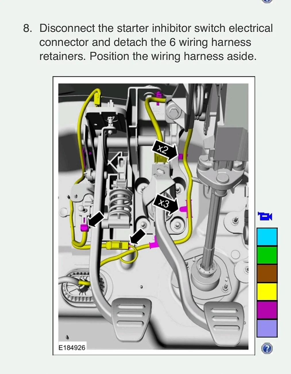

Pete96
Apr 11, 2025
Augusta, GA
Greg
Didn't realize you had an AT. Here's a picture the that guide. It looks like it doesn't get hooked to anything.
Thats550
Jul 17, 2023
98
US
2017 mustang GT
Oh wow thats awesome. Thanks. I feel much better now like I'm not forgetting something. Thanks again !!
