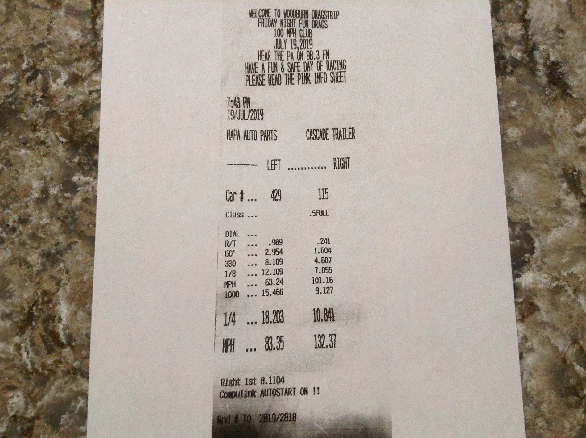

Your slip looks dead on my 14 GT slips with mine not spinning and leaving on 1200RPM foot brake and matting it.. I say retune. Whipple is laying back on their tune, and that is fine because they wish to be overly safe. A good tuner will still be safe but not overly safe. I am also assuming this on a 3.15 gear. If you were spinning then you still have more left in it and a 1.60 spinning tells you you just need to tweak on your suspension setup a bit more. Knock that 60 down to a 1.50 and your running 10.6X IMHO on this tune.
A transbrake would wake the car up if you wish to go that route. Then you'll leap off the line after you get it hooking.

With the stock whipple tune, did you go into the flare/guardian features and turn all the extra nannies off? I went from 710 to 786 back to back runs with just turning the guardian features off and using HP tuners to change knock monitoring from global to per cylinder. My best time with that tune was a 10.7 at 131 4120lbs race weight 1.61 60ft mt82 . I'm running the exact same ET Street R radial with 17 psi and leaving off the 2 step at 3500. 93 octane and Lucas oil octane booster.

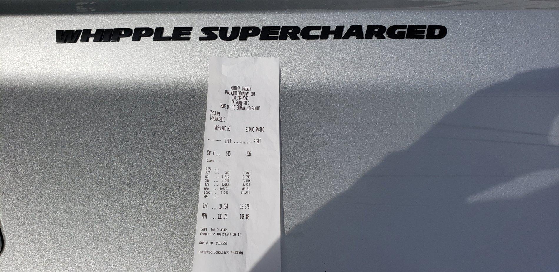

Time slip
Not sure what DA was m,but my IAT from the dash were at 151 before I even did burnout.

You would think it would mph better with 786 to the wheels.
The heat was killing me...I was losing 4 to 5 degrees of timing. I don't have a post blower IAT set up yet as the whipple tune requires the pre blower IAT. IAT pre blower were 151 before I even did burnout , so I can only imagine what the actual IAT were.
