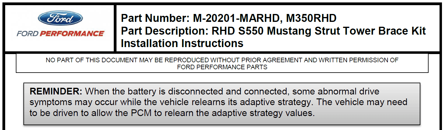

I think the fuel learning process can be speeded up by doing a KAM reset (for those with OBD service tools) or by disconnecting the battery for 20 mins or more
I've done it three times, but not purposely (battery disconnected for strut brace mods / strut brace fitment / making the airbags safe for seat removal).
The only pain in the arse is that the battery disconnection method erases the mymode settings - not sure if that happens using the OBD tool reset option ?
Ford provides this waning after a reset :
