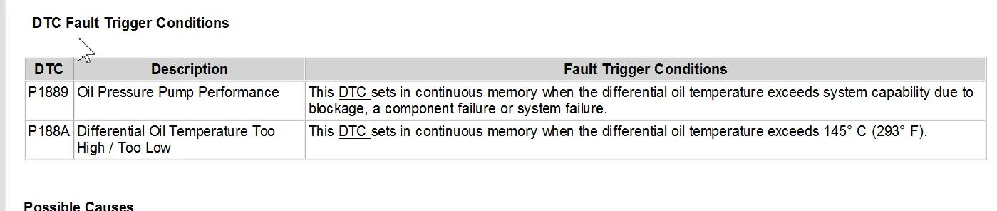

Found this...
Thanks John. I saw that too. That is the DTC temp. I know my diff pump is working because I hear that it is on leaving the track, but I never noted the temp which triggers it. I was out pushing the car to get it to come on today, but I guess street driving doesn't get it done. Thanks for checking.

I believe the transmission pump is circulating fluid anytime the clutch pedal is fully released. The differential works off a temperature sensor. Unless your temp reaches a very high number and doesn't work (293F), you wouldn't know until a DTC is thrown for overtemp. That was one of the reasons I asked the question so that I would know at what point the PCM triggers the pump to come on. I tried to get it going today and couldn't get it to trigger with street driving.
