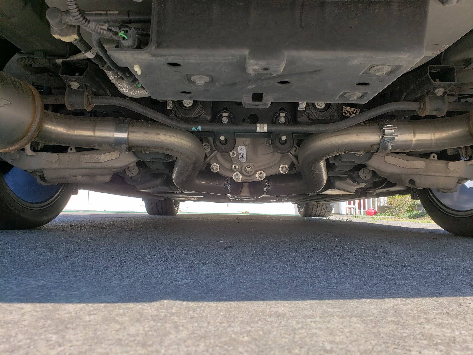

I bought an MBRP Race exhaust to have something to do during this 'quarantine'. Me and my pops (neither of us done this before) installed it in his driveway this past weekend on some ramps and jackstands.
The tips seemed aligned fine, but once we tightened everything up, they both seemed low and one touched the bumper. The tailpipes kind of looked low too.
We tried multiple times to unclamp and twist the tailpipes, but each time one of the tips touched a bumper, and they still looked low. Everything is a little difficult laying on your back under the car.
Is there something I'm missing here? Or at this point should I just take it to a shop and have them fix our attempt? I've been driving around without the tips on, but took some pictures with the tips on so y'all can see.

You can't align the tips by twisting the pipes or playing with the tips. You have to adjust the hangers underneath. Since I'm assuming you're still in the 17 with single tips, you should just be able to adjust the hanger by the mufflers and leave the middle ones alone.
Best way I found to do it was measure how far you need to adjust the tips accurately. Then you have to take the exhaust off, and using a long pipe or something, slowly bend the exhaust hanger in the proper direction to adjust the tip. So if you need tip down, you move it up. Tip up, move it down that distance. And try to measure how far you're adjusting the hanger by where it hangs in the grommet.
I did my dual-tipped '18 this way when I installed my H-Pipe and when I again removed the exhaust to paint the mufflers.

I see clamps there before the mid-way hangers like an axle-back. I'm guessing it came in pieces and you had to assemble it as you went. Before bending anything, remember the hangers sit in grommets so if there is pressure pushing the tips in a certain direction, you'll want to correct that first. You will likely want to start at those clamps visible in the last 2 pictures. I'd start by getting those loose so the muffler portion will move.
You should be able to take care of any east-west orientation issues by tapping pipe behind the muffler with a mallet in the direction you want to go. Once the east-west is taken care of, that shouldn't be an issue once it's clamped down. As far as north/south, try moving the tips up/down with the clamp loose and see how it goes. You can use pieces of wood or something to support both the tip and try putting a piece under the mid-pipe portion just after the clamp. You want to be able to adjust the muffler portion without moving the whole shebang.
Then retighten firmly enough to hold it and check how things look. It's probably best if the tips look a touch high as they'll settle in over time. Hopefully this works and if you get things looking good, make sure everything gets snugged down really well to keep things in place.

I would guess you've got something upside down or swapped L-R.

As mentioned above you might have some thing installed backasswords'
I did an X pipe, when I began fitting it up. I discovered there was a top and bottom side. That only became visible when installing.
One point I'd like make about the clamps. If over tighten and it sounds like you did. Will stretch and or deform the pipe too pipe connections,. That happens you will never get things to stay in place, torque is about 20ftlbs for clamps.
This sounds like what you did with the little thingy . Take it to a shop have it welded. That's how you fix a thingy (sound like a girl talking) ..

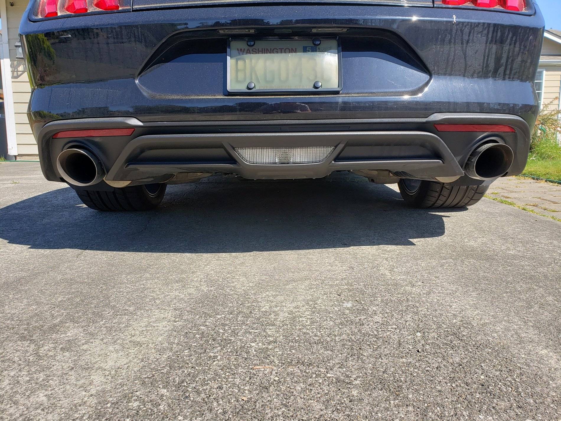

It looks like you have the pipes coming off the y-pipe turned down a little low in the back. I just installed the Street exhaust the other day and everything lined up almost perfectly for me. Here are some pictures of how mine is adjusted.

Even though I think im taking it to a shop, I tried to get a similar picture to yours (using an iphone 11 main camera) and I can't seem to 100% line it up properly but its close lol. I'm just not 100% sure which part is wrong. Sometimes when I look at the pictures it looks fine, other times low, etc

You definitely have your Y-pipe upside down or your muffler pipes switched L-R (or both).

For anyone on wondering, I just took it to a local shop. Readjusted everything and he put a small weld on the tip to the tailpipe, but he said the other connections most likely would be fine and come back if i need anything. Only charged 25 bucks and was a nice dude so I figured whatever I'll go back if I have problems.
