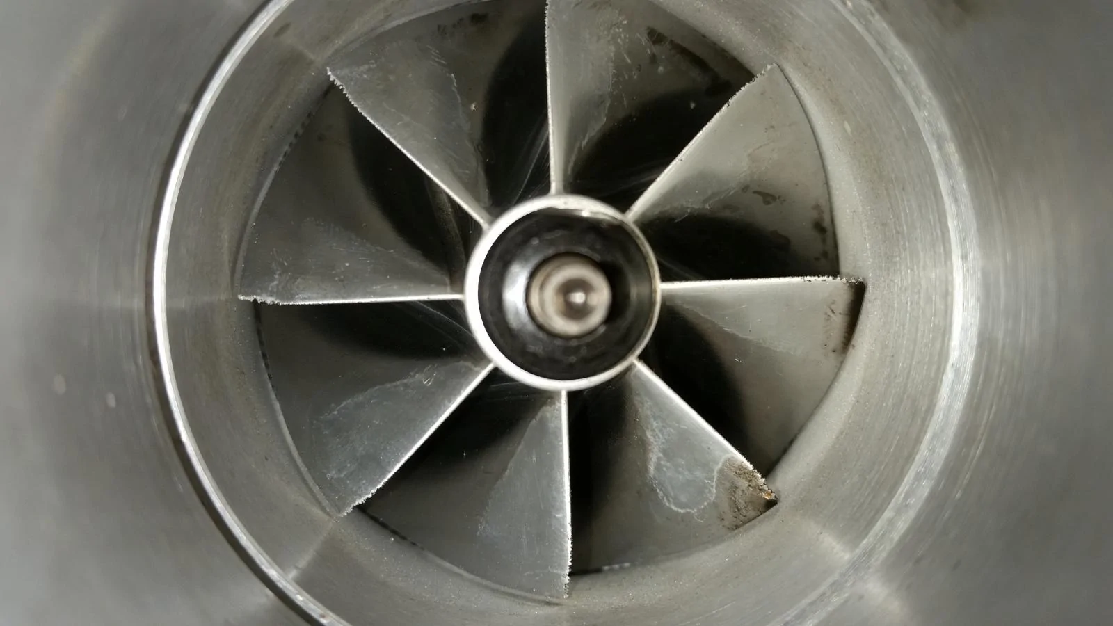

Damaged turbo fins and scored cylinders may point to the engine ingesting something through the intake. In retrospect, which side of the turbo were the fins showing burring? Intake or Exhaust side?

Here a pic of what they look like

What happened to the turbo? Did an intake screw go into it or something, I vaguely remember a thread where that happened

That looks no bueno. It can get way way worse than that though. Wheels can get out of balance when blades get chopped up like that and then the bearings can go. No clue what your intake was eating. What brand intake are you running?
MAPerformance it was a beautiful intake very well made id be suprised if it had something to do with it but i doubt it

The MAP intake is quality I don't doubt that. But I would at least take the filter off and inspect it to see if any plastic or rubber has broken off. That tends to happen once in a while with turbo's and it would be no fault of MAPerformance.
