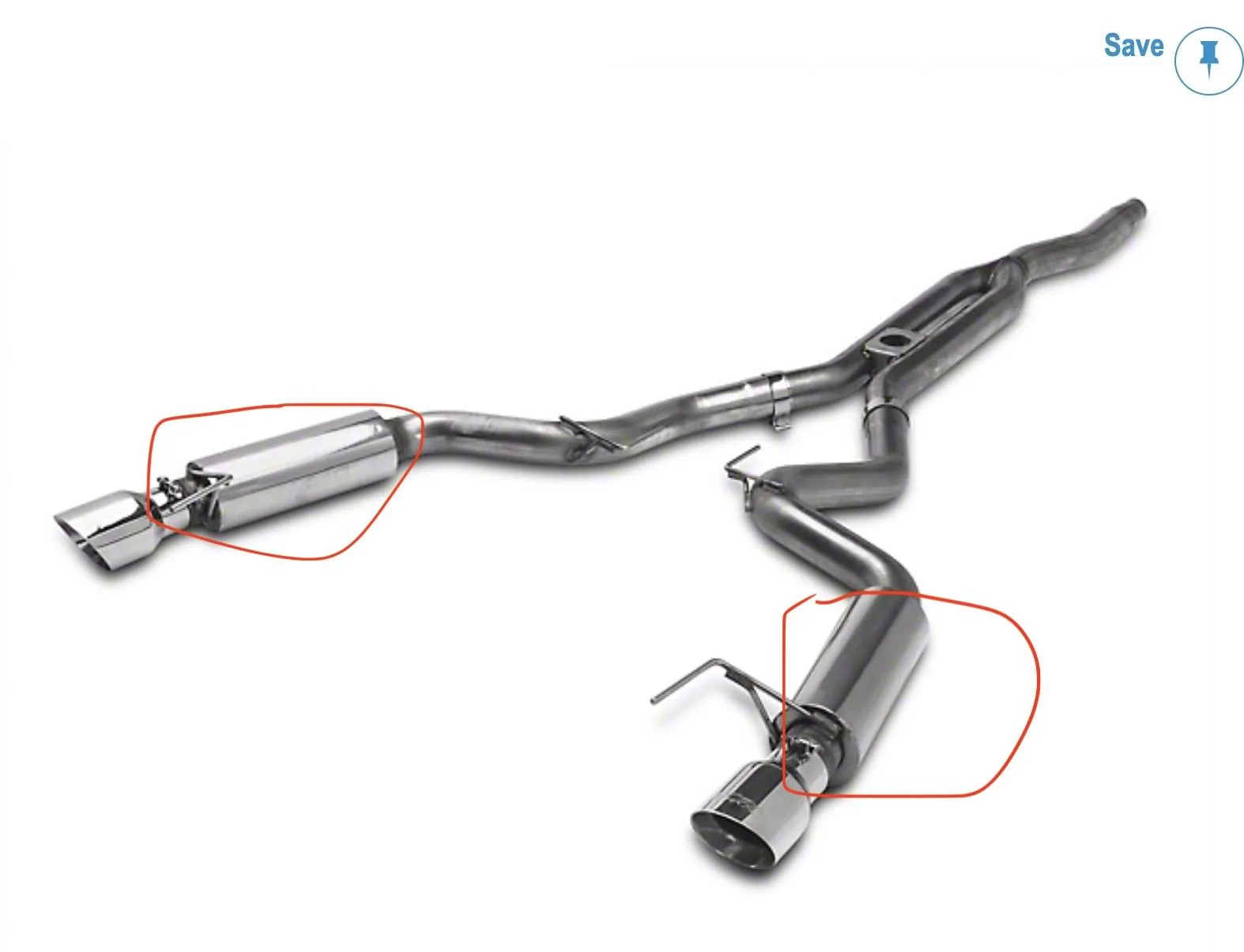

I have the MBRP race catback exhaust, and was wondering if I straight piped these 2 mufflers would that affect emissions/require a tune and pass inspection? Love the rumbly sound as is but seeing if I could wake it up even more since I'm not going with a downpipe for now. Also would it trigger a CEL since I read the backpressure changes could?

While I can't say for sure, I don't think it would impact your emissions. My understanding is limited, but I do think it'll negatively impact the back pressure these cars require, idk if it would trigger a CEL though. So, that may make a tune required regardless if you went that route. That said, given the design of the mbrp resonators, I'd be shocked if you liked the sound without them more. There's a good chance you'd lose the rumbly note you mentioned with very little impact to the volume, given what resonators are designed to do.

First off no engine requires back pressure. Ok someone is going to point out 2 strokes, but they only like it for starting. Once running you want a good scavenging expansion pipe.
Your car's ECU doesn't care what happens after the cat, neither does the emissions police. The noise police might be different.
It will probably sound like crap so make sure you can put them back if you don't like it. I do believe the MBRP race mufflers are straight through.

MBRP race mufflers are just a glass pack which is straight thru with no baffles at all just tiny louvers to help direct some of the flow/noise into the packing. No effect on emissions testing or backpressure/engine tuning will be encountered. Exhaust noise/note may or may not be improved to your liking.
I have that same cat back on my car and like the sound very well.
Backpressure is a useful tuning tool for both 4 and 2 stroke engines and is a must for two strokes to run properly which is why they have expansion chambers to create backpressure/reversion in exhaust to keep fuel/air charge in cylinder for combustion. 4 stroke only benefits from 0 backpressure if operated at WOT constantly for drag racing.
