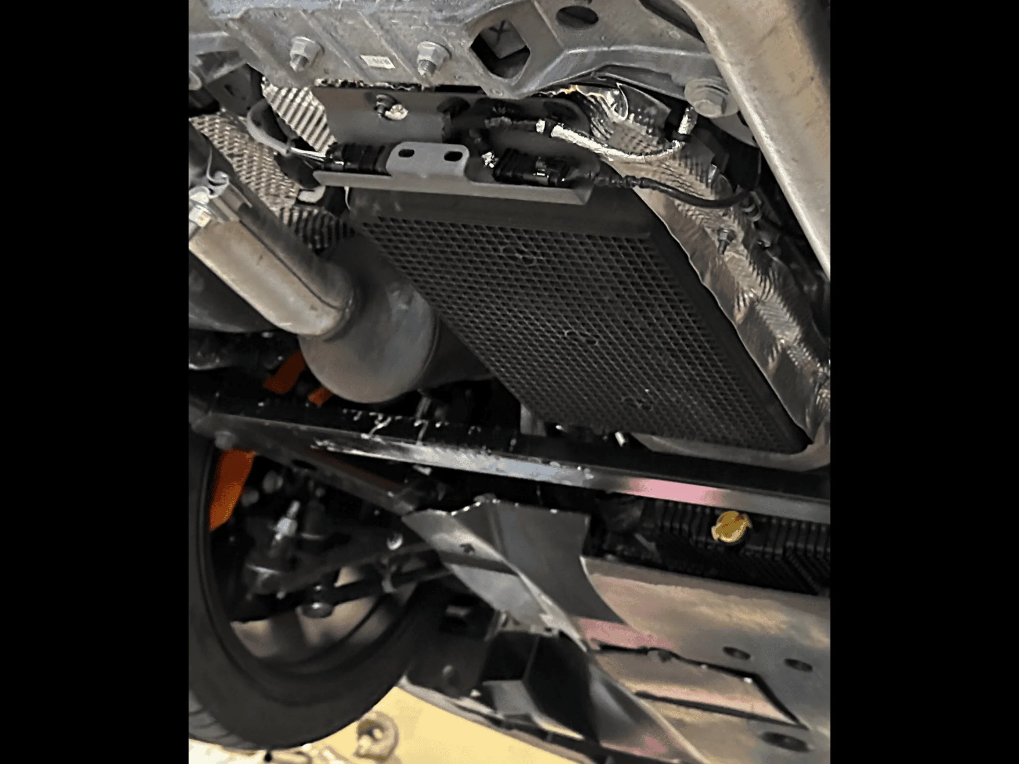

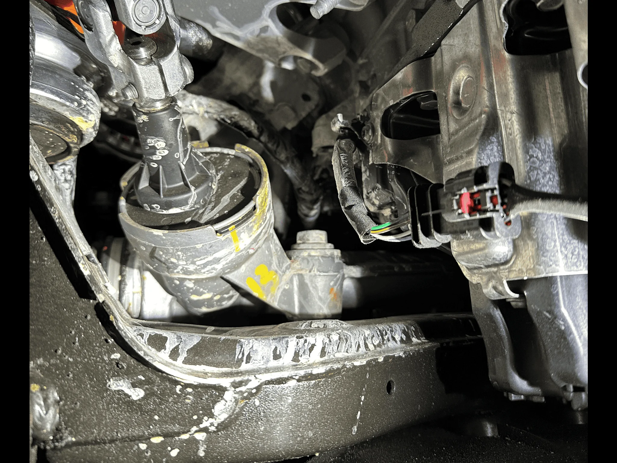

Had three track days with the car and now it was time for an oil change. While checking things out underneath we found this white stuff splattered all over. The kid or technician thinks it was coolant. He says it dries white, but I’m not sure. Maybe I hit something. The car has 2,900 miles on it. Any thoughts? Thanks!

I think it's coolant. When I swapped my OEM 180° thermostat back in I spilled a bunch of coolant. When it dried, that's what it looked like.

Taste it.. if its sweet it's coolant lol. Hows your battery look?

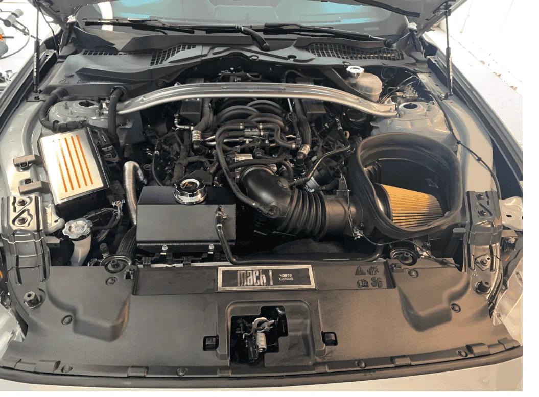

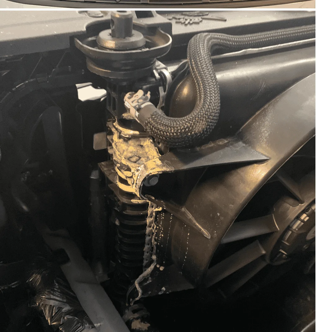

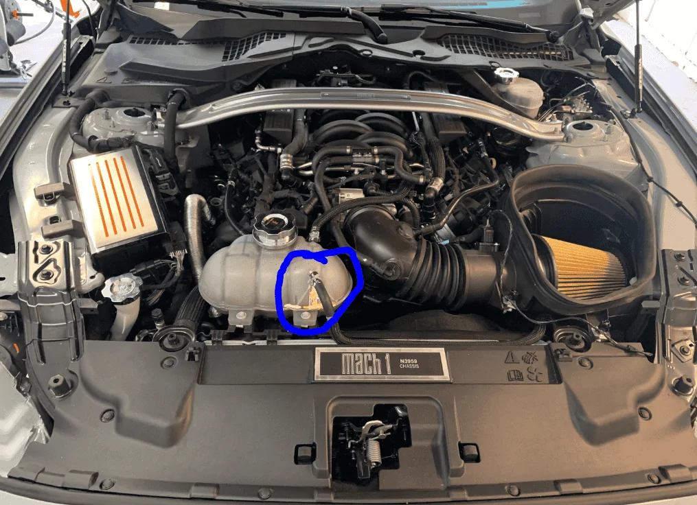

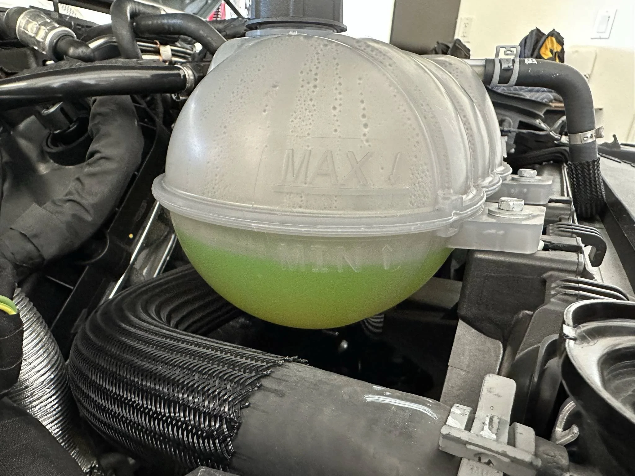

yep that's coolant, I am sure you smell sweetness. My upper reservoir hose was leaking on both ends I replaced that junk. Its perfect now, look for one of the hoses leaking. Check out how mine was leaking.
Installed Mishimoto upper hose.

Battery is fine. Thank you all for your comments. I will be taking it to the dealer to see where the leak is coming from.
Hope they fix it should be easy fix. I showed my leak they said it was "overfilled" LOL. yeah right! So I said F them I bought the hose and replaced and put replaced the ugly reservoir lol .
I bet you one of the hoses is leaking around that area, my hose or clamp was defective from factory.

Maybe fill the tank before goin to the dealer, you are missing a good liter of fluid there.
