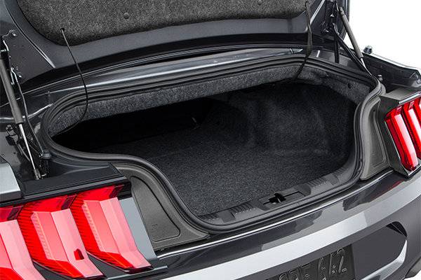

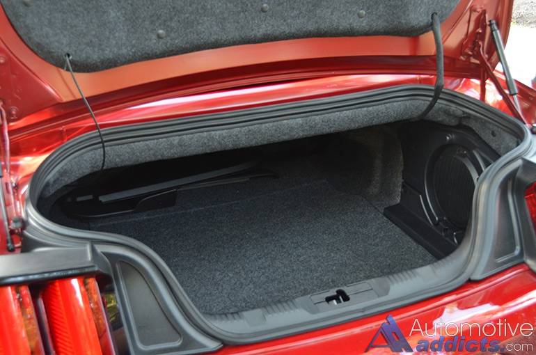

Guess you bought used, right? Only the right loom comes from the factory. Probably to add a rear camera, or for a 3rd brake light. But it was a crappy job for sure :devil:.

Definitely ford part. Uk car and seen loads of pictures with the same cable.

I think you’ll find that is the cable that goes to the emergency trunk release.

Yep, trunk release cable from the dash.

Man, glad mine is electric. That cable looks like an afterthought... but not surprised coming from Ford. Ha ha.

As I said in my earlier post, it’s the cable for the emergency release in the trunk, has nothing to do with the interior button, which is electric.

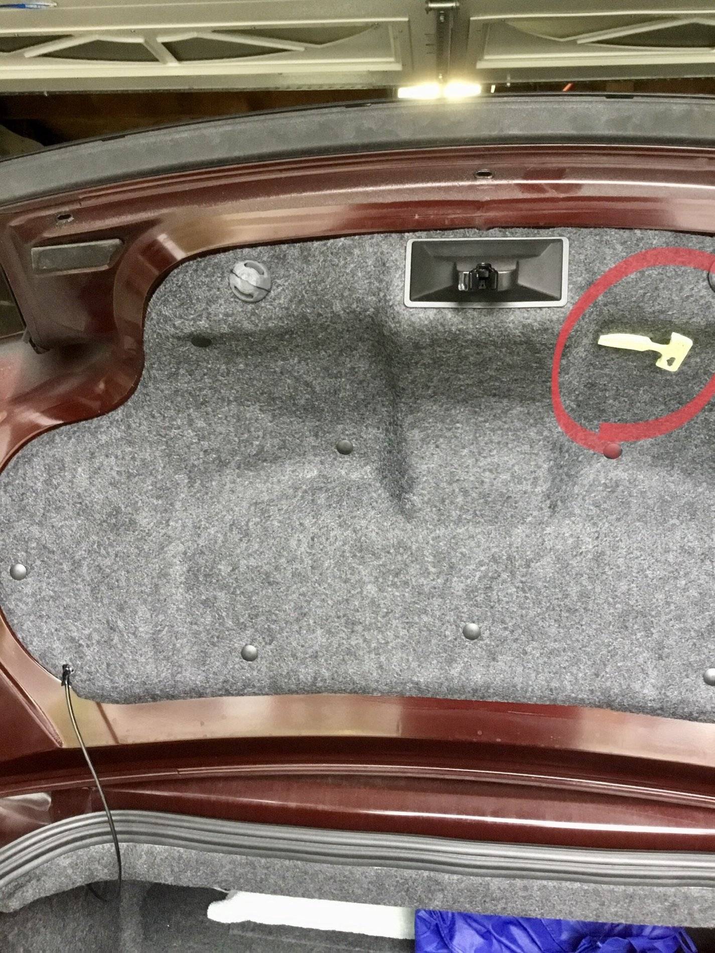

You don't need one, since you can pull the rear seats down, and access the emergency pull handle from there.
All I can tell you is my car has the same trunk emergency release handle, and does NOT have that ugly cable :D. The emergency release handle has a wire directly attached to the latch mechanism, a few inches away. Pop your trunk cover off, and see what is happening there.
That cable could be a redundant emergency release cable on older cars (before the emergency release inside the trunk was mandated), but you'd have to follow it and see where it leads. Good luck.
