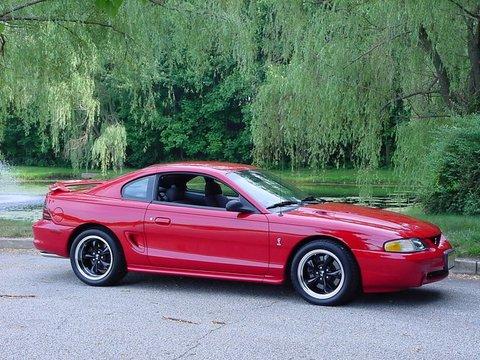

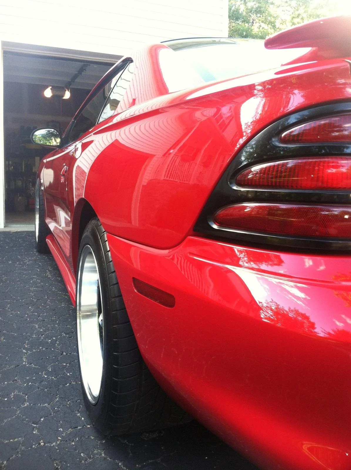

This is my 94 Cobra... if I didn’t tell ya - yes that is original Ford paint and the Cobra was always a daily driver through all East Coast weather conditions, never garaged when in it was a daily driver AND it has over 144k mikes on it - you wouldn’t believe it from these pics (or in person). This car I’ve always used the same tools, products and methods noted above when detailing....
