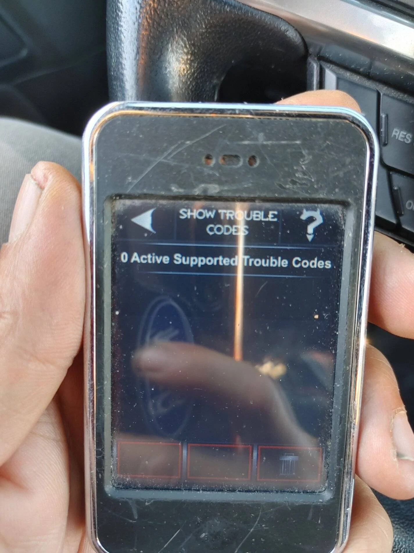

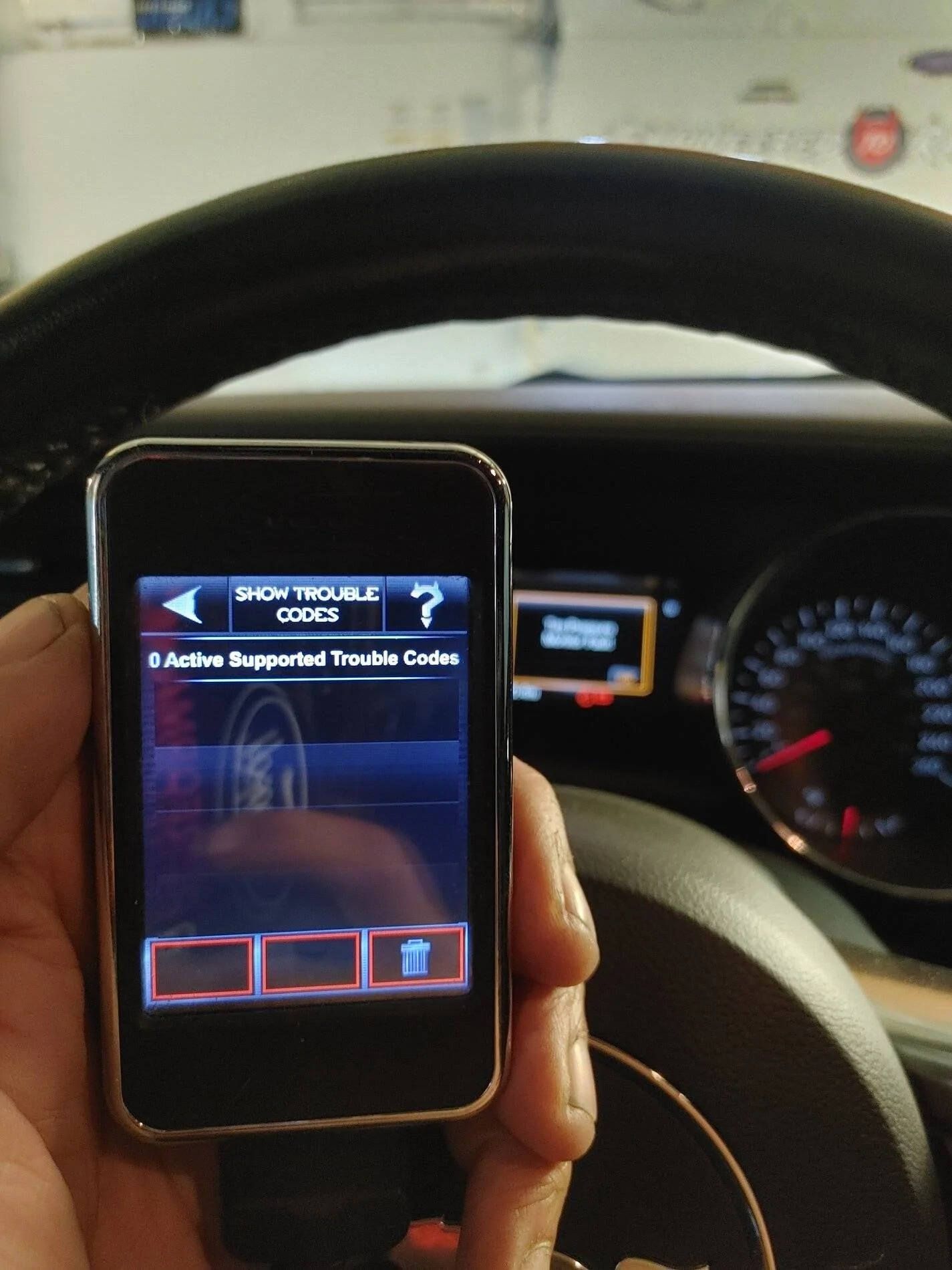

Ok just for shits & giggles. I added a 325/45R17 (28") tire size through my handheld. Went to check the active codes. And what do you know ? U0422 popped up. Couldn't clear it. Went to the stock tire size of 235/50R18 (27.3") tire size, checked active codes, boom, gone. W.T.F. haha. The tried a 275/40R19 (27.5"), PP1 size (closer to my MT 28x11.5x17 tires). Same, no codes.
So I left that value. Went to go compare speeds with GPS. After a few miles 30 mph indicated, 30 mph GPS, 60 mph indicated, 60 mph GPS, 120 mph indicated, 120 mph GPS. Looks like it indeed, self corrects, and that U0422 code is directly related to the tires.
