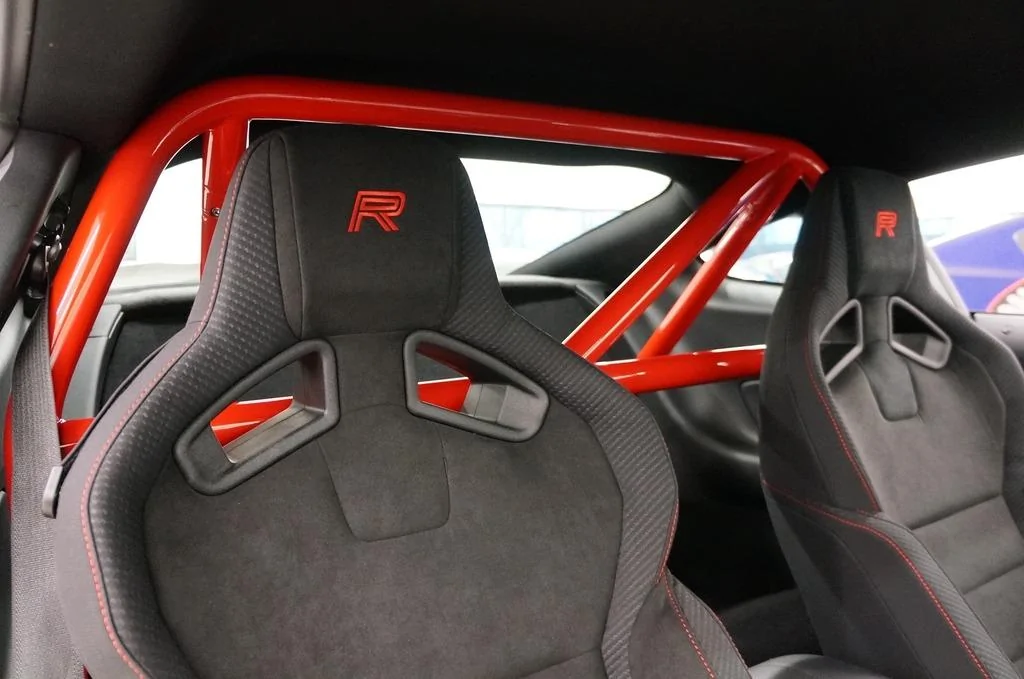

To clarify, I TQ'd the "B Pillar" bolts to 28ftlbs.
The rear bars, I torqued the (8) main bolts to 45ftlbs.

I installed mine as well.
As for the bolts you mention, I torqued them to 335in/lbs. I also installed washers, as pictured below, because I wanted to ensure the clamping force was there, AND I wanted proper TQ to be met with those bolts.
I am very happy with this piece. It fit great.
I definitely had to get creative doing it solo.....fun stuff!

Thanks, I did torque the 10.9 B pillar bolts to 28 ft/lbs. and was thinking mid-high 40s for the rear bolts. You installation looks great and I'm looking forward to buttoning mine up.
