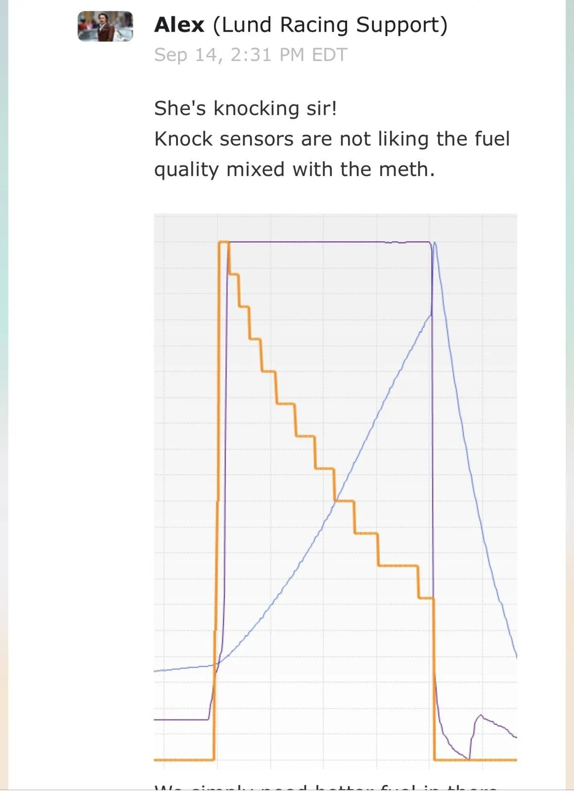

I think without tune, I didn't have time to get a meth tune unfortunately but the meth sprays from 1lb and up. i think i have 18 timing but at this point, I am getting E85 because he said I need to run meth right now with 91 to keep my current tune. I have 91 here only but its not good gas and won't support more boost. Maybe 93 and meth will be better for you? looks like I gotta shell out another 2400 for a fuel pump :headbang:

Something is off, as many with 91 cali gas and 3.65" pulley have made around 650 wheel without meth. What RPM was the pull made to?
Without tune is your answer. I gained +3psi +3* timing with meth over 93. You may be starting out with less on 91, but you can still get the same gains. Retune for more timing and/or increase boost. You can get just as much power out of meth as you can E85 if you spray enough.
That being said E85 has alot of advantages over meth too, so you may want to consider it.
pulled to 7000-7200 rpm. When he got the first log, there was a good amount of knock then after we turned meth to activate at 1lb of boost. once we switched it to activate at 1lb, i ran a lot cleaner and he said it was good. not sure if TT and SC will be the same in comparison? probably doesn't matter if one is TT and one is SC
yah the 91 here in CA isn't really 91 haha in my opinion, the tuner put the most timing and spark to where he thinks it is safe so I didn't wana risk it. Yah I am going to purchase the pump tomorrow and hopefully install next week. If I have to rely on meth or E85, I might as well be on E85. Or both?:question: if possible
"Sensors aren't liking the fuel quality mixed with meth" doesn't make any sense to me. It should like it better than the fuel alone lol, meth can't do anything but help. Maybe you need to spray more. I had to go through a few nozzles to find the right size and insist on Lund (Dakota) increasing timing further. E85 is a safer bet though. Power can still be picked up with meth on top of E85.
Yah I got a devils own nozzel which i will install and hopefully that helps. Ill be running E85 but will have meth spray at certain pound of boost, might as well us it since its the kit is installed already.
