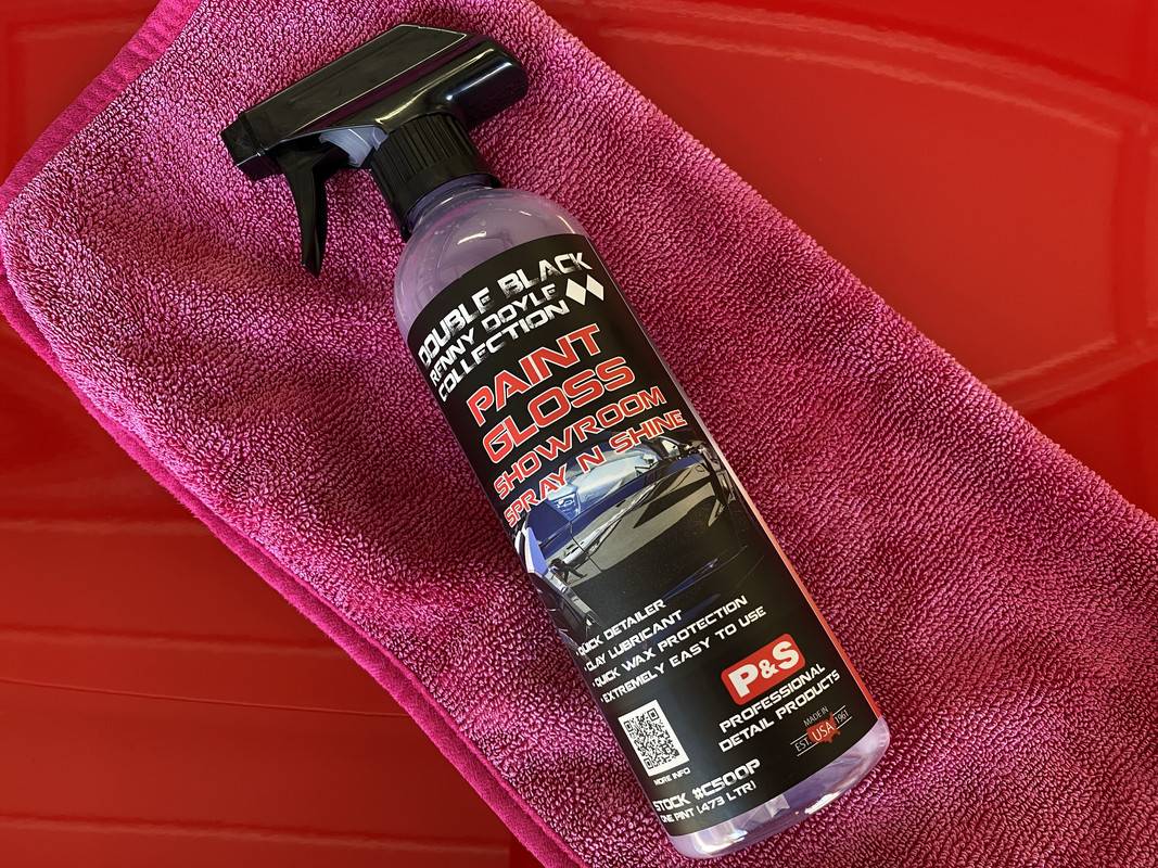

Some products can do this, it's not necessarily "attracting" dust, rather hanging onto it.
P&S Bead Maker is notorious for it, although only noticeable on darker colors. In which case, P&S recommends using a little Paint Gloss to reduce the static after using Bead Maker, in which case you could try using this before a car show. You won't necessarily alter the look or feel of your Polish Angel, rather it just cuts down on the static charge.
P&S Detail Products - Paint Gloss Showroom Spray N Shine | Rag Company – The Rag Company
I may very well try that. I am a big fan of Bead Maker and even bought the Dream Maker which I must say I had the same experience as you have had. Was not overly impressed as my expectations were high and I had decided that I would not use it anymore. In my research I was wondering if you had seen this video before. I have not tried this combo but I had noticed the same static issue with P&S but not to the same degree as the Polish Angel.
According to the video it has "anti-static" properties. I though maybe giving it one more show and playing around with how much I used as a drying agent when I was the car. Also thought about doing the combo and doing another vehicle using it with Beadmaker.
